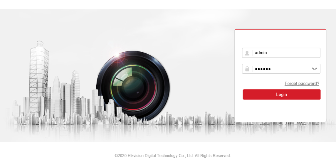

Browse for the device’s IP in the address bar, and then log in to the device using the username and password you gave when first setting it up.​
Once logged in, click on the Configuration tab at the top of the page.​

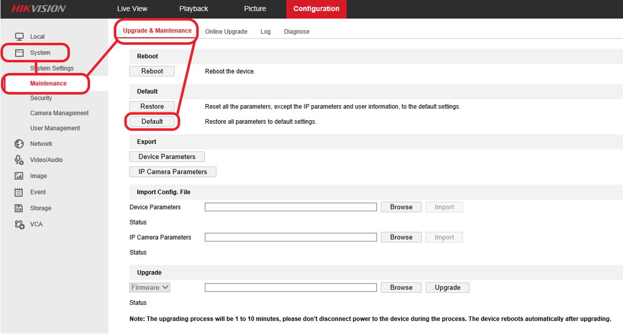

When on the device’s Configuration page, go to:​
System > Maintenance > Upgrade & Maintenance
Click the Default option to reset the device back to its inactive factory state.​
There are a couple of other useful options here:​
Reboot - allows you to remotely force the device to power cycle.​
Restore - will wipe any settings and information on the device, excluding the network settings. This is a less comprehensive reset than the Default option.​

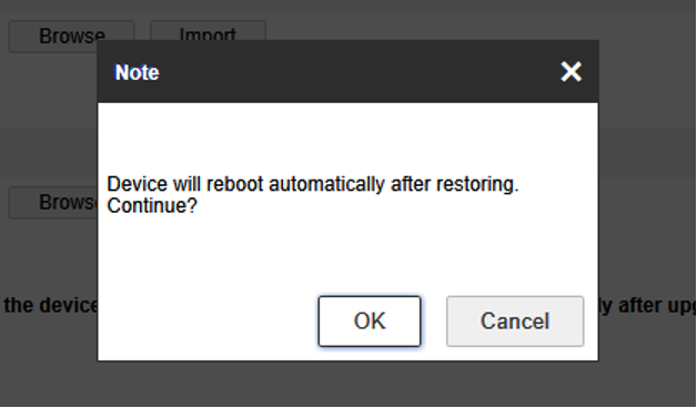

You will see a popup window asking you to confirm that you want to reset the device. Wait while it resets and reboots, the popup will disappear when this is done.​
That’s it! If you want to check that the reset was successful, then open the SADP tool and check that it shows the Status of your device as Inactive.​

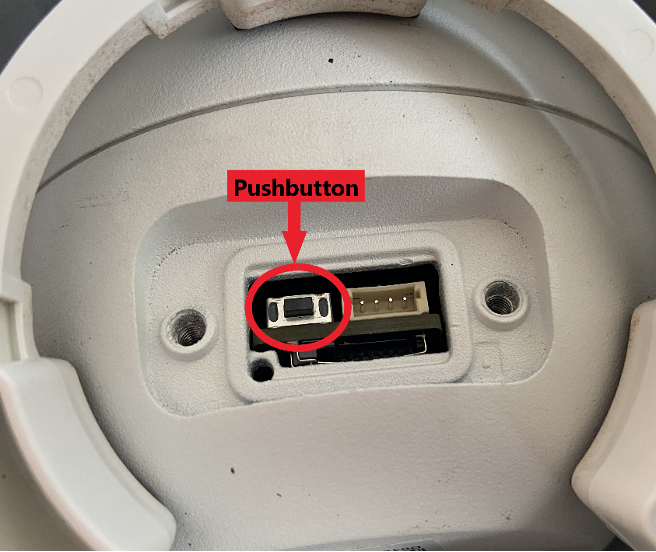

On the majority of Hikvision’s newer camera models, there will be a pushbutton on the camera which will allow to carry out a hard reset without needing to log into it. This is most useful when you have forgotten your password, as it allows you to set a new password on the camera while avoiding much of the faff involved in doing this through the SADP tool.
Step 1:
Find the pushbutton, which is usually found beside the microSD card slot, so you’ll need to remove the microSD card cover by using a Torx screwdriver. The button is normally grey and rectangular, like the one circled below:​
