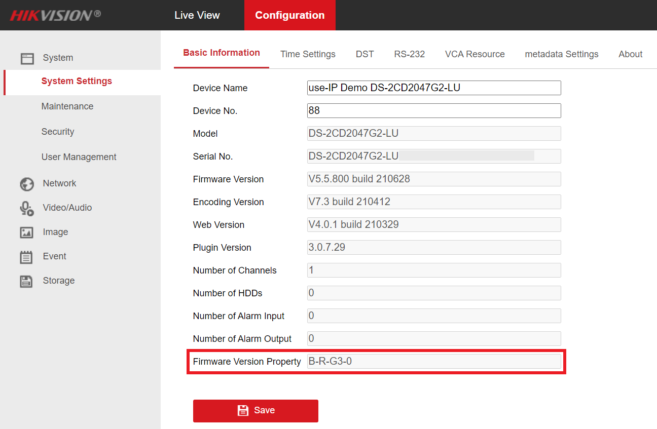

Step 2:
If you have a ColorVu camera from the G3 platform, then make sure you have installed the firmware, version 5.5.800 (build 210628), or later.
If you have one of the G5 models (indicated by a 'C' at the end of the part number), install version 5.7.2 (build 211228).
You can also check your camera's platform when connected to it in a web browser by going to:
Configuration → System→ System Settings → Basic Information
The platform will then be indicated by either a "G3" or "G5" in the "Firmware Version Property" box:
Note - Please see this guide for instructions on how to check and update the firmware on your camera.

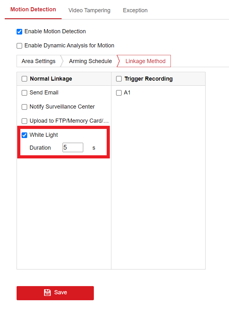

Step 3:
Once you've logged in, navigate to:
Configuration → Event → Basic Event (for motion detection) / Smart Event (all smart event options support this) → Select your preferred event type
Step 4:
Enable and set your event up in the Area Settings and Arming Schedule pages, this guide explains how to set up motion detection, line crossing, and intrusion detection.
Step 5:
Navigate to the "Linkage Method" page, tick the "White Light" box, and set how long that you want it to remain on for on event triggers (in seconds) in the "Duration" box.
Click "Save" once this is done so the settings are kept.
