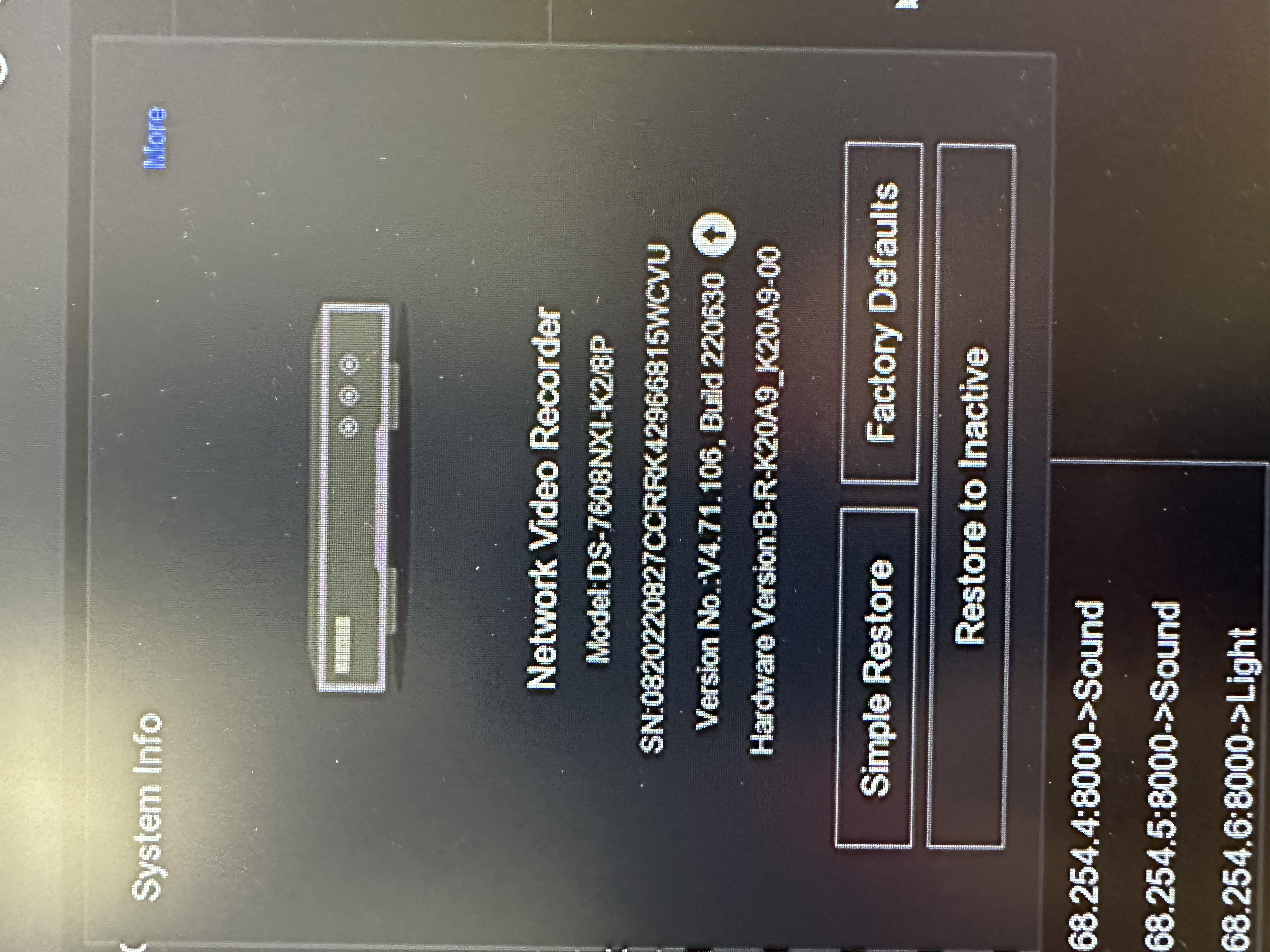

My installer have just installed the Hikvision NVR DS-7608NXI-K2 version V4.71.106 Build 220630 + 3 DS-2CD2543G2-IS + 5 DS-2CD2387G2 cameras. Everything works but he didn't have the time to setup the advanced functions (AcuSense, Strobe light, alarm siren...) or upgrade the firmware of the cameras. Here are the questions:
1) How do you check which firmware is on the cameras with the NVR and how do we upgrade the firmware with the NVR or with the PC or MAC?

1) If you go to the camera menu and scroll to the far right of the camera list the final column should show the current firmware version of the connected cameras. You can update the firmware on the direct monitor by loading the firmware onto a USB stick or you can log in to the NVR with a browser and then use Virtual Host to log in to each camera and update the firmware.
The latest firmware for both the NVR & cameras is below (scroll to the bottom of the linked product pages to find the firmware files):
DS-7608NXI-K2 --- V4.74.017_230418
2543G2 & 2387G2 --- V5.7.13_230504 (both cameras use the same AcuSense/Color Vu camera firmware)

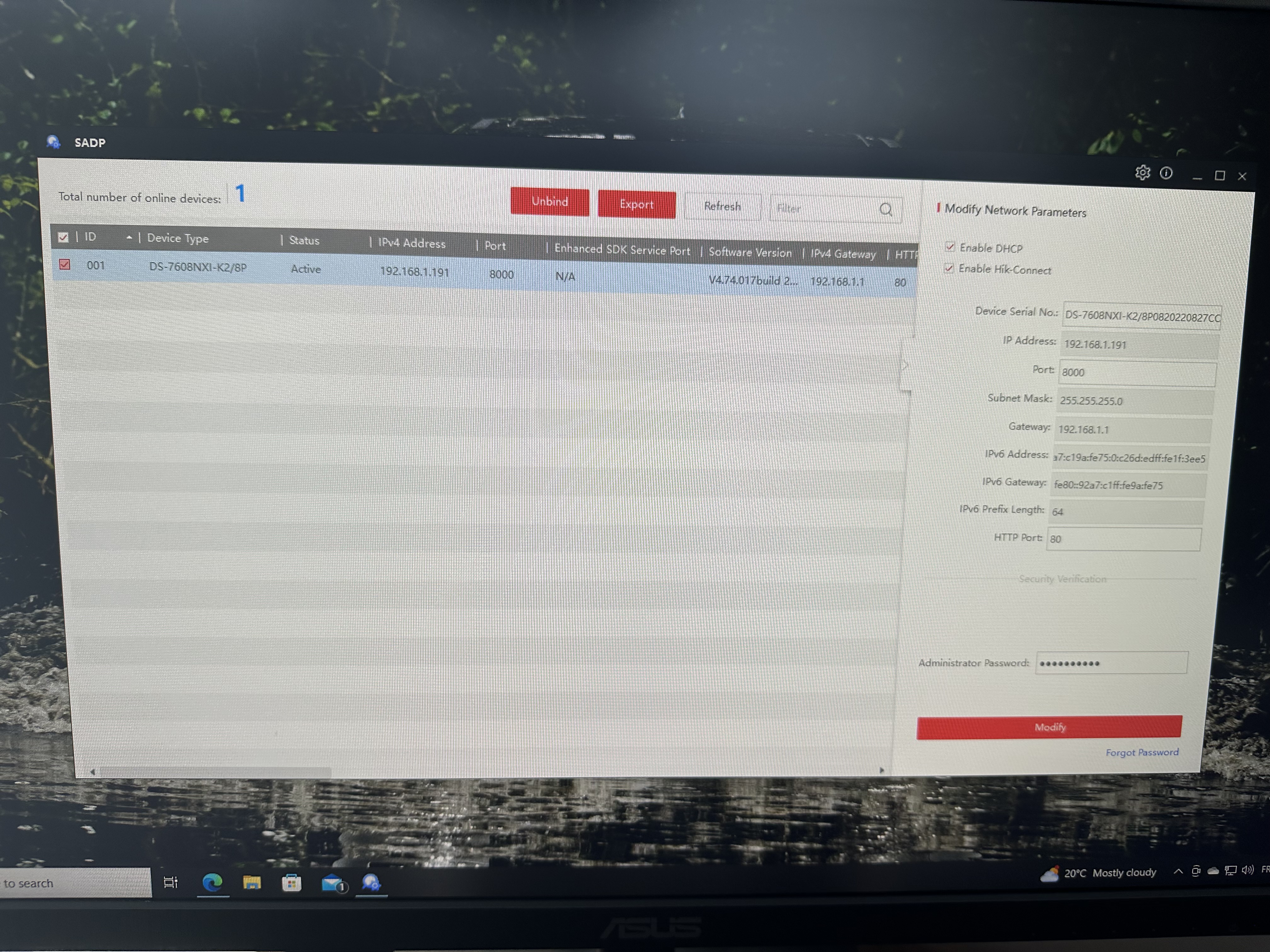

Hi Dan,
I see my NVR in SADP and IVMS. How come I don't see the 8 cameras plugged-in directly into the NVR?
I update the NVR firmware successfully with SADP but I didn't see the cameras so I can't upgrade the firmware yet.
What should I do to see the cameras?
Thanks!
Ian

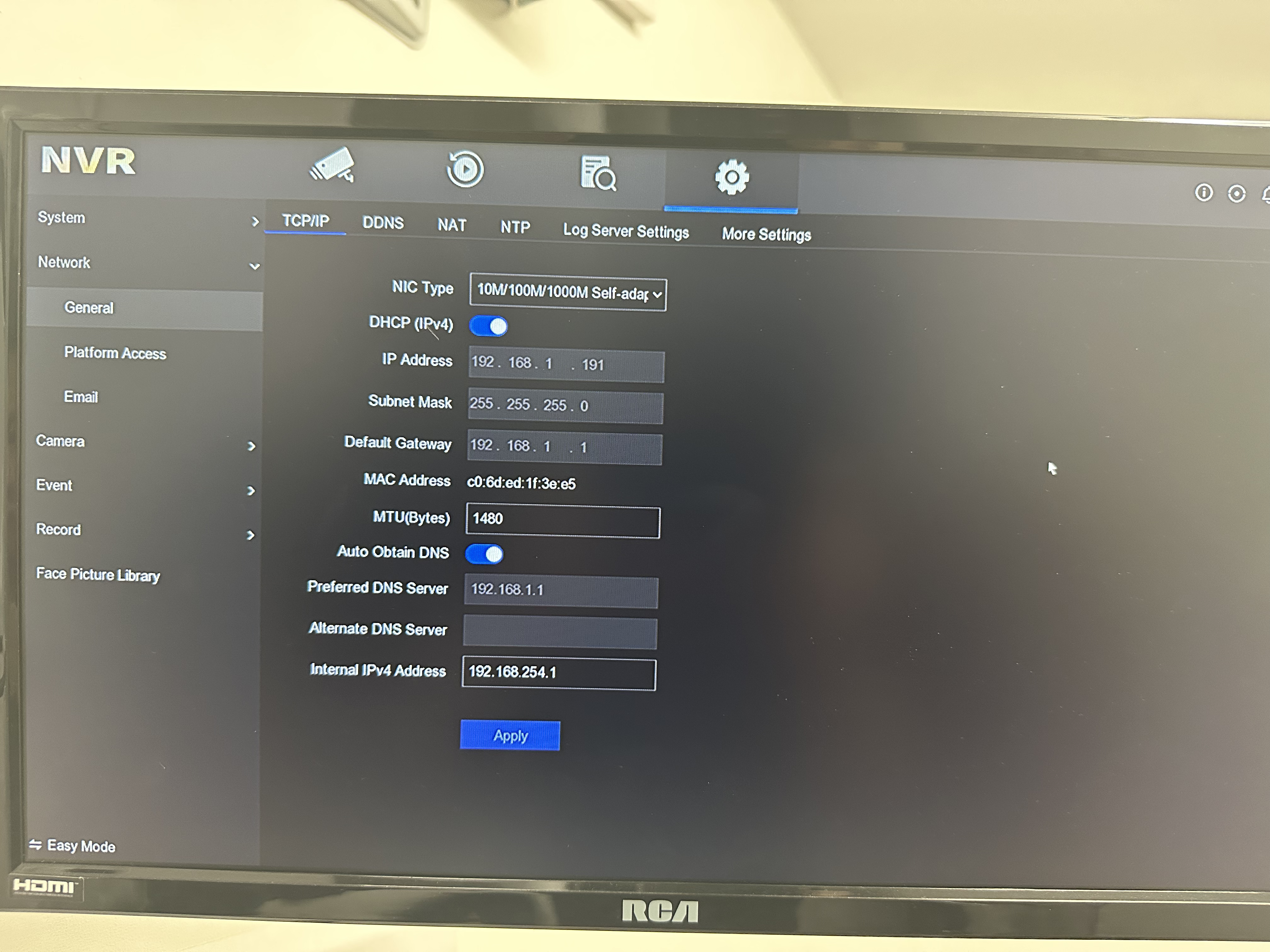

If the cameras are directly connected to the PoE ports on the NVR then they will be using the NVRs subnet IP range (192.168.254.xxx) which is not visible/accessible from your local network range, this is why you need to use the Virtual Host feature I linked you to earlier in this thread to gain direct access to the settings of each camera.

I was lucky yesterday. I don't know how I was able to update the firmware with SADP software and a browser. After that I can log in the SADP and I can see only the NVR but I don't have any access to the settings of the NVR in SADP software. But I've successfully installed the IVMS-4200 which I have accessed to every settings and the virtual host feature was enabled but I can see only the NVR and no cameras.

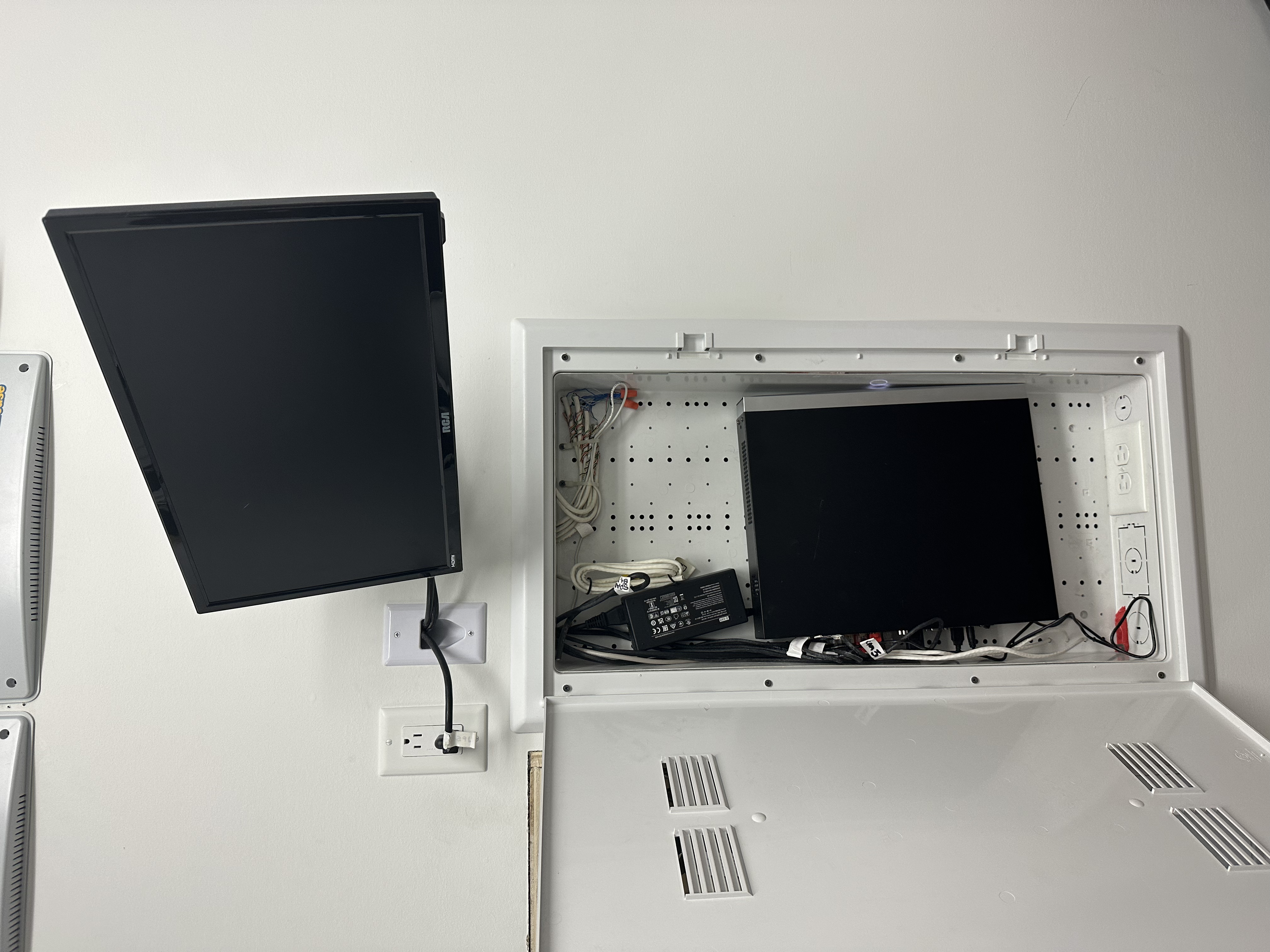

I can't use the USB option because the installer puts the NVR in a small area and it's impossible to but in a USB in front of the NVR. The back USB port is used by the mouse.
One option is to plug the pc directly into the back of the NVR but I don't have any PoE port left because they are all occupied the the cameras. Do I unplug one camera port to but the pc in and alternate the port after to update the first camera port? How do I specify a close ip address to the camera in the pc to detect the cameras if plugging in the back of the NVR? Also it will be a hassle to bring the pc/monitor upstair to the basement to plug into the back of the NVR..

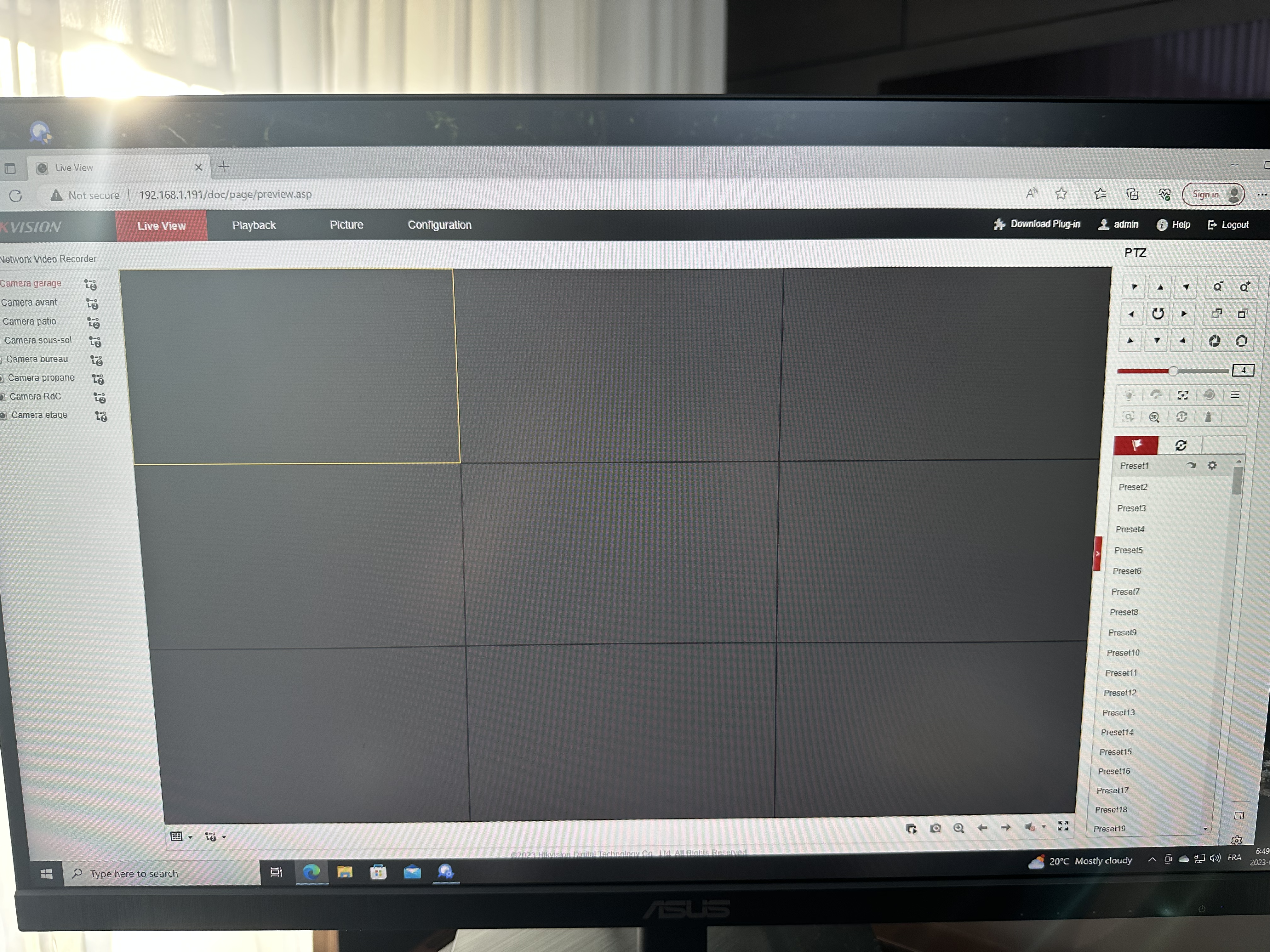

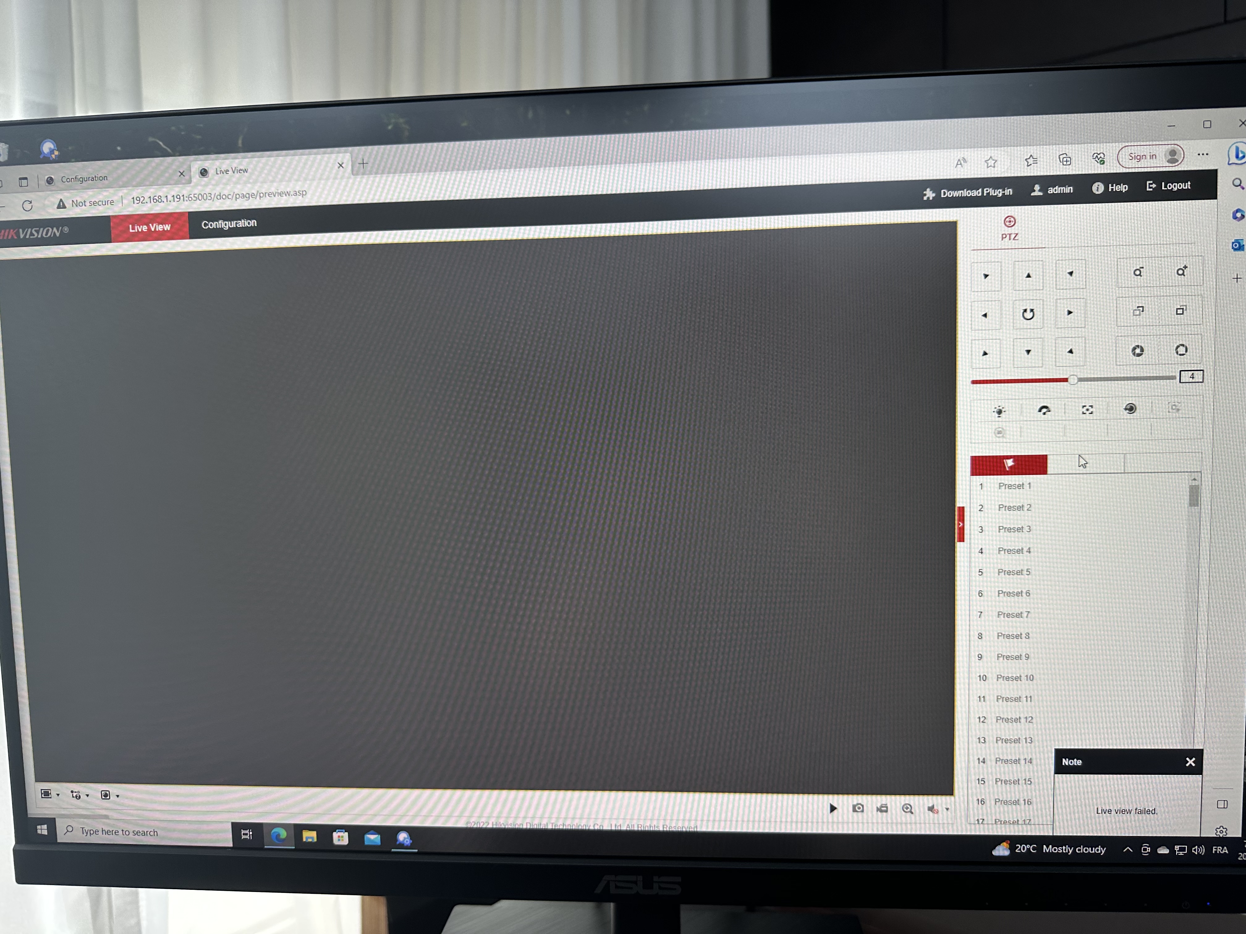

How come I receive an error message "can't play live view in SADP"? What should I do to be able to watch live view cameras in SADP?
Ian
Hi @ian1975
That screenshot is the browser access and not SADP, I wouldn't expect you to get an error code that mentions SADP when you try to play the live stream in the browser.
Can you please try double-clicking one of the cameras from the left of the screen and if it doesn't stream can you please confirm exactly what the error message says?
This is the only thing that I have from SADP software...

Hi Dan,
Live view failed with Edge in internet Explorer mode & Chrome too. Is there any setting to be done to be able to live view in SADP.
I can live view with the NVR and with IVMS...
Thanks!
Okay,
Is it only when logged into each camera directly that you don't see the live view? Can you view the live view of each camera when just logged into the NVR?
