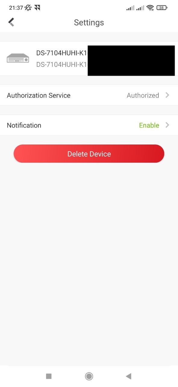

The DVR model is DS-7104HUHI-K1. There is no code or password on its underside. In the Hik-Connect app, when I select dots menu -> settings, I see only this. Can't understand why the screens are different.
You should be able to enable/disable stream encryption directly on the recorder but it differs between models and I've not used that one. Using the recorder menu (directly on the recorder using the mouse, not the web browser) In Settings > Network > Advanced > Platform Access (may be HiDDNS on old model) and turn off encryption there.

Somewhere in the menus (on the monitor connected to the HDMI output) you will find 'Verification Code' and if you input that in your app you are sorted. However you can definitely turn off 'Stream Encryption' on the recorder (again using a monitor connected to the HDMI output not a web browser) so that you do not need that verification code. Usually you'll enter it once when registering the device to the Hik Partner Pro or Hik Connect account - it's required to verify that you own the device and haven't just got the serial number.
Thank you so much @JB1970 , that was the solution. The DVR menu (through the monitor connected to the device) contains the verification code!
