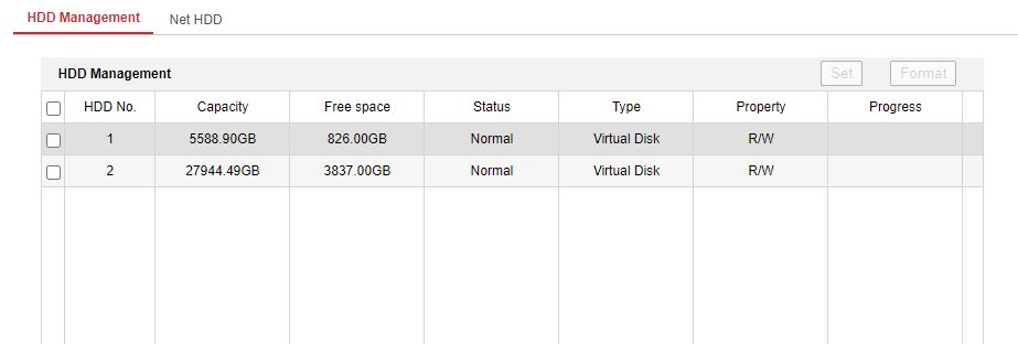

The storage capacity has been set as 8.5T(HDD1 RAID 0), 27T(HDD2 RAID 5), and totally 4.5T is available.

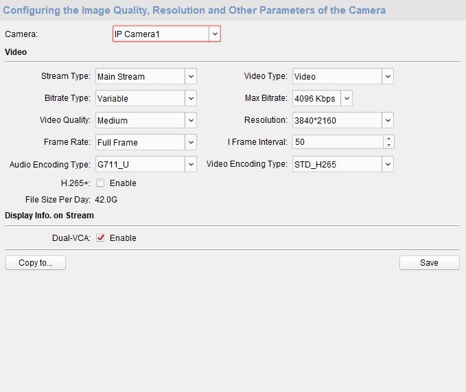

You say the stream settings (e.g. frame rate, resolution, etc...) are the same on all the cameras, can you please share a screenshot of the stream settings for one of the cameras?
We want to see exactly how you have the cameras configured.
Thanks for your prompt response.
The screenshot of the stream setting has been attached for your information.
Thanks @Johnson
So at your current settings, there is no way you are going to get 31 days of continuous recording from 82 x 8MP cameras.

Can you please share a screenshot of the storage management menu so we can see the details of your HDDs & storage capacity?
Thanks @Johnson

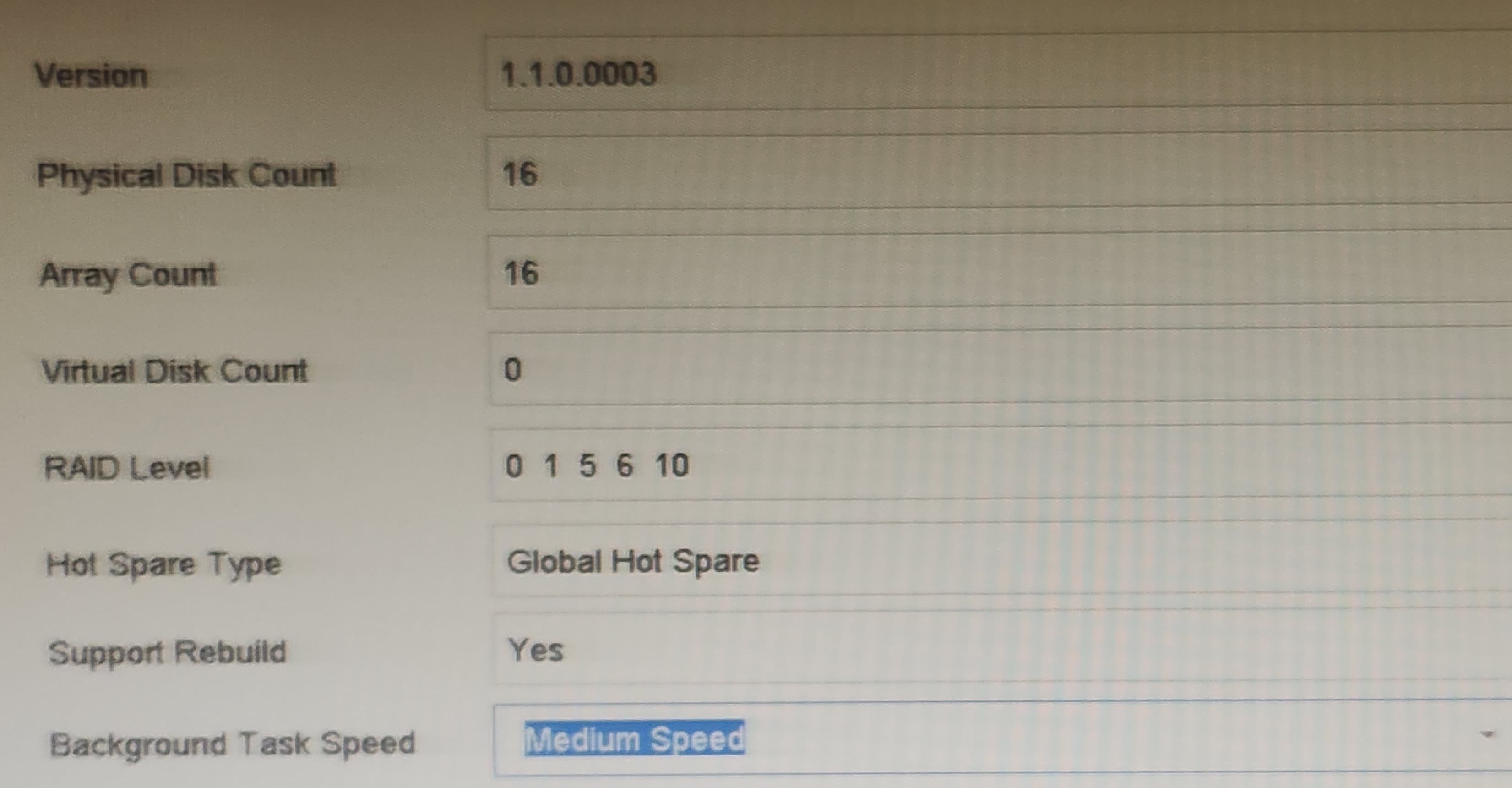

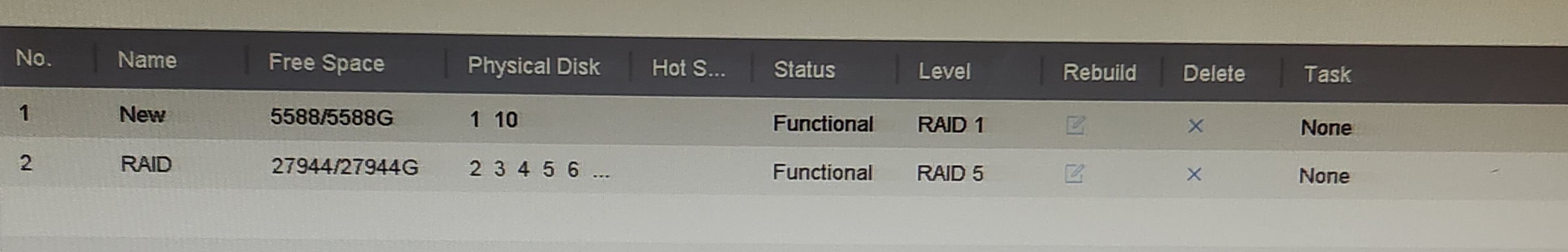

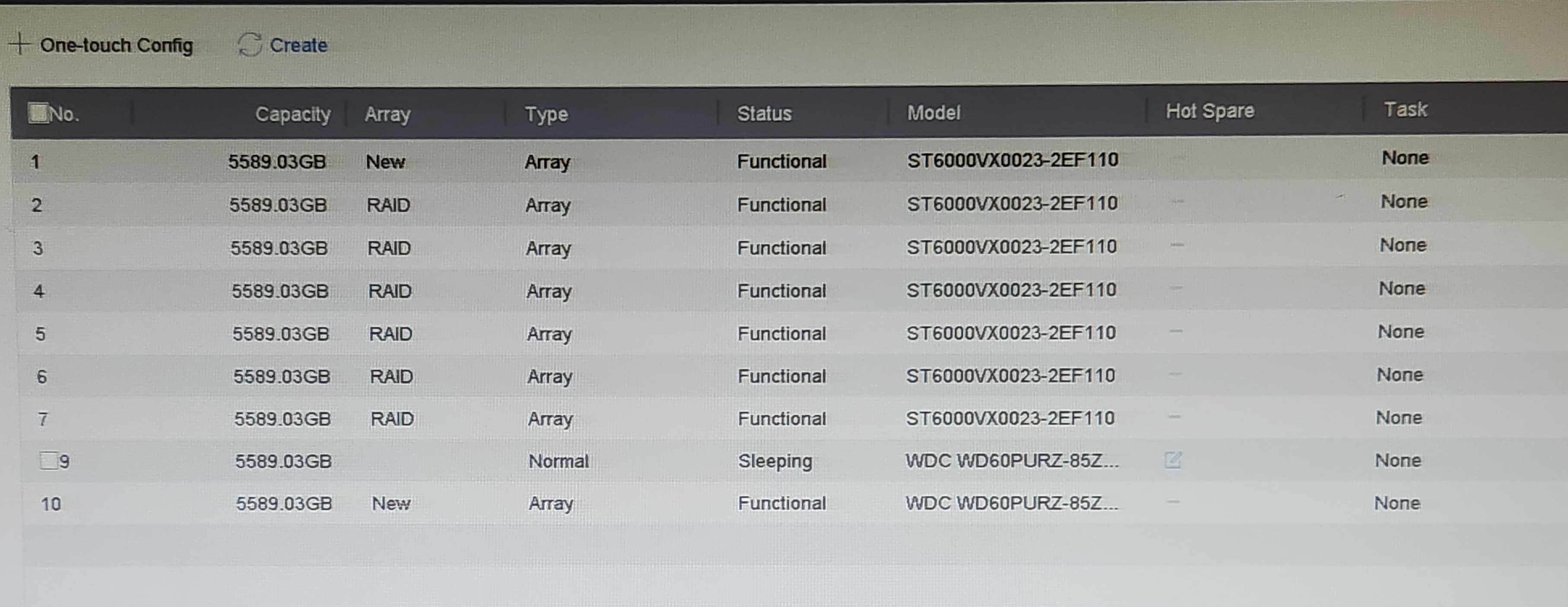

Can you please also share screenshots of the RAID menus so we can see how you've configured the above storage arrays/virtual disks?
Thanks @Johnson
Looking at the information you've provided I think the free space you are seeing has to do with the RAID configuration and/or the huge amount of data you are recording, the 4.5TB of free space you are seeing is probably close to the amount of data that is regularly being overwritten/rerecorded (1 x 8MP camera will need nearly 4TB of storage for a day's continuous recording).
Also, we have a 7716NI-I4 NVR with 4 HDDs installed that has been recording for years and has no RAID configuration. It is overwriting and is showing 0TB of free space, so I think the RAID configurations you have set are reserving some of the storage capacity as part of the RAID process.
To be honest, we have never had any hands-on experience with an NVR of this size, with this many cameras, and RAID configured (we don't usually recommend running a single NVR with more than 64 cameras), possibly there might be other users here who have set up systems of this size and/or have seen the same free space situation with RAID configured that might be able to advise you further.
