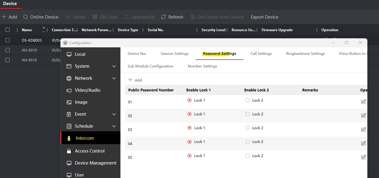

here you go:

Sure, I do have the KeyPad. (KD-KP)
Thank you for the capture - I did, in fact, set a password and observed two things:
1. When I enter a password and then select Edit, the password is not saved.
2. I've set my password to 121212, but when I input #121212#, nothing happens. I've also tried *#121212#, but nothing happens either time.
I'm attempting to determine what I'm doing incorrectly, as it appears the password is not being stored:/.
