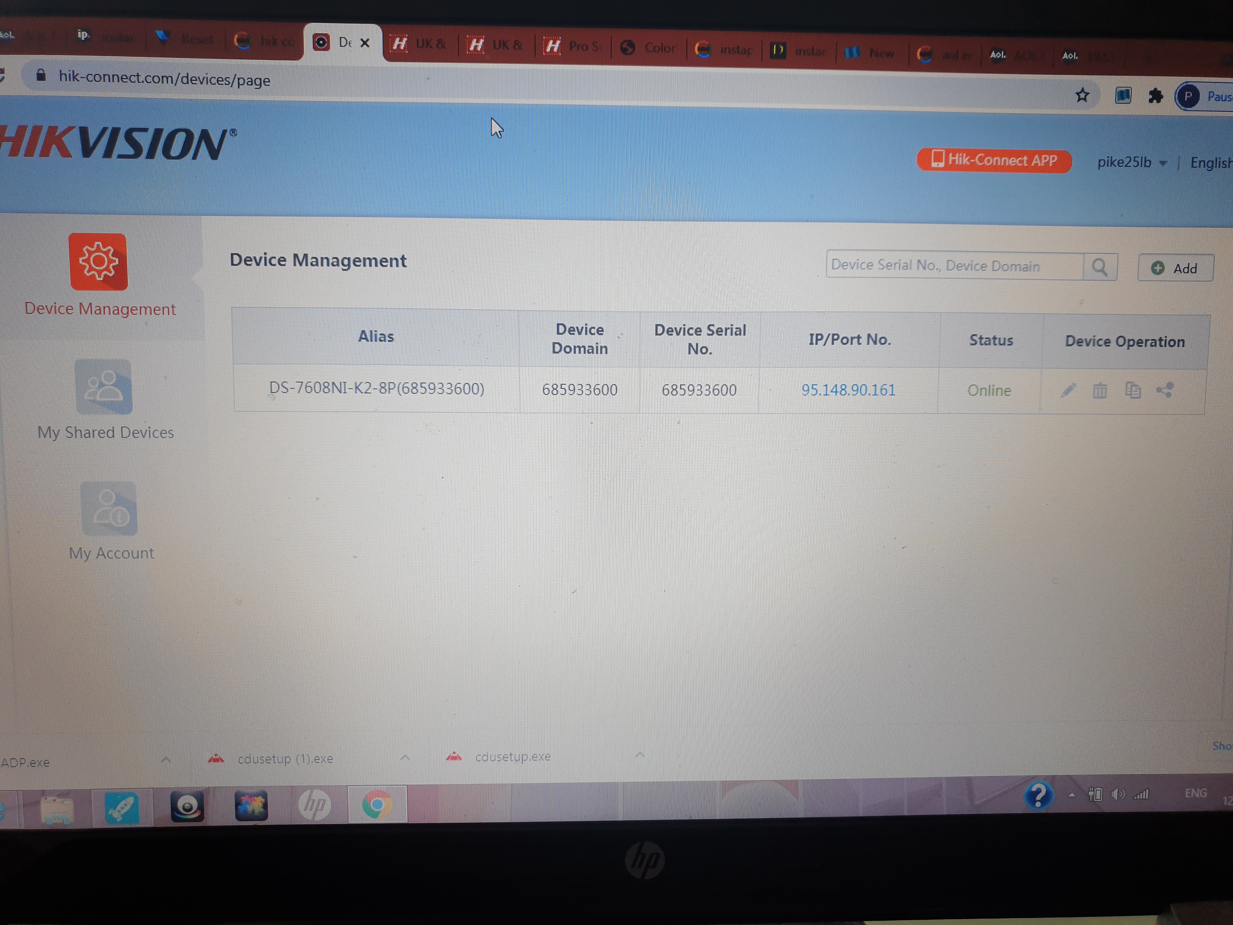

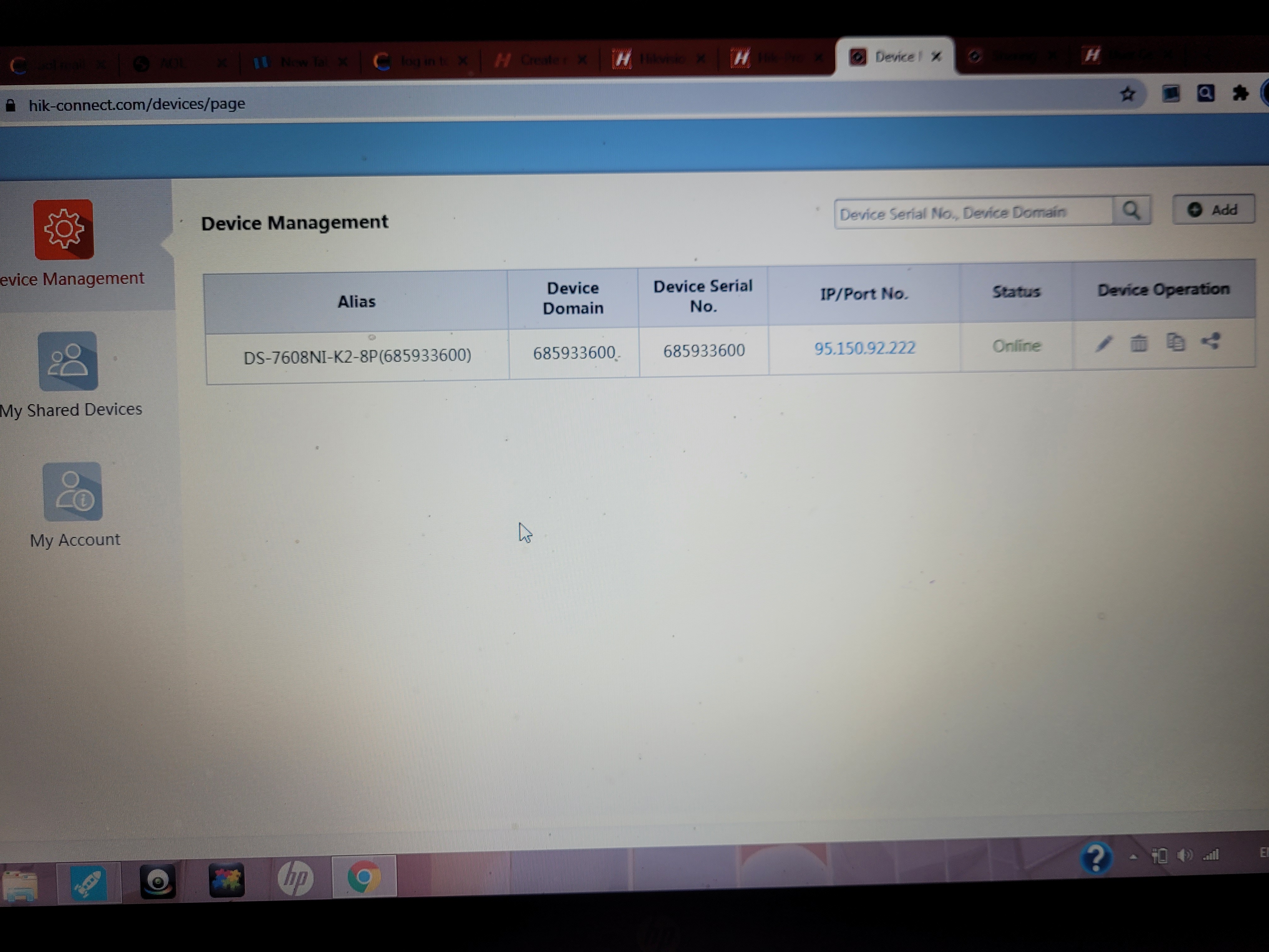

I would like to turn the spot lights off on my g2 camera but I am struggling to access the settings all I can find is the nvr could anyone help thanks

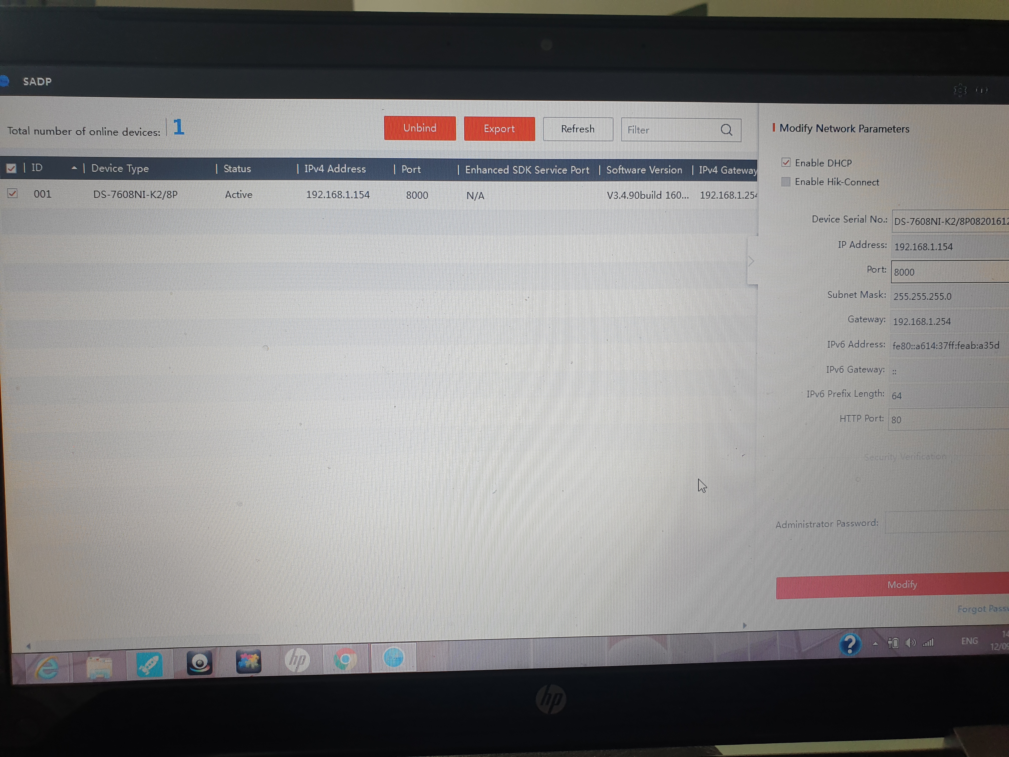

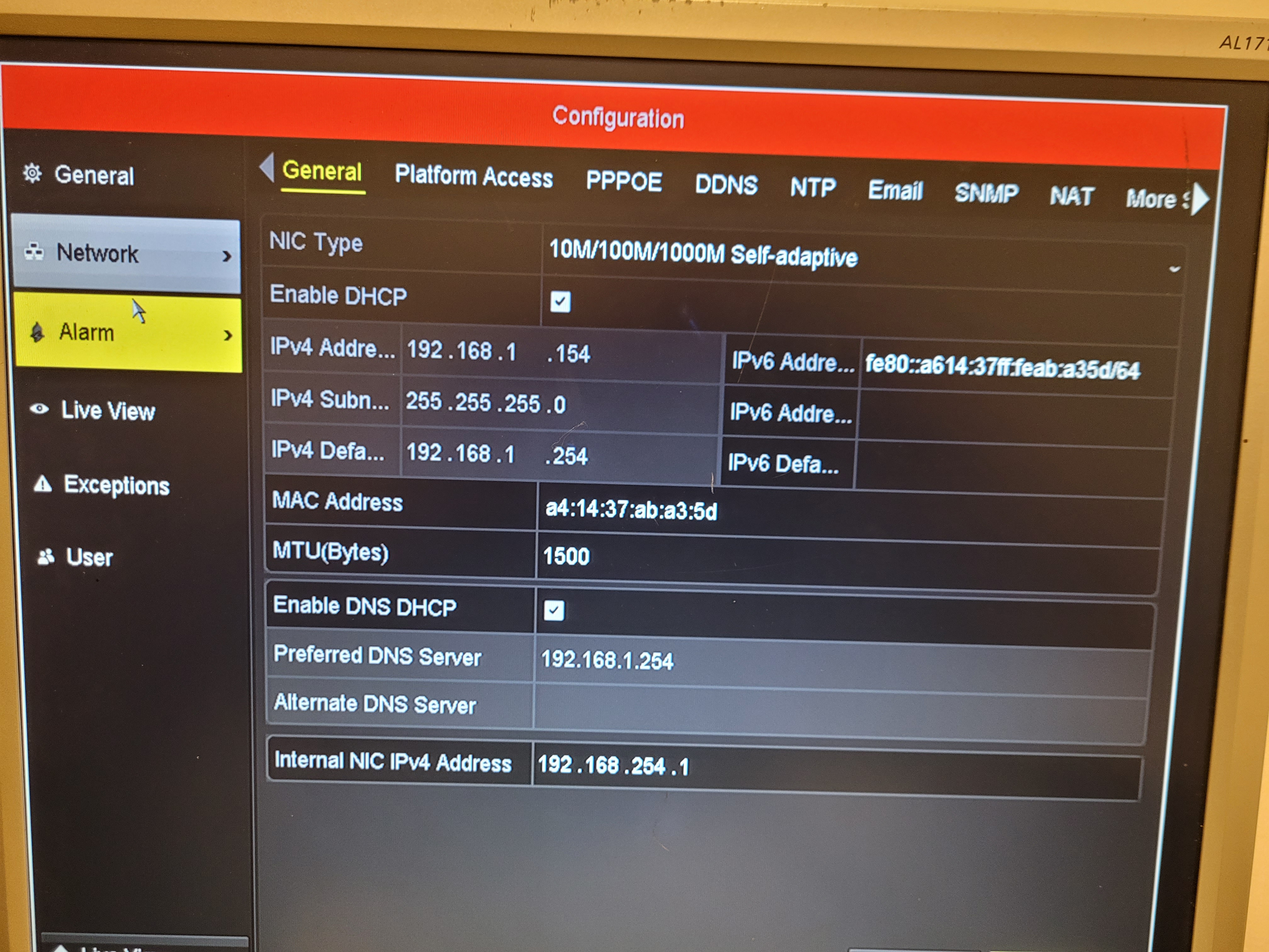

Hi @Pike25lb
You need to use the NVRs IP address (192.168.1.154) to log in to the NVR on your PC using Internet Explorer.
Once logged in with a browser you should be able to follow the earlier instructions to enable virtual host and then access the cameras directly.

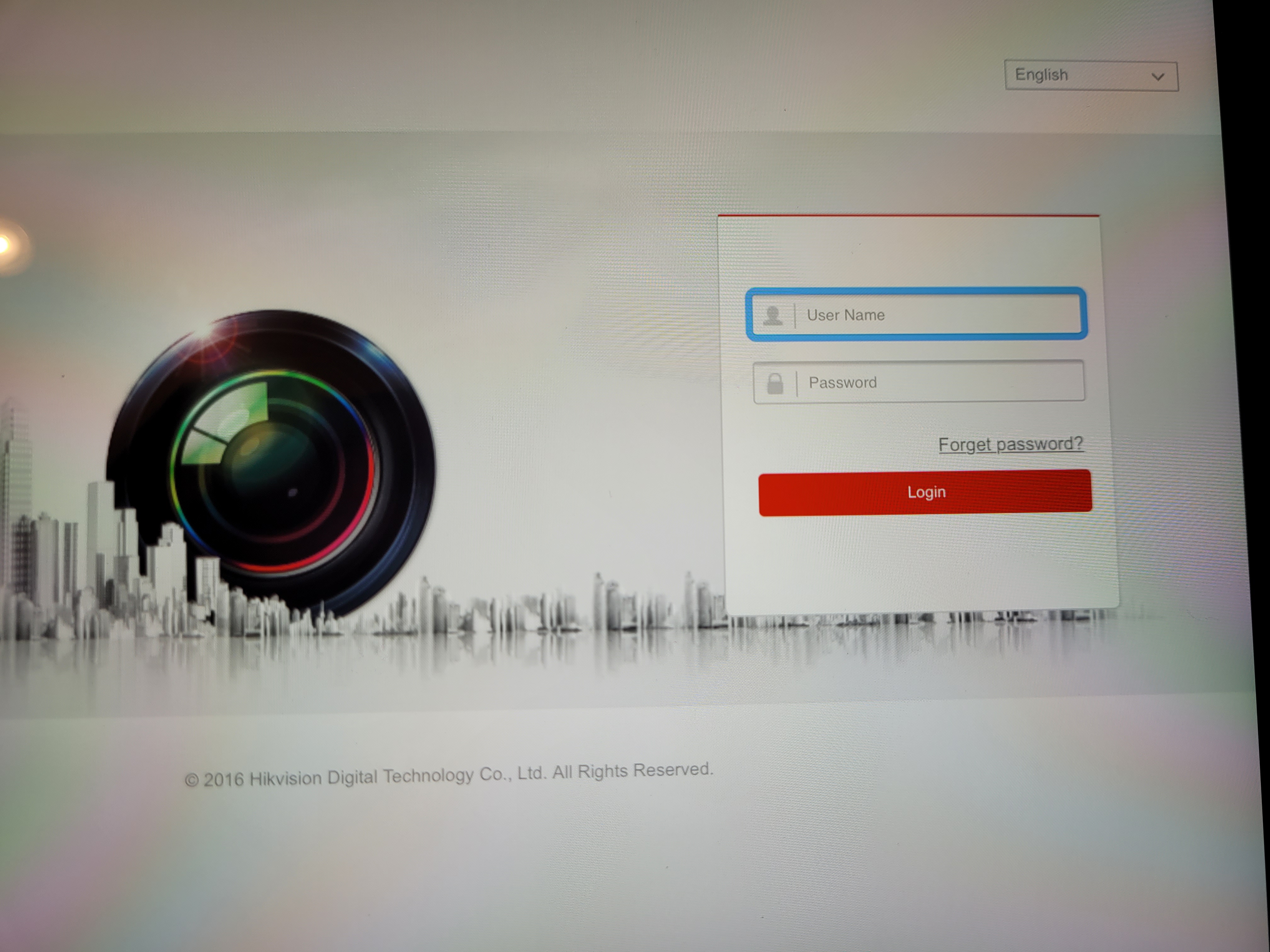

Sorry I get this screen and I don't know the log in details
Hi @Pike25lb
The login will be username - admin / password - set when you first installed the NVR
If you have only ever accessed via the direct monitor then you've likely never used the password that was set when the NVR was first installed so you will need to follow the password reset instructions and send the password reset file to your original seller/installer to get them to reset the password for you.
