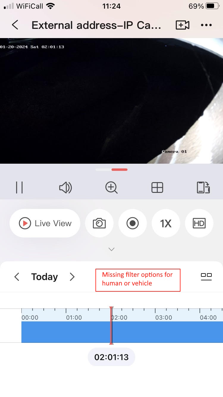

ps. attached image is of the ColorVu camera at night where you can see that the orientation and white light renders it useless at night (hence why I want to turn down/off the white light at night). It also doesnt show any options to filter by human or vehicle.

Hi @mcfly72
We would probably go with option 2, the AcuSense NVRs will let you apply AcuSense features like the Human/Vehicle filtering to up to 2 x 4MP non-AcuSense cameras like your IPC-T240H cameras.
Also, with the AcuSense NVR you might be able to access the cameras directly using virtual host (although we've never tested this with HiLook cameras) and if you have access to the cameras you should be able to control the white supplement light settings to avoid the glare issues you are seeing (but you could also angle the camera away from the wall on the right of that image as that is overexposing and making the rest of the image much darker).
