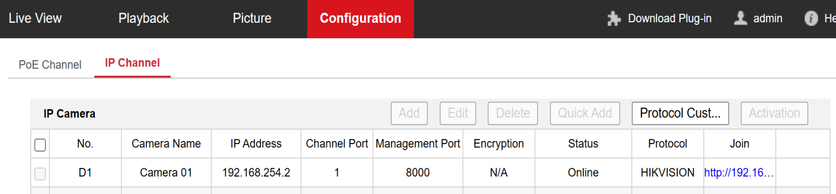

I have checked that the camera is online in the camera Management settings (web interface):

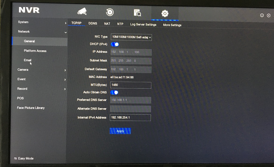

These are the network settings on my NVR:
Could someone help me to figure out why the cameras are not appearing over the network? (in the screenshot above I only have one camera plugged in for testing.)

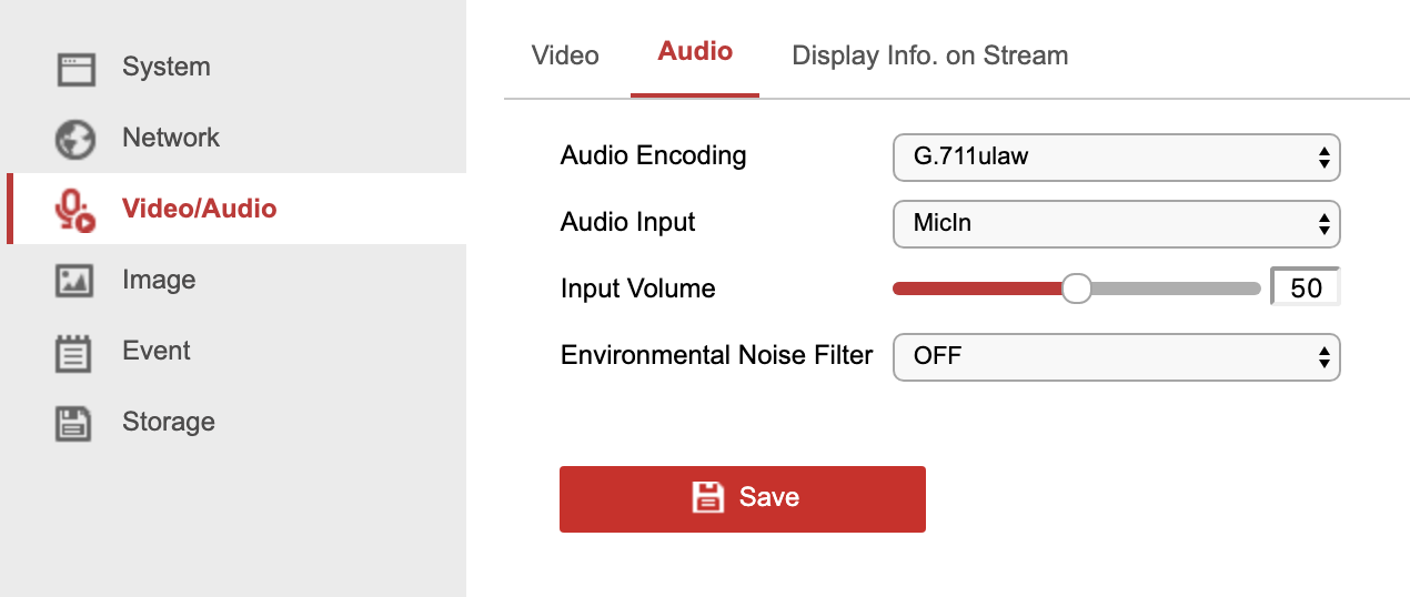

And if I get passed this hurdle, I hope I can troubleshoot the audio menu issue. Maybe it will magically appear!
This is the menu that is missing:

@RexTheRunt. Enabling the NVR virtual host may help you access cameras connected to the NVR. How-to: - How do I use a Hikvision NVR's "Virtual Host" feature? an old link but may help.
Cameras connected to the NVR are on a private subnet (192.168.254.nnn) not accessible via your LAN.

I'm able to get into the camera using the virtual host feature and I changed the audio settings from mic to line-in. Happiness!

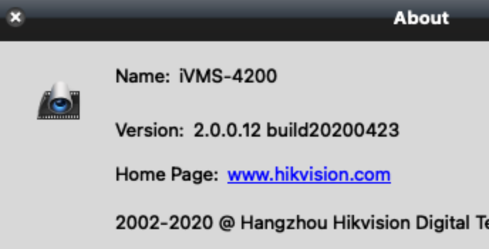

What version of IVMS-4200 are you using?

Thanks for your speedy response David...
I'm using this version for Mac OS:

On the web interface, camera 1 is shown as online with address 192.168.254.2 (but no feed).
The virtual host IP is for camera 1 is 192.168.1.104:65001
The address is 192.168.1.104

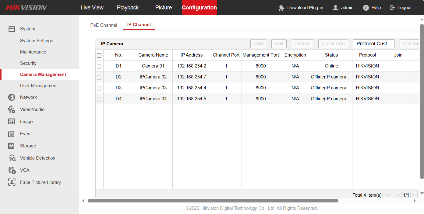

The web interface shows the camera as online:

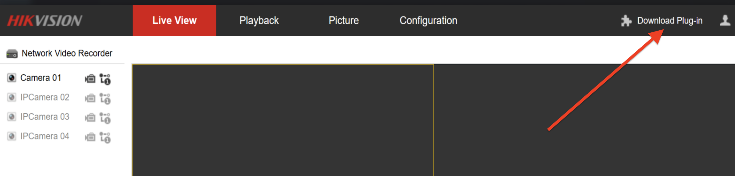

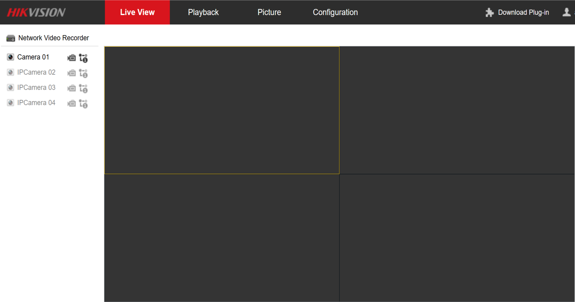

The live view is dead:

I can see the live view when I log into a single camera, but not when I log into the NVR, so I don't think it's the plugin.
I'm using Microsoft Edge browser. I could try install Chrome?
