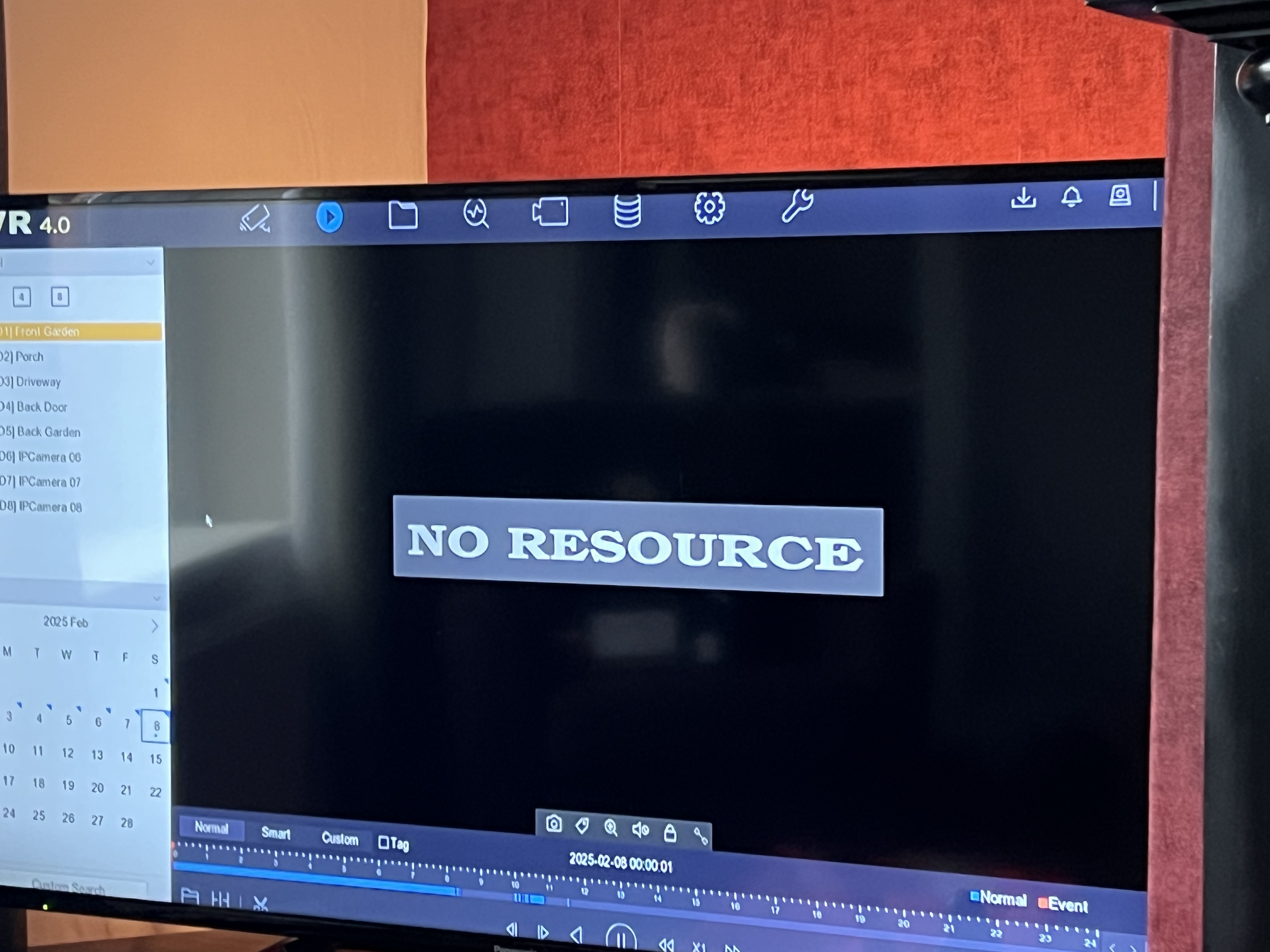

Waiting a long time to see if anything changed its not, all cameras say they are recording, but only 2 are. I initialised the HDDs, no change. The cameras are self assigned from the rear POE points, so i moved one of the problem ones from port 1 to port 8, comes up buy doesn’t record, when it says it is, plugged the new camera id planned to fit into the port 1 comes up and works fine, but doesn’t record when its saying it is, when i go to the recordings just get the big “no resource” message, any ideas?
The message i get when i try and view certain cameras that have so called recorded, as i say some still work fine.

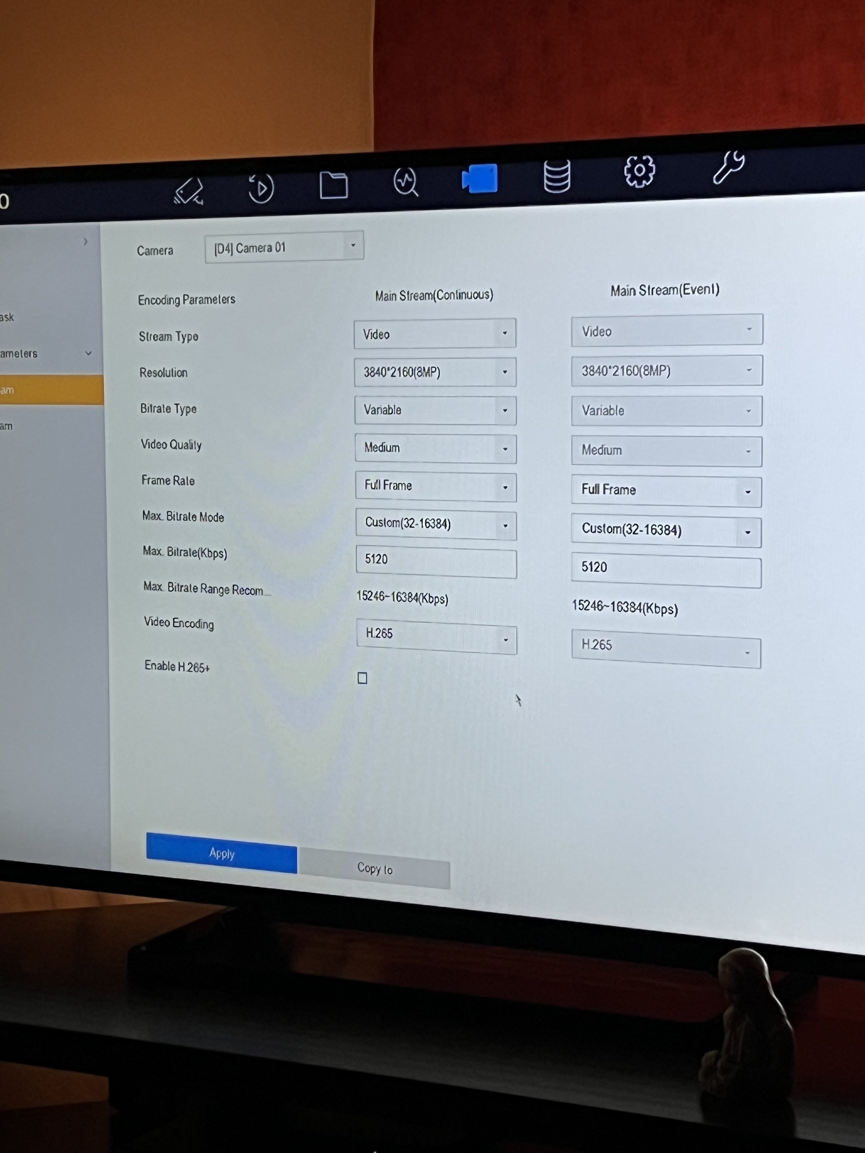

Rolled back to 4.50.010, that didn’t solve it. Went back to 4.51.005, hard reset it and noticed when i had the port 1, 3, and 4 cameras unplugged, it was significantly more stable, these camera have been problematic since the update yesterday, out came the ladders, checked the cables with a cheep tester, all fine, its worked well for me over the years. Plug D1 in (8mp 2385) reset the camera and add as an inactive camera, NVR resets and then is fairly stable, then 30 minutes later add D3 again reset the camera, it is fairly stable, go to look on the anpr to see plates its picked up, crashed, then ok. Add D4 (8mp 2385) unstable, crash’s a lot, so plugged it into D8 my last spare, crashed just as bad.
When i look in cameras playback and these 3 say they are not recording and show “no resource” message on playback when you log into the NVR but on an iPad they work fine and you can play back, then notice bit rate on these camera is unlike others and custom and high, turn to normal and set at max 3074 and then just went and set them set at 256+ so it does it all for me. The 2385 4mp and 2386 8mp work fine. Think there’s an issue caused by these updates and not been cleared by rolling back and it’s affecting decoding.

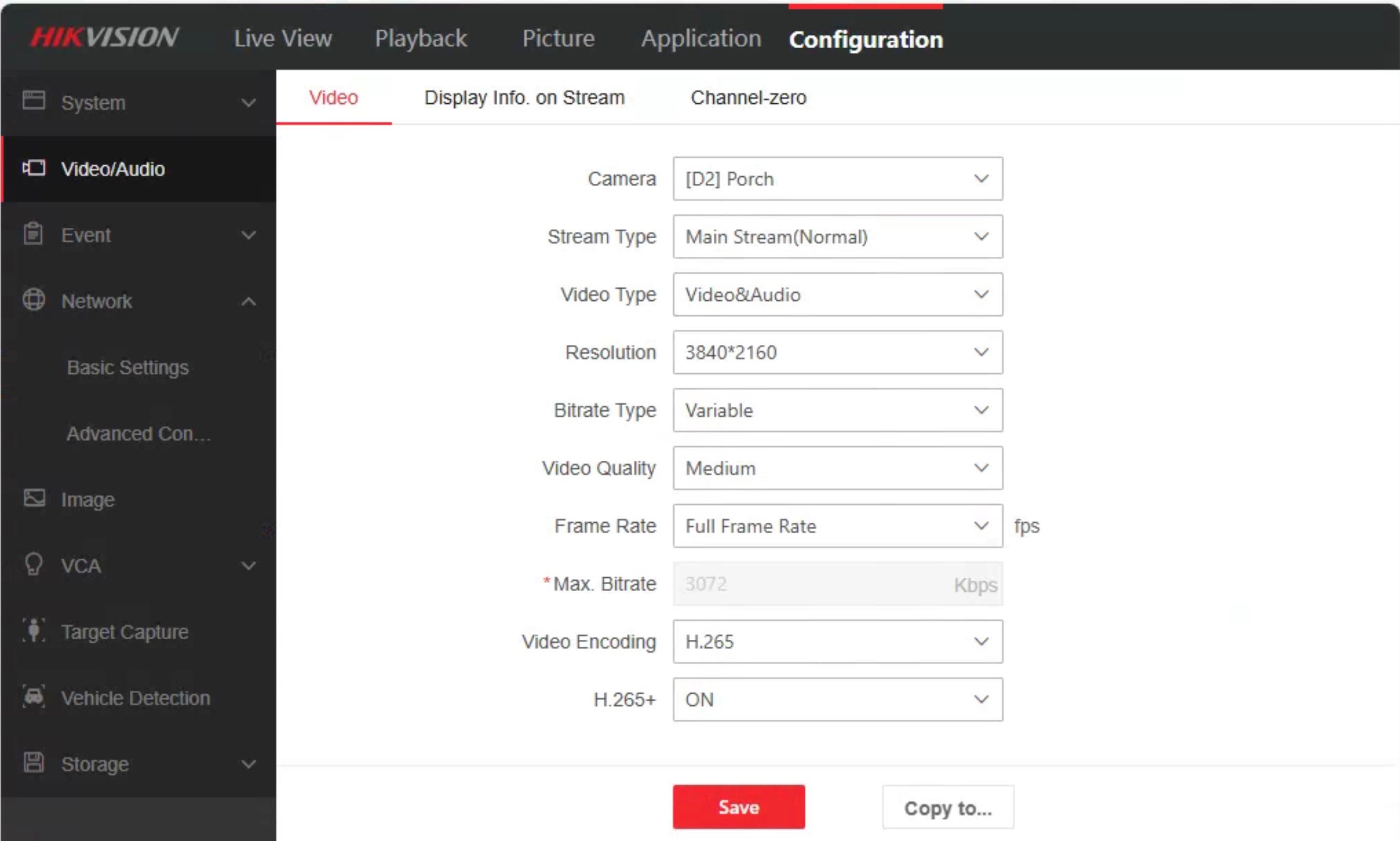

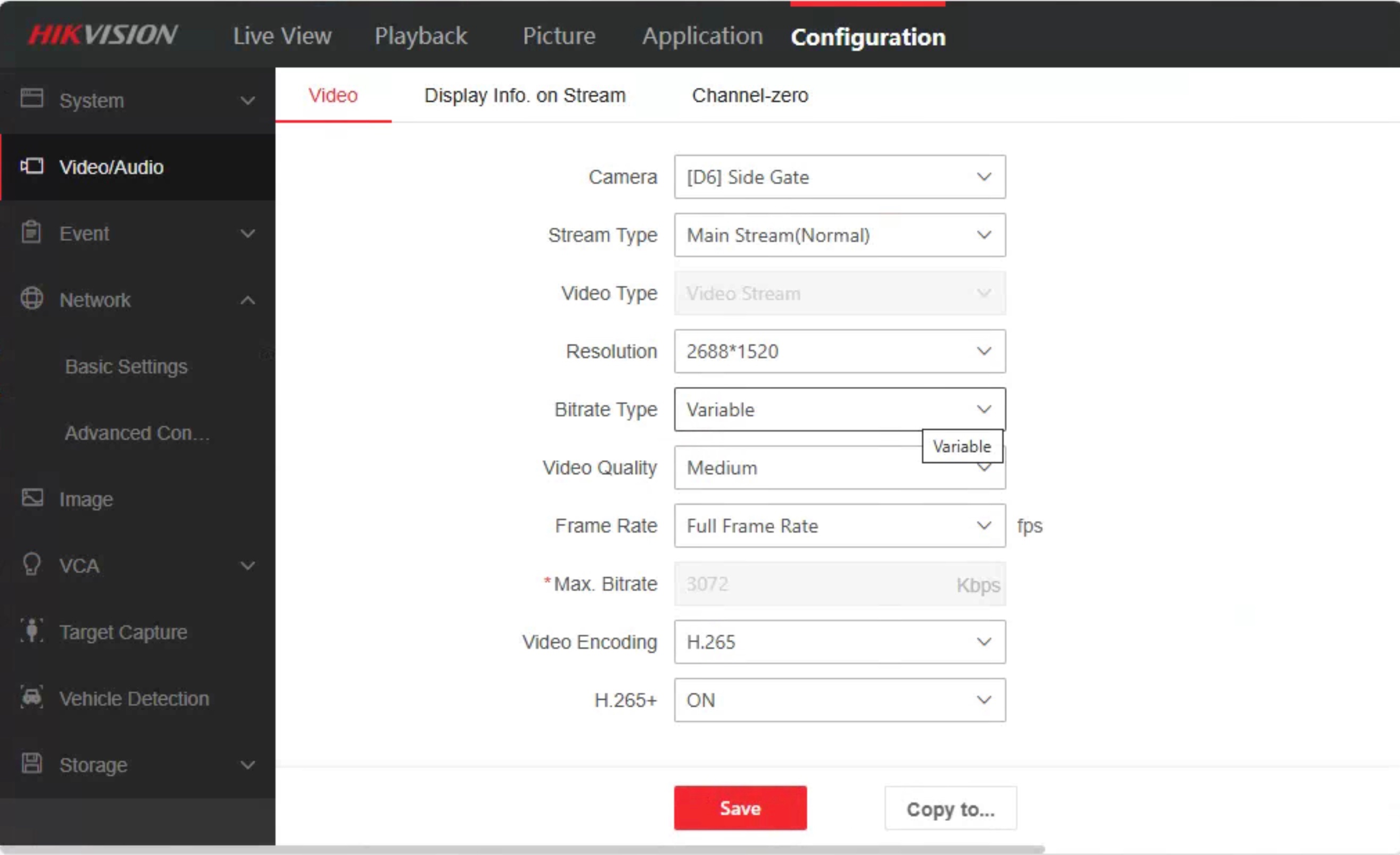

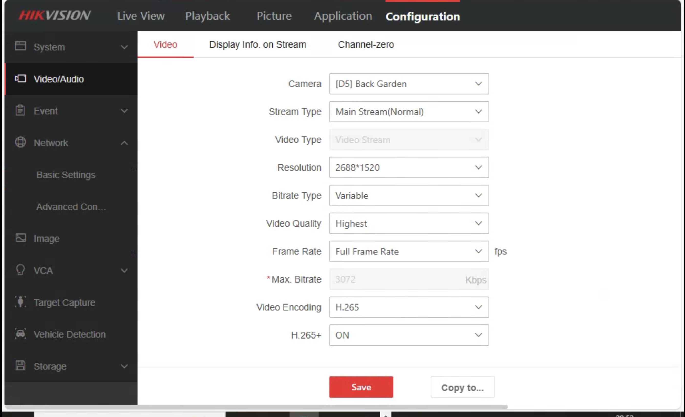

Did you add the new camera... I see the NVR has 80Mbps incoming bandwidth... could the "no resource" message be caused by lack of incoming bandwidth? How many cameras do you have connected and what are the maximum bitrates for each one?
Thanks for your response, I appreciate any help, at points over this weekend, the ‘no resource’ message was not an issue, the current setting re as the photos

To be fair, it all went wrong as soon as I did the software update before I added any cameras, and it’s existing ones that were the problem.
Initially they were as the attachment, I backed the down and put to 256+, it was only 3 cameras that were like this.
