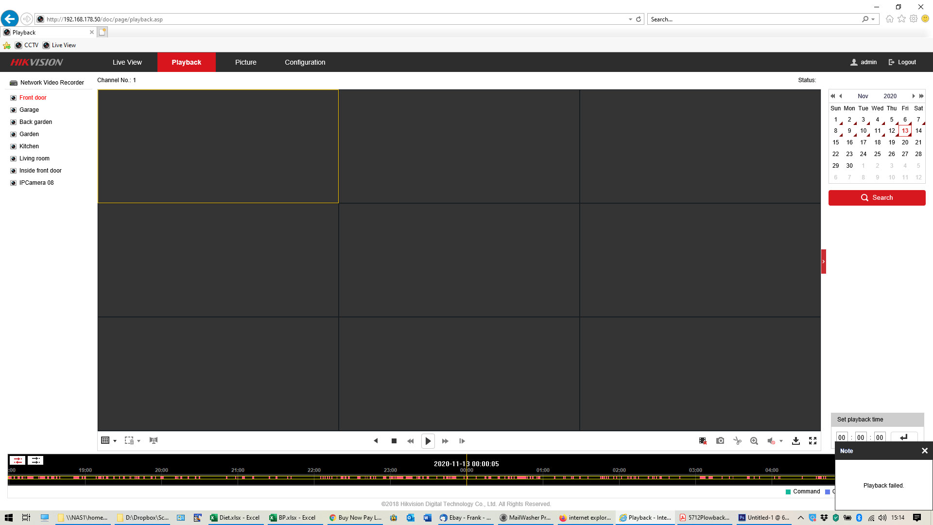

A can post a screenshot (thanks for the offer). What would you want it to show?
It'd be useful to see a full-screen view of the page with 'playback failed' error message showing.
I'm not sure how helpful this might be...
Hi, the screenshot is helpful - it confirms that you seem to be doing all the right things! :confused:

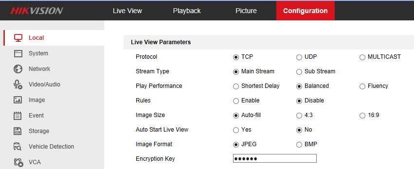

I don't suppose that you have recently configured an Encryption Key?
[I would expect a more precise error message]
You can disable encryption via the direct-connected monitor - might be a useful quick test.
Thanks. My laptop screen looks like yours but I cannot find a screen on the directly-connected monitor on which to set/unset encryption. Could you give me a clue please? And thanks for sticking with this!
You’ll need to do this by a directly connected monitor to the NVR, and going to:
Configuration -> Network -> Access Platform and untick "Enable Stream Encryption".
