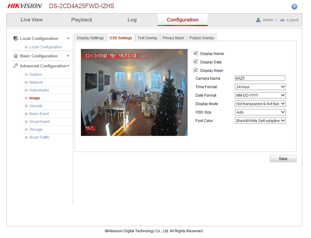

It works OK for me.
I used the IEtab extension with the Chrome browser:
[Firmware version - V5.4.5 build 170302 ]

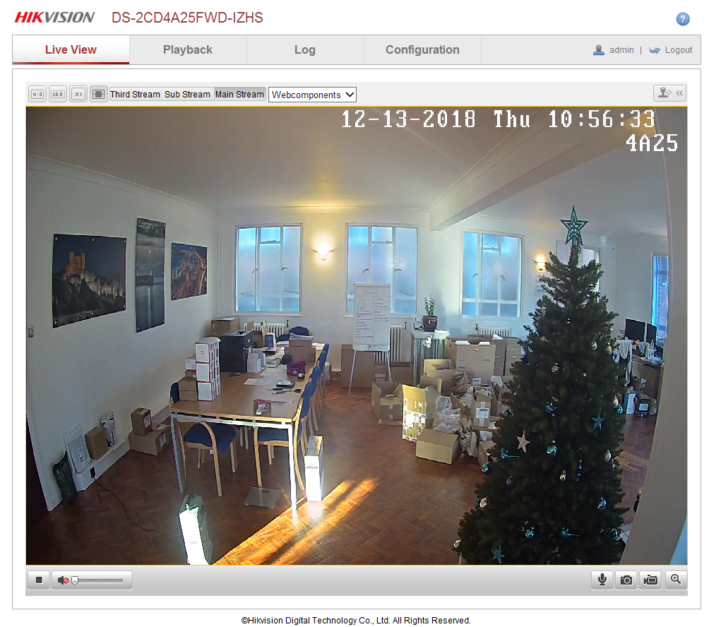

Thanks, Phil.
Nice view of Christmas tree and a lot of Christmas gifts.

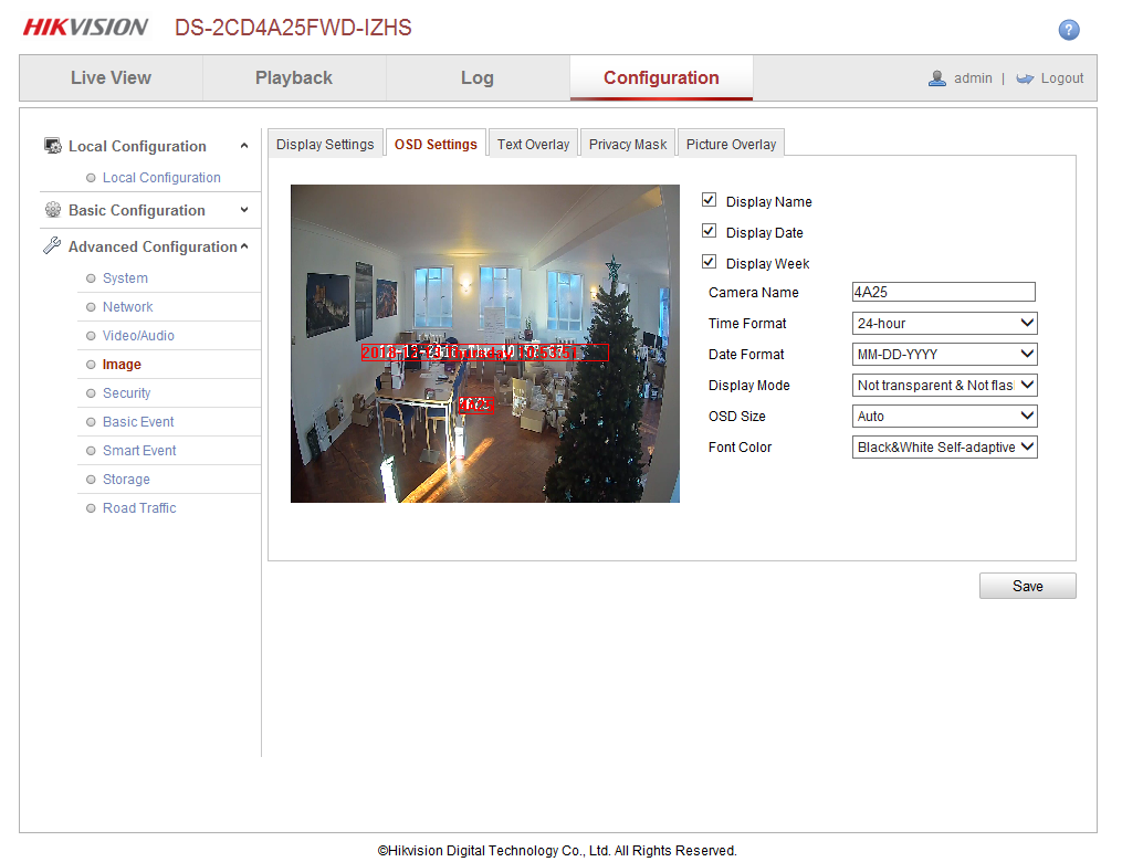

Phil, is the config picture where you set the time and dato in the up right corner simular to mine: Two version of the time and dato - one in the middle and one "red" to the right? Dissapair the "red" time and date after saving. It does not here.
