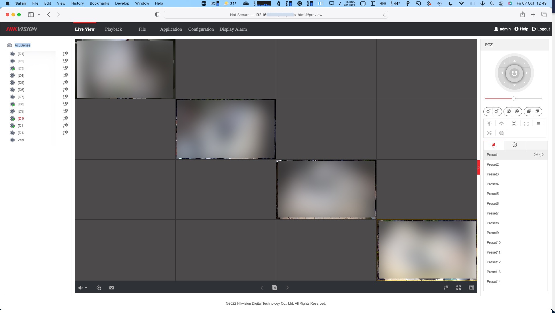

Interesting Safari doesn't work for me, what did you do to get it working?
What OS are you running, I have an M1 Mac, and I opened Safari and just typed in the NVR's IP address.

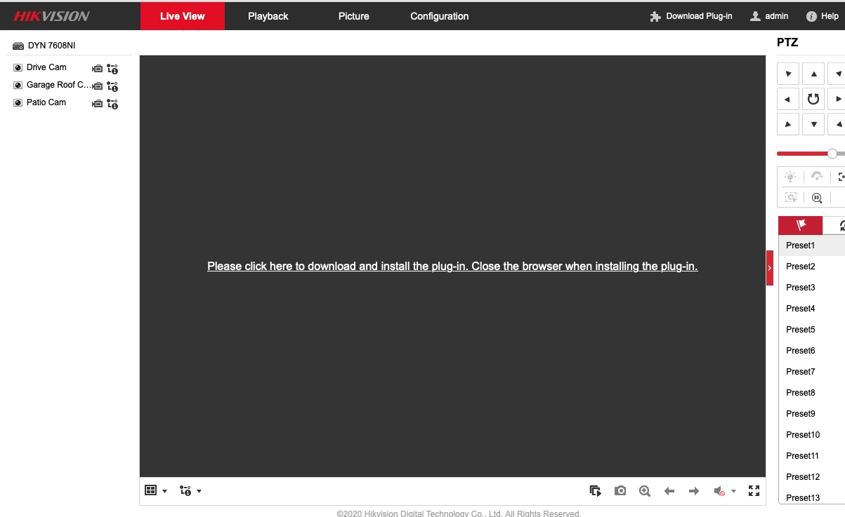

I'm on an Intel Mac Mini running Monterey 12.6, and I get the plugin message..... This happens both in Safari and also the Technical preview variant.
Ah ! sorry !!
I checked my notes on my PC, I installed the following plugin ( this was many moons ago )
Alas this doesn't make any difference on my Mac at all I still get the plugin message.
