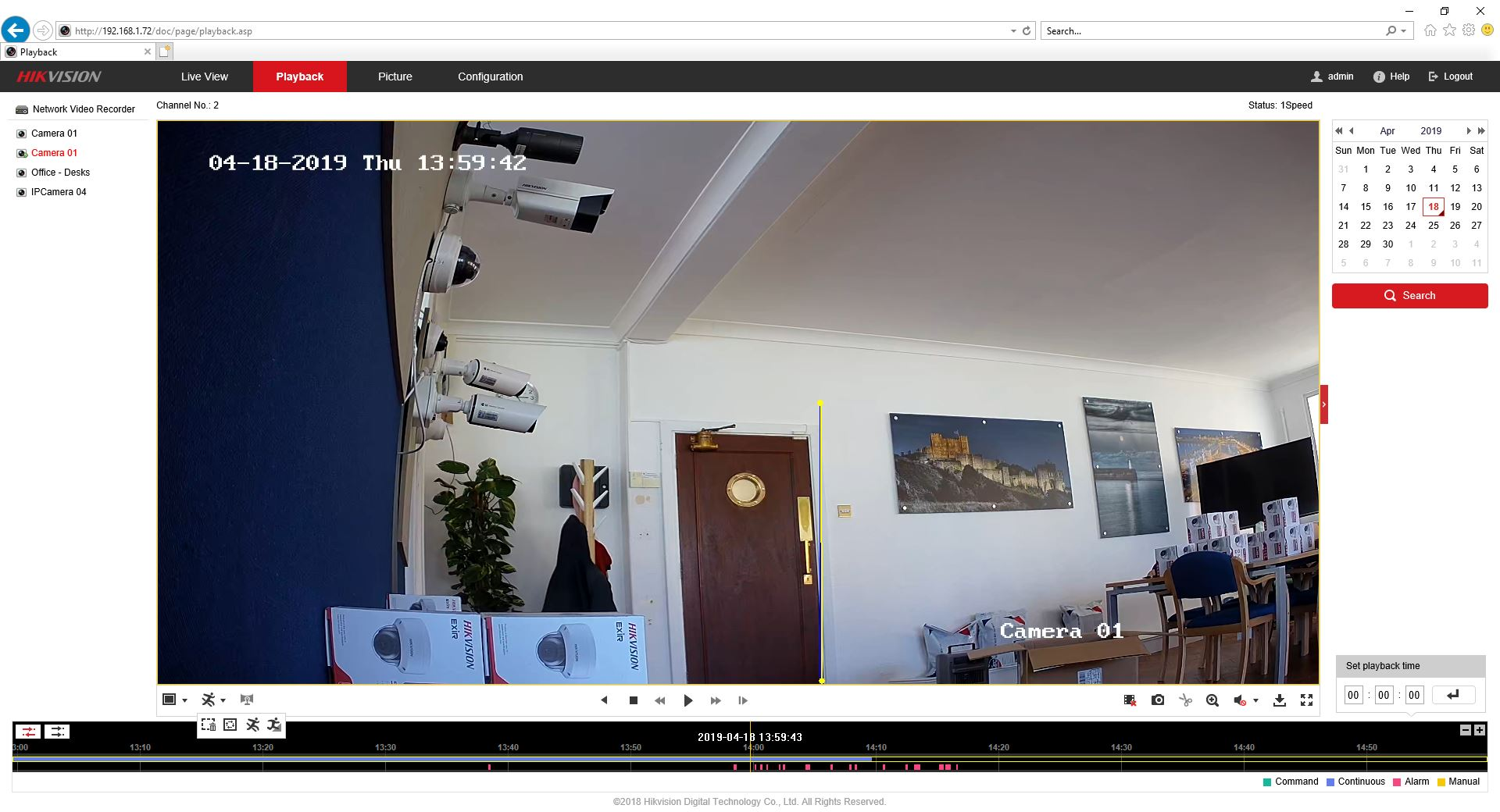

7608 set for continuous recording, line crossing and intrusion detection only. I can view detection marks in playback mode on the local interface (NVR's monitor), but I cannot see those same marks when logged on via the web interface. I only get the blue line. I am in single camera mode, video playing, and I've set the button on the bottom left to both line crossing and intrusion detection - but no red marks in the time line. Any idea why?
Cam and NVR are both on the latest firmware. Using IE with up to date web components.
