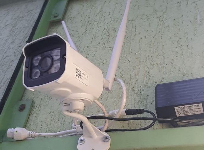

I'm trying to figure how to make my 2 IP cams (wifi) work with iSPY.
The cameras, as shown in the image below, are those generic WIFI cameras:
They come with a software called V380. With it they work properly, good quality of image. But the original app is very limited in options (don´t have even motion detection).
I use a notebook as a "DVR", so I wanted a better app to handle the CCTV system. So I chose iSPY. But I cannot make it work with my cams.

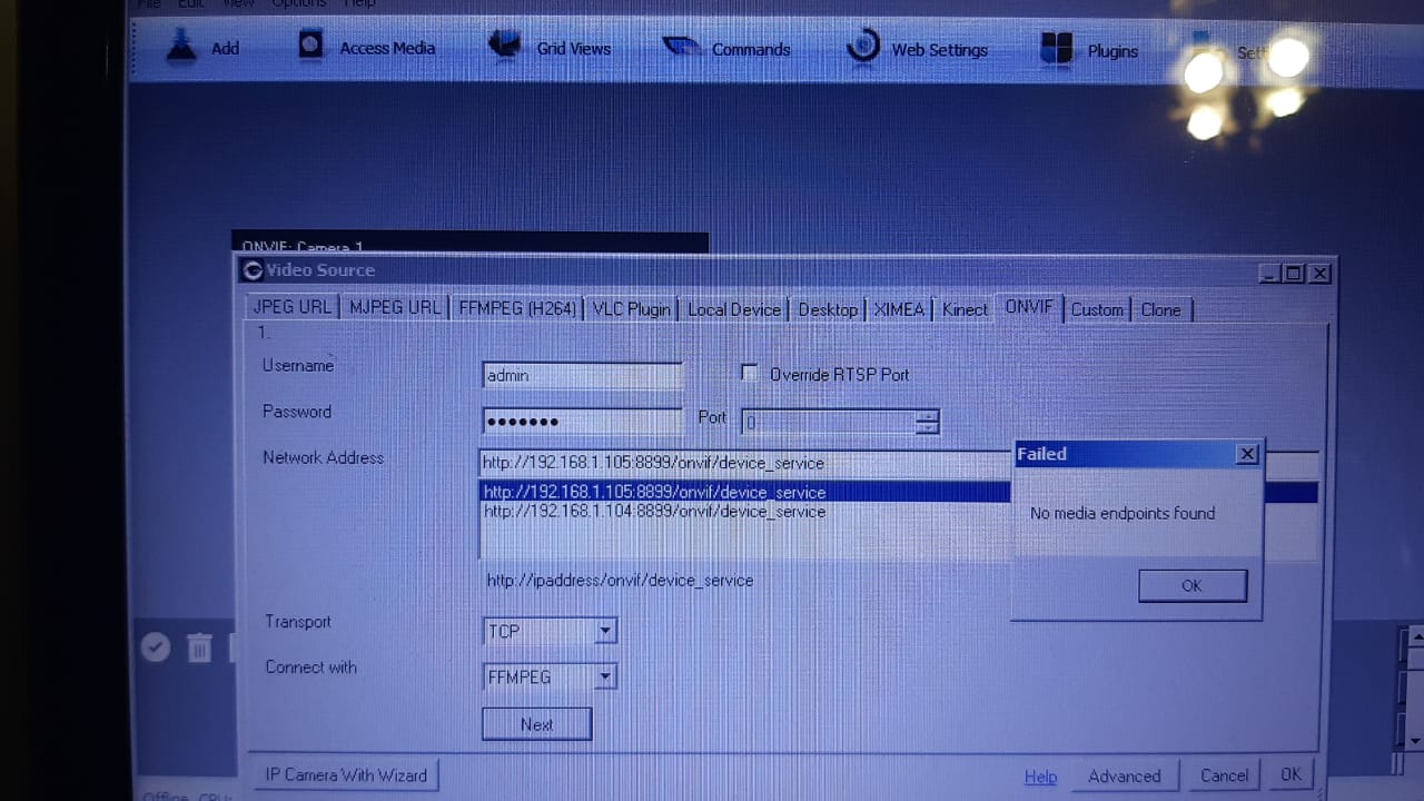

iSPY can see my cameras, but cannot show any images:
I tried do config it through the ONVIF tab and in the FFMPEG tab, but no juice.
I don´t know if it's a issue with the link.
I tried a lot ok links. With these shown in the iSPY and rtsp://user:password@ip:door, but no luck. I used 2600, 8899, 80 as doors, but got the same error everytime.

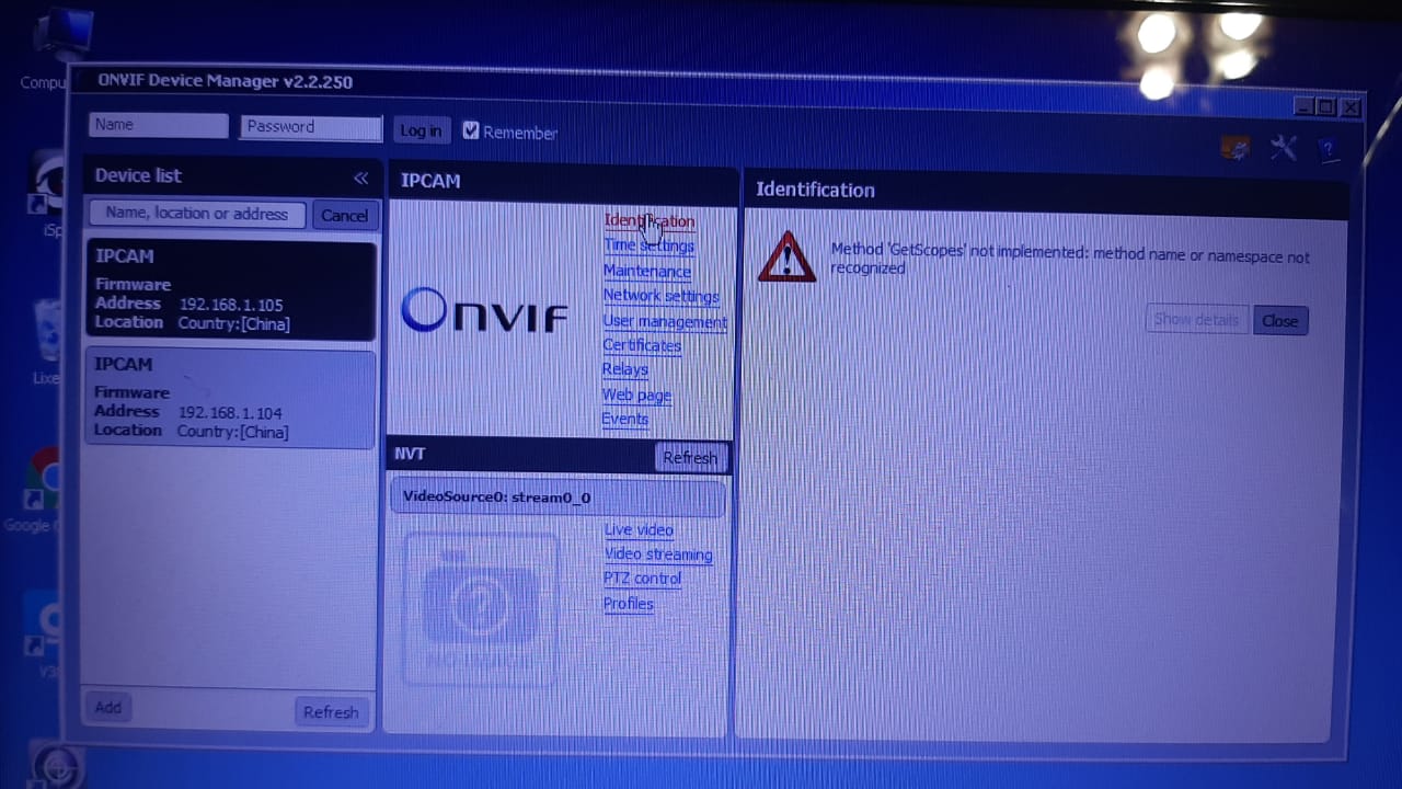

I've tried the ONVIF manager, but, strangely, it cannot show any data of my cams:

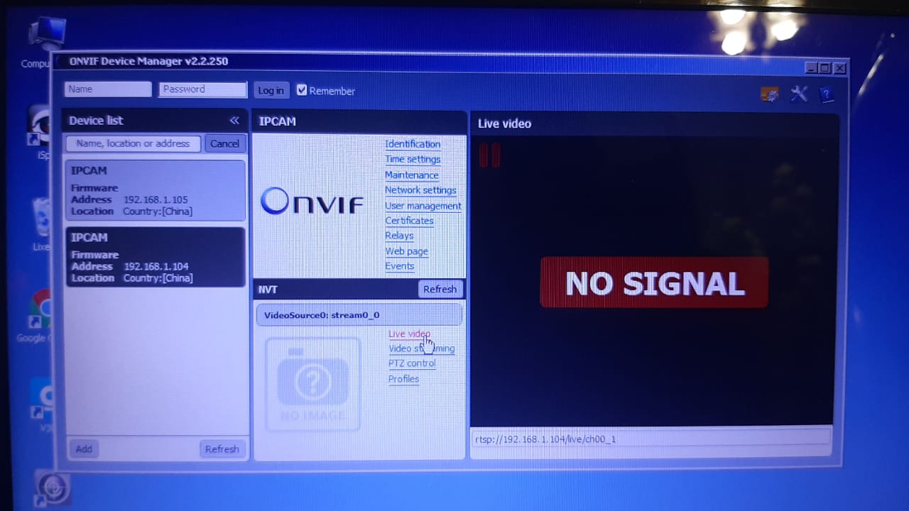

Can't show live video:
So, i don't know what to do anymore.
The cams are working, since I can see the images through V380 app.
So, you guys have any ideias what am I doing wrong?
I don't think we can add anything.
Except to say that we see an increasing amount of IP cameras (typically those sold on Amazon & eBay) that will only work with their own App :(
