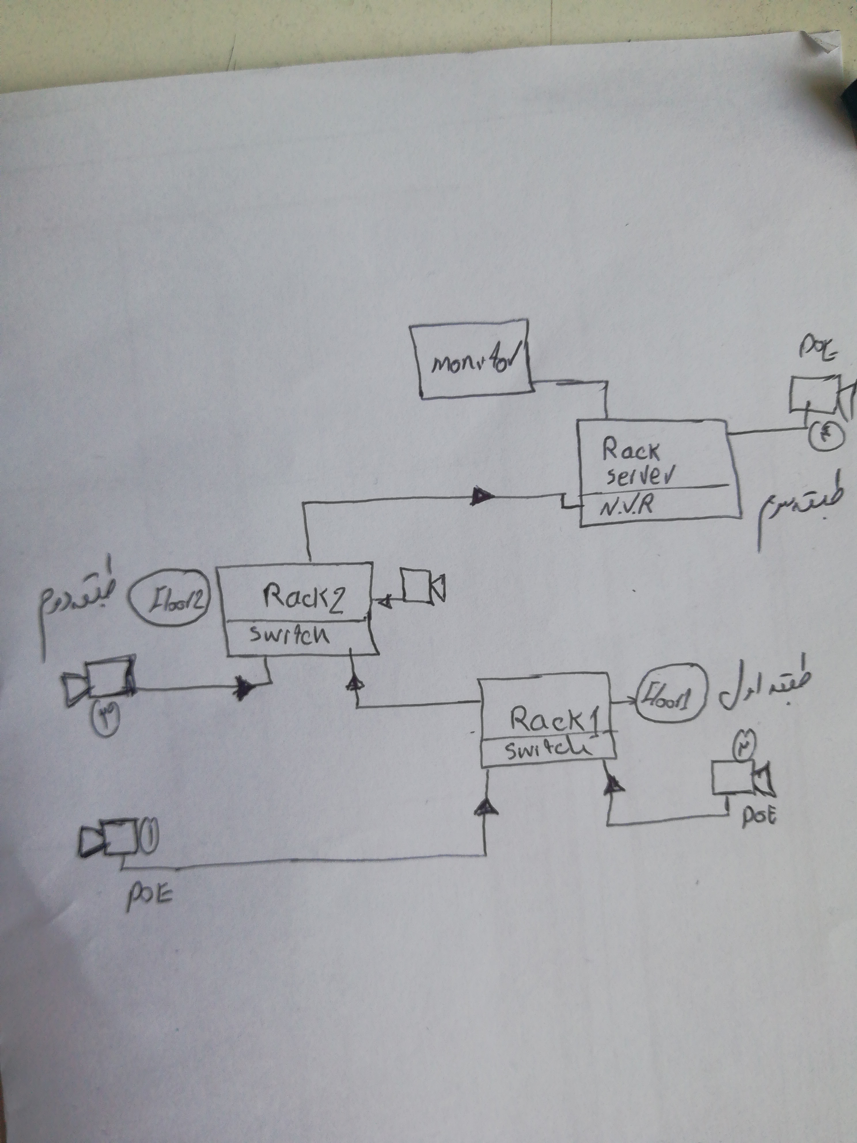

Hi dear..I wonder if I could implement my IP CCTV like picture that I attached..and is it possible to say porns and cons...or I have to wirings cable's IP camera straight to server's room.. thanks in advance
Kindly help..

Hi @Alimamz
That system looks fine to me, as long as the central rack with the NVR is connected to the router then those other racks are just daisy-chained from that central rack, which shouldn't be a problem, and they should all be on the same local network.
Thanks for your help...my network switch has to have special features like giga speed or etc ..??
No, shouldn't need anything fancy as it only looks like you have a few cameras on each rack
Yes my network ip don't have special features... All in one thanks for answering my question,
