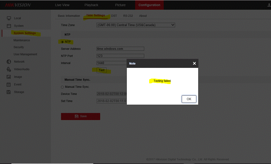

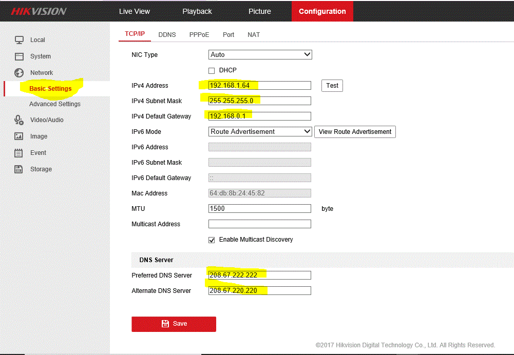

My Hikvision IP Camera DS-2CD2542FWD-IS is having problems with the NTP. I think the camera is having problems connecting to Internet.
Please help me out.
A few notes:
- all my 3 computers use time.windows.com:123 with no issues
- the camera is connected to the same home network through POE switch
- below is fragment of my computer '/ipconfig all' output where you can see the network settings
- below is export of the camera diagnostic
- I'm also attaching the screen captures
- the camera is not able to send emials either... I think due to the same connectivity problems.

Your network address and network gateway are on different subnets. I'd expect the gateway to be 192.168.1.1 to fit the IP address of the camera.
Yes, it was the wrong IPs and subnets.
I fixed the issue by changing the camera's default IP-address from 192.168.1.64 to 192.168.0.64... then, the NTP and emials started to work!
I wish the Hikvision would add a bit of intelligence into the camera or the client software.. it should raise a user alert saying "warning: camera IP-address and getway IP-address are not on the same subnet"
BIG thanks Magic919... this is a great forum!
