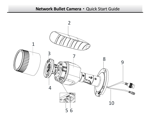

The micro SD is inside the camera housing. In order to get the front cover (1) off it needs to be unscrewed.
However, underneath it has a tamper seal on the seam of front and rear housing (1+7). So any unscrewing will tear the tamper seal.

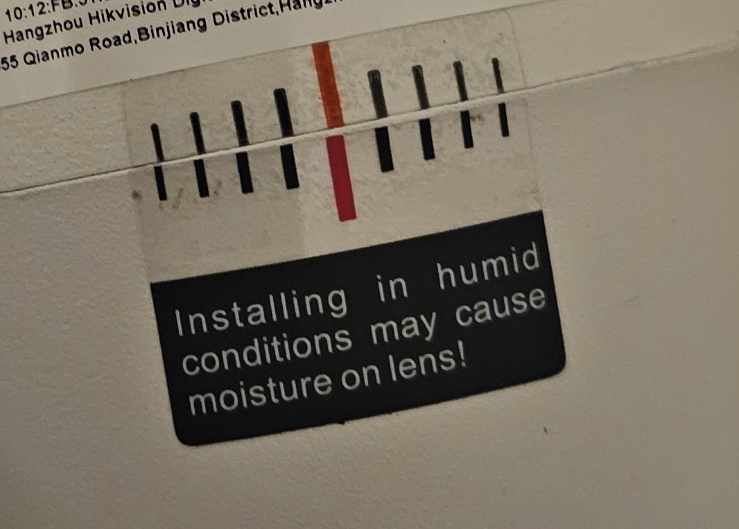

I've never experienced a Hikvision camera that has a tamper seal, does the seal have Hikvision branding? It might have been stuck on by whoever supplied you the camera.
If the only way to access the MicroSD card slot is to unscrew the front of the camera then this definitely wouldn't void Hikvision's warranty because if it did it would make the MicroSD card slot unusable.
Thanks @ekkostar
This is not a tamper seal, I can clearly see the label is already split in two.
This label is purely to help you align the lens cover when unscrewing and screwing back on.

I noticed that on a zoomed photo but it was not so clear just looking at it.
So, you think I could just unmount the camera, unscrew the lens cover off and leave the two halves to dry near a radiator. That should resolve it pretty quick right.

For the schematics it looks like straightforward access to the inner of the lens cover. Hopefully, that's all that is needed.
