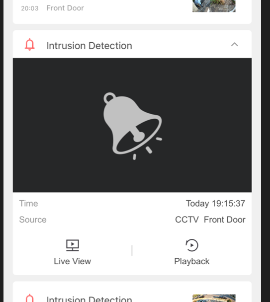

- HK App

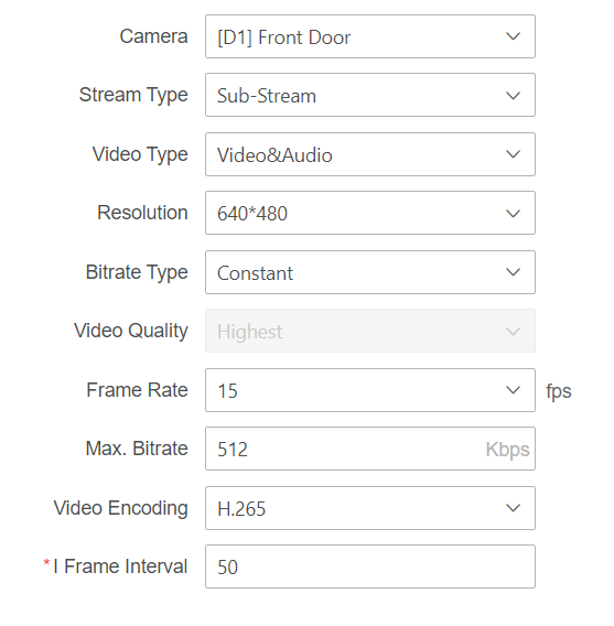

- Viewing the video of a triggered event doesn’t work 95% of the time – buffers to about 50-90% and stops. Manually forwarding the video sometimes works but not always. This happens even when connected to local network. Broadband on average is 365Mbps down and 37Mbs up.

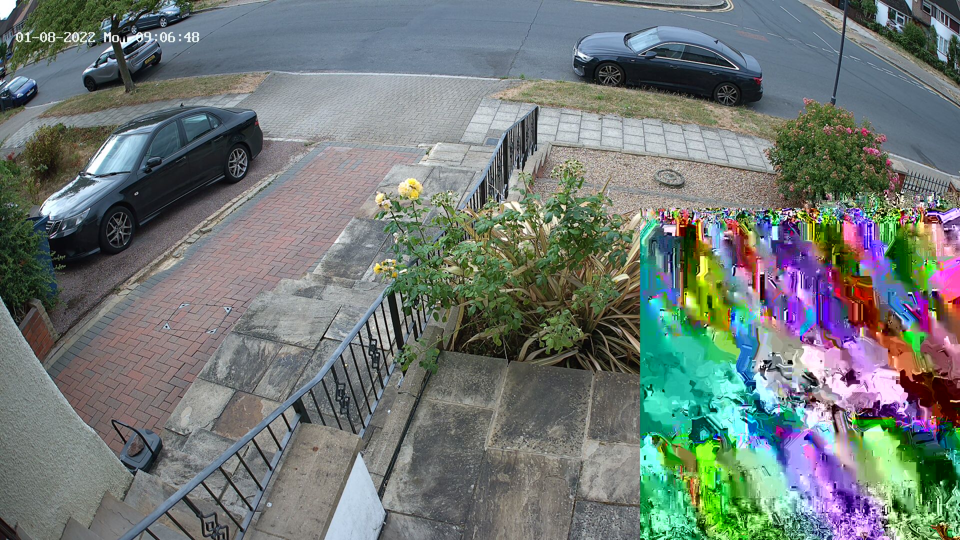

- Sometimes the recorded video contains sections with what looks like fuzz/noise. See the “Fuzzy Recording.jpg” capture. This happens 2-3 times a day and lasts for 1-2 seconds.

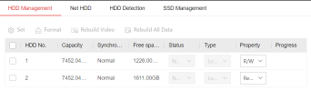

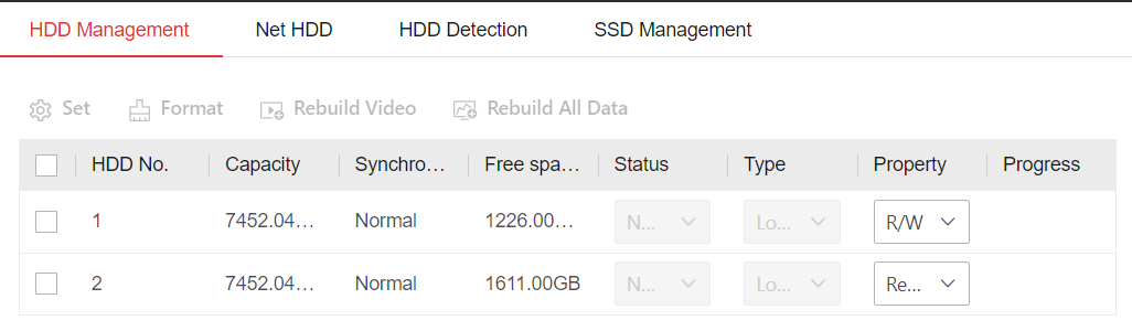

- Should I just have both HDDs set to R/W in storage settings? (I seem to think it might decrease load on NVR)

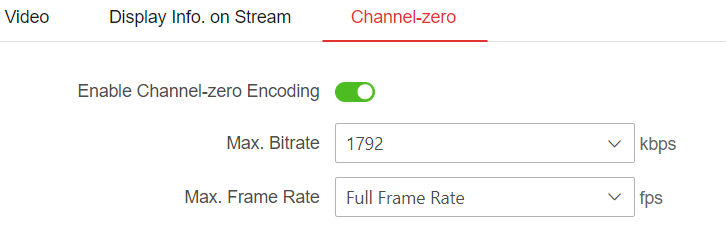

- Does Chanel Zero have any benefit for me? I enabled it thinking it might make live view on HK app smoother but subsequently read that it only works for admin user?

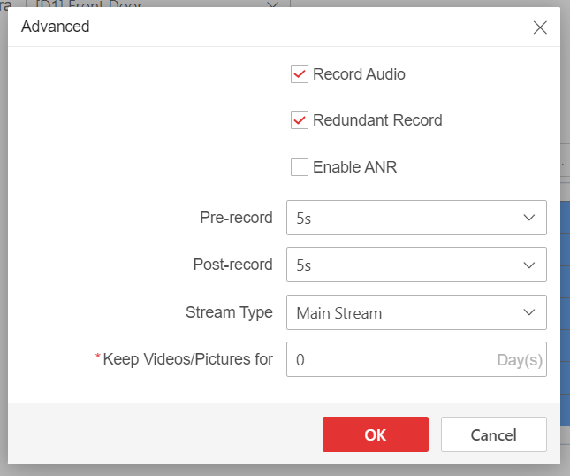

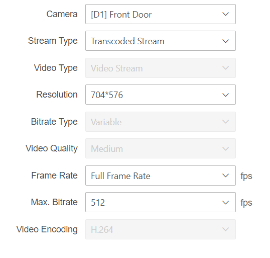

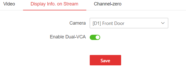

- Should I just turn off continuous image capture?
