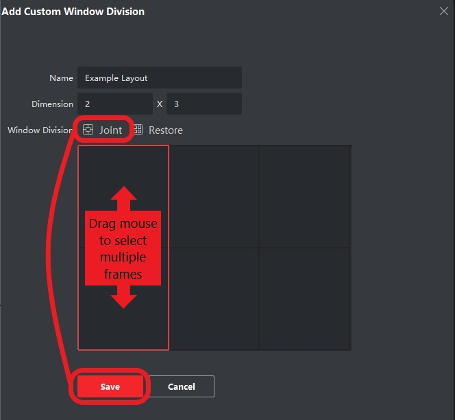

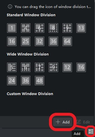

Then, in the bottom-right corner of the "Main View" page, you can create your custom view, and merge multiple windows together to create a larger one if you like:
View attachment 6291View attachment 6293
When you select any view (custom or default), you can then move a camera to a different window just by dragging and dropping it there, which is the way to rearrange the view.
