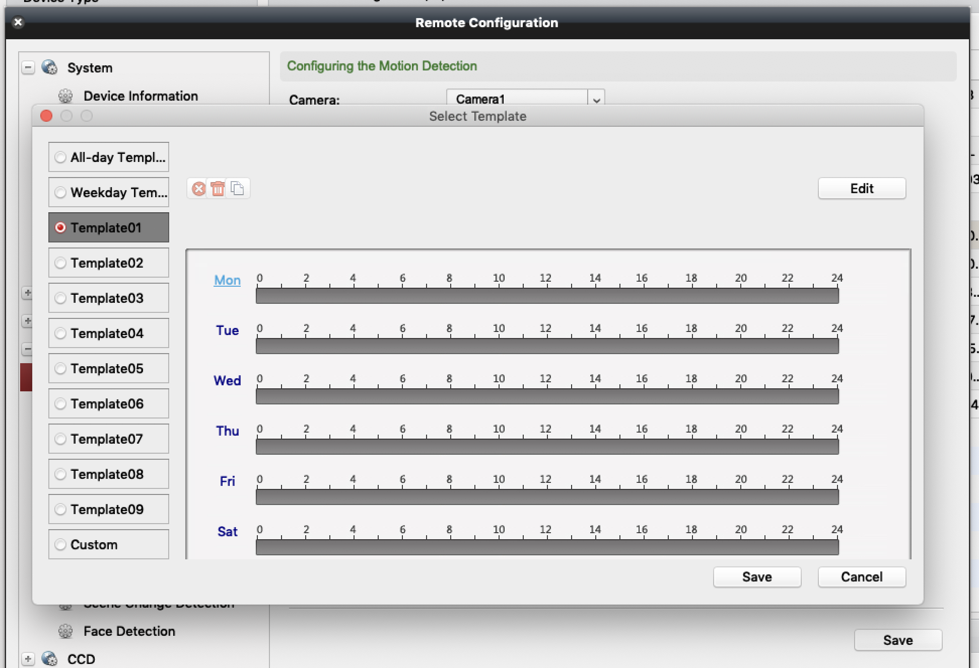

Are you selecting one of the schedule templates? (see below)
The All-day and weekday templates are fixed and cannot be edited, if you need a custom schedule you need to select one of the blank templates and then you should see the edit button at the top right to set the schedule.

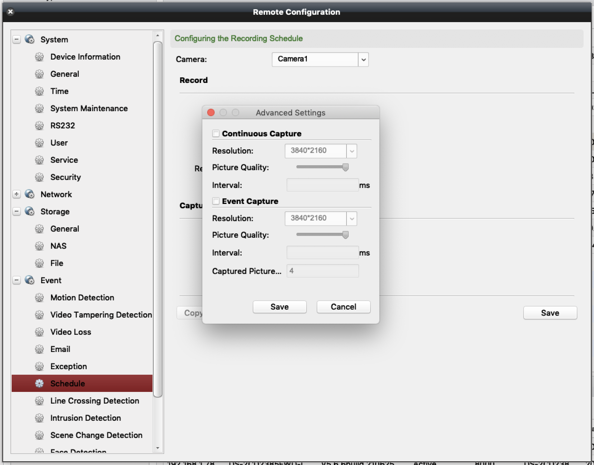

Also on the storage schedule tab in Ivms-4200 what is the capture schedule for ? I have event template in there.

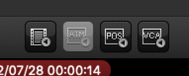

If you then go into Playback and select the camera that has Motion Detection set you should see these options just above the playback timeline:
The left-most one is Event Playback and this will allow you to search for motion detection triggers in your recordings.
Capture schedule allows you to set up still captures on a recurring schedule, it is often used when people want to record a time-lapse because you can get a scheduled still image every hour and then export all those stills to edit them together into a timelapse. You can also set captures to be saved on event triggers (see below screenshot).

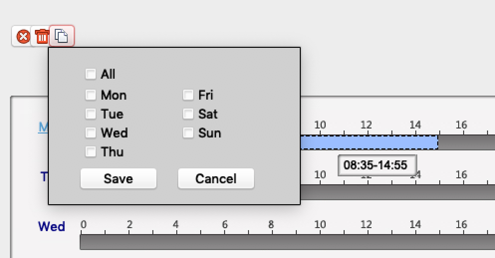

You are correct, there seems to be some kind of display issue, the Sun schedule line is there and it looks like you should be able to scroll to see it but the page won't scroll to display it.
If you need to set a unique schedule for Sunday you can set that schedule on one of the other days and then click the 'copy' icon in the top left and copy that schedule to Sunday.
