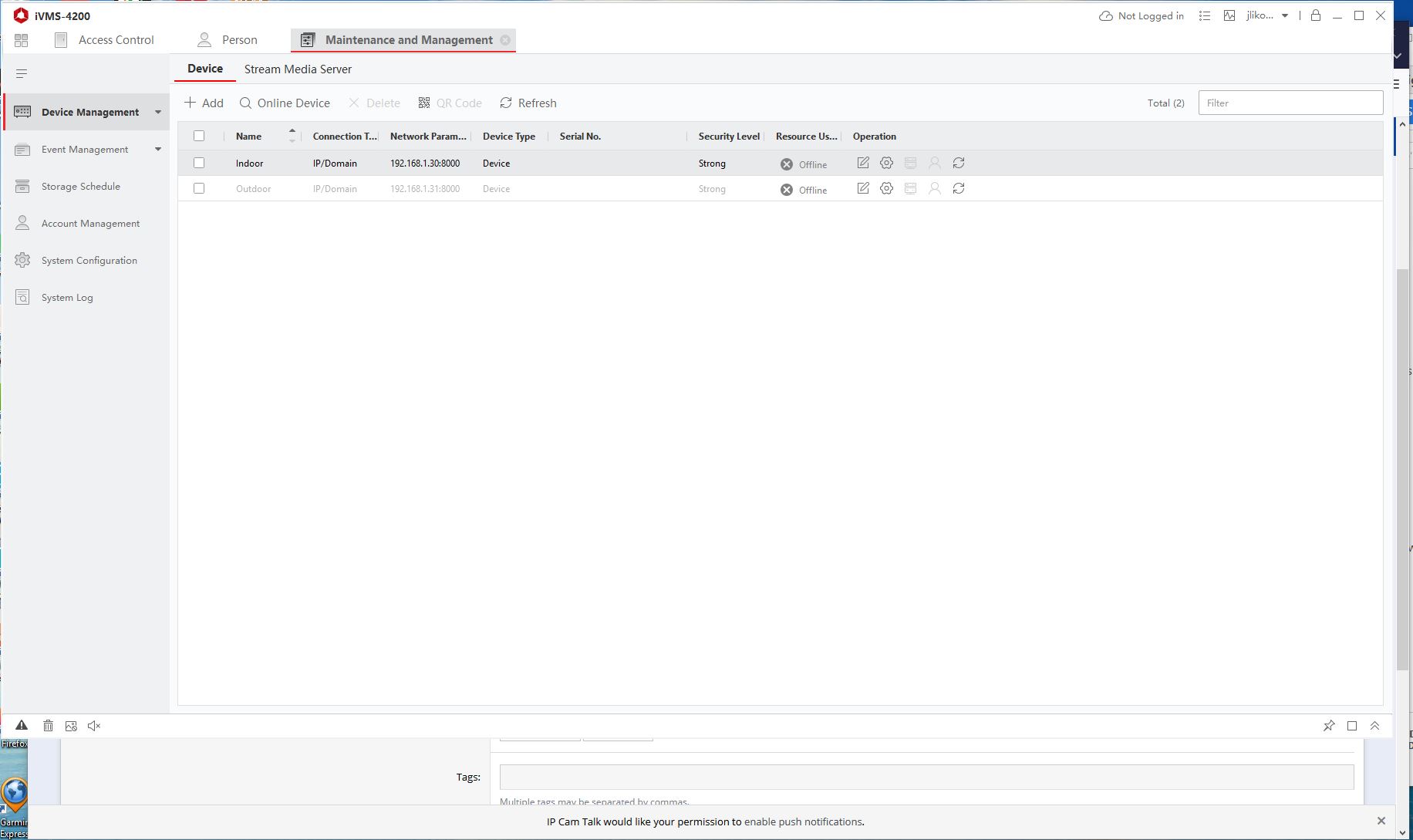

My problem is that iVMS-4200 (v.3.1.1.13) finds both indoor and outdoor units but for some reason they both are offline. I can connect to www.hik-connect.com and I managed to add the indoor unit DS-KH8350-WTE1. It is online. Also the Hik-connect app on my smart phone is working so I can see the video recorded by the outdoor unit DS-KD8003-IME1.
When installing the submodules I set up the addresses ("1" for the card reader and "2" for the keypad). I have defined username/password for both units. I can click "Edit" button in Operation tab (on iVMS) but when I click "Remote Configuration" button I get a message saying "The device is offline" (see attached sceen copy). Both "Device Status" and "Online User" buttons are inactive. Any ideas what I'm missing?

I installed iVMS on another computer running 24/7. One thing which I noticed when adding new devices was that I get an error message saying wrong username/password. I get this error message after I have clicked "Add" button. Clicking "Add" button opens a new window where you give username/password.
I wonder whether this error is keeping my devices offline. I have no ideas where I can define username/password. I'm getting somewhat frustrated with this Hikvision system. I have quite lot of experience in home automation systems and Hikvision seems to be one of the most difficult one to setup.

Thanks Dan. In fact I have now managed to solve this offline problem. The reason was that I was using wrong username/password. When using "admin" account I managed to find the correct password for both units. I have to say I'm now really confused about username/password.

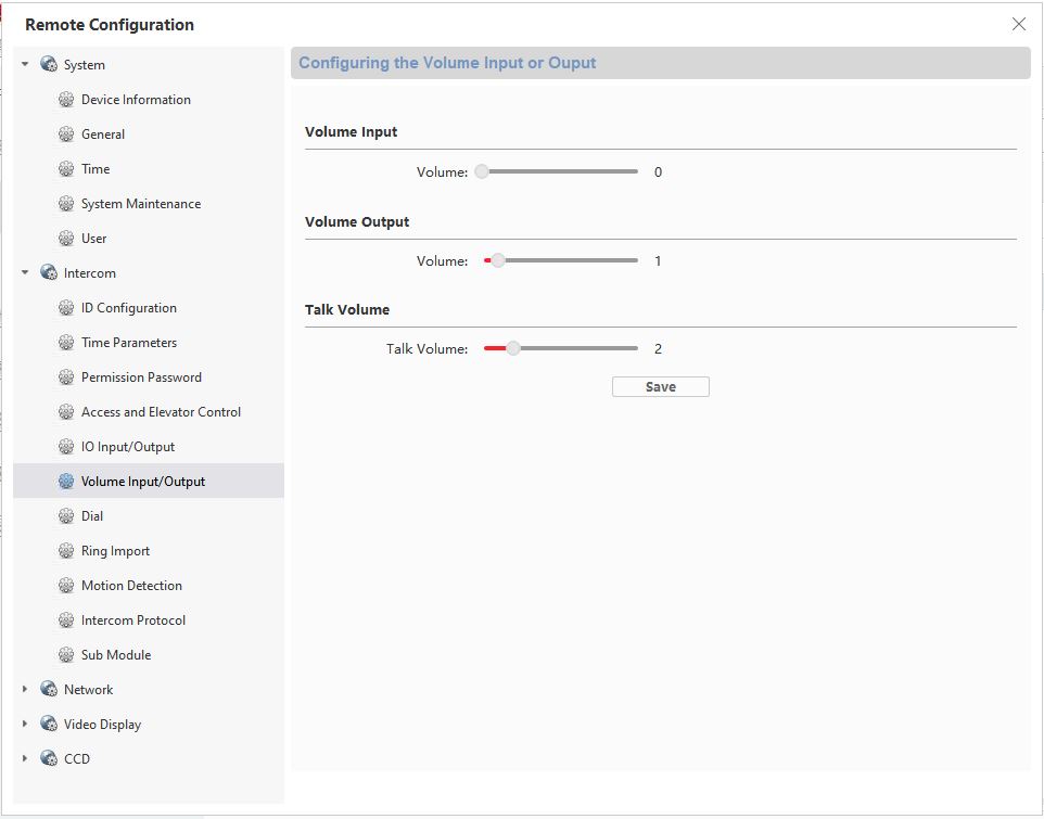

I have now watched carefully this video and it has solved quite many issues. There is still one thing which I haven't managed to solve. I would like to disable the keypad tone, i.e. when pressing any key on the keypad. I have tried to adjust the sliders on iVMS4200 (see attached file) but this hasn't helped.
