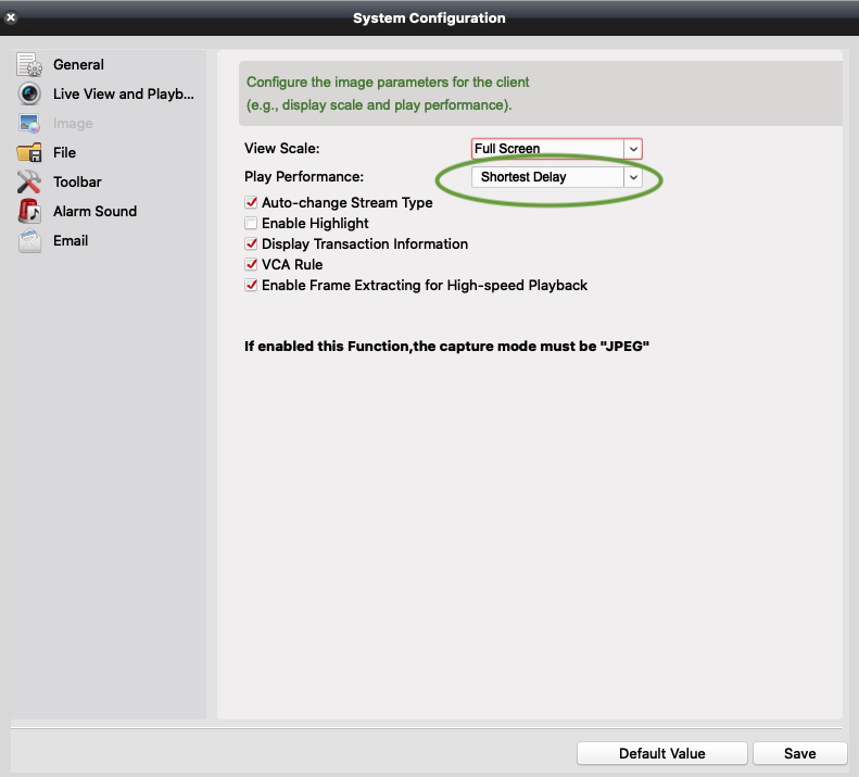

B BerkoJas Member Messages 15 Points 3 Aug 10, 2022 #1 On my Mac the iVMS-4200 was putting a very high load on the CPU. This may be a well known tip but I cut the CPU load by 50% by setting in the iVMS-4200 app, System Configuration -> Play Performance -> Shortest Delay It defaulted to Balanced Attachments iVMS-4200.jpg 137.7 KB · Views: 986
