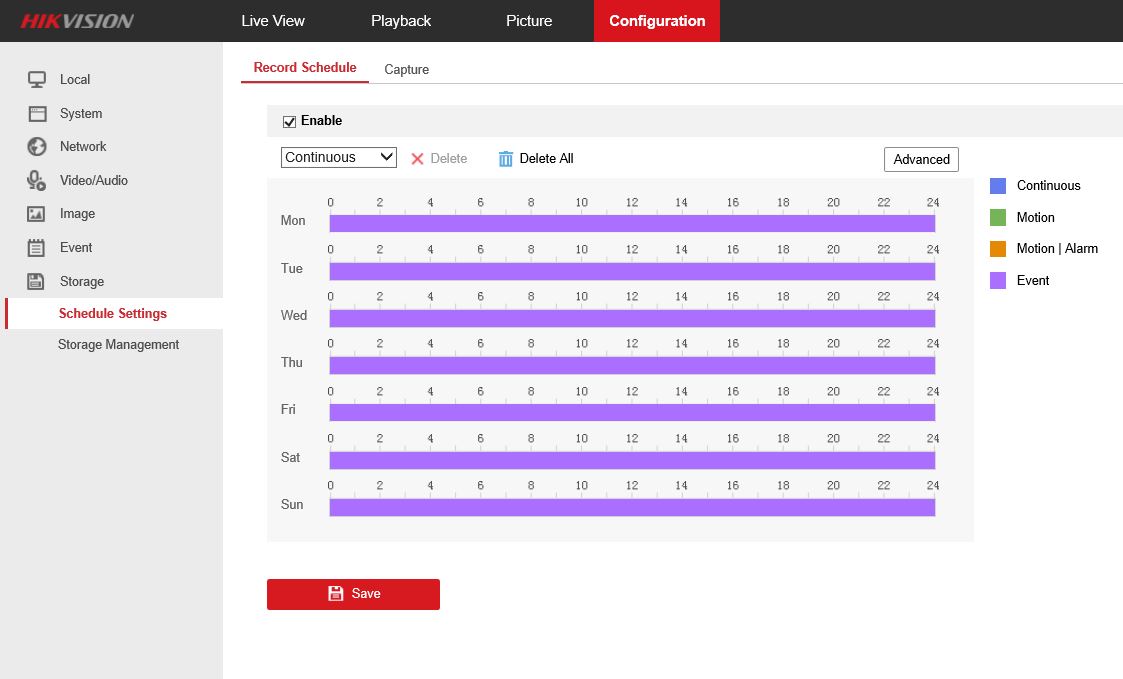

I've moved monitoring services and the new service required me to setup events on the cameras to use for their platform, which has led me to discover some issues I'm having with iVMS. (The previous monitoring platform I had in place used their own maching learning to discover events.)
The issue I'm having is that there is no record file being generated from smart events.

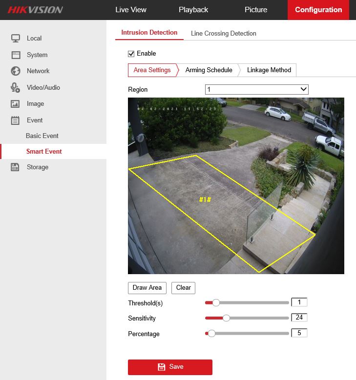

Previously I used the basic events enable motion detection linked to trigger recordings, which worked fine. But due to amount of false alerts I was getting in the new platform I changed these to smart events, which appear to be triggering nicely and has cut down about 95% of the alerts I was getting with basic events.

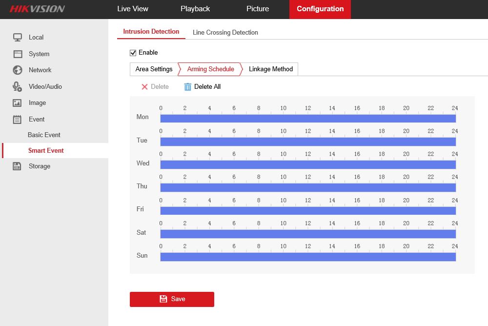

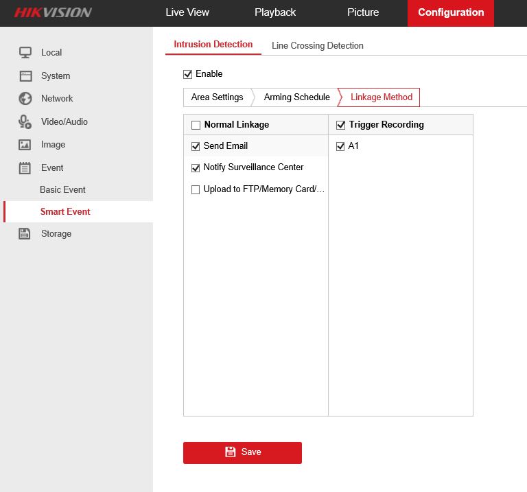

The smart events arming schedule is constant full time, the linkage method is notify survillance center and trigger recording A1.
Also in iVMS underneath the date picker calendars it says 'Today:' with nothing else, should this show the date/time?

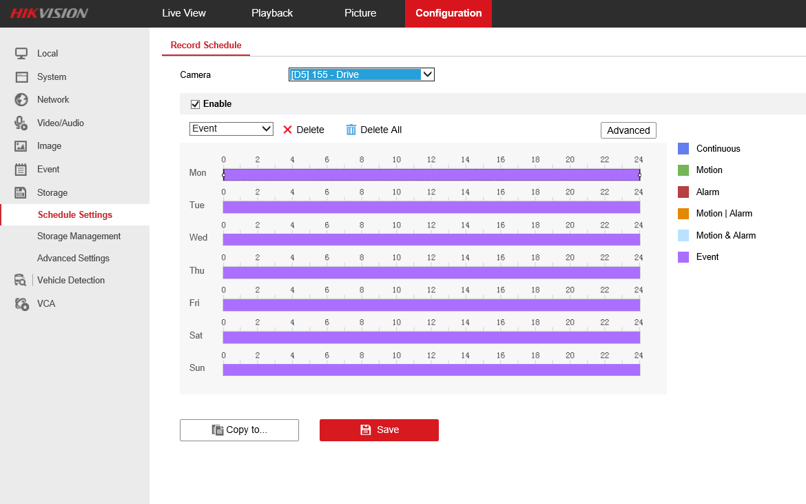

All cameras and NVR were rebooted. All the cameras show correctly in iVMS main view, all have the right date, all are setup for event recording, all events are correctly triggered, iVMS correctly shows the alerts.
If I change the recording schedule from event to continuous a recording file is correctly recorded.
Am I missing something out?
Thanks in advance.

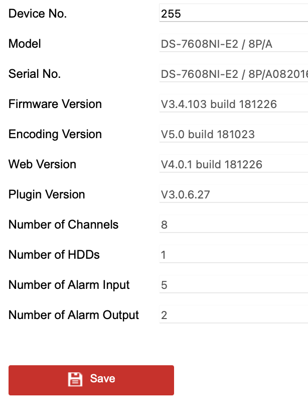

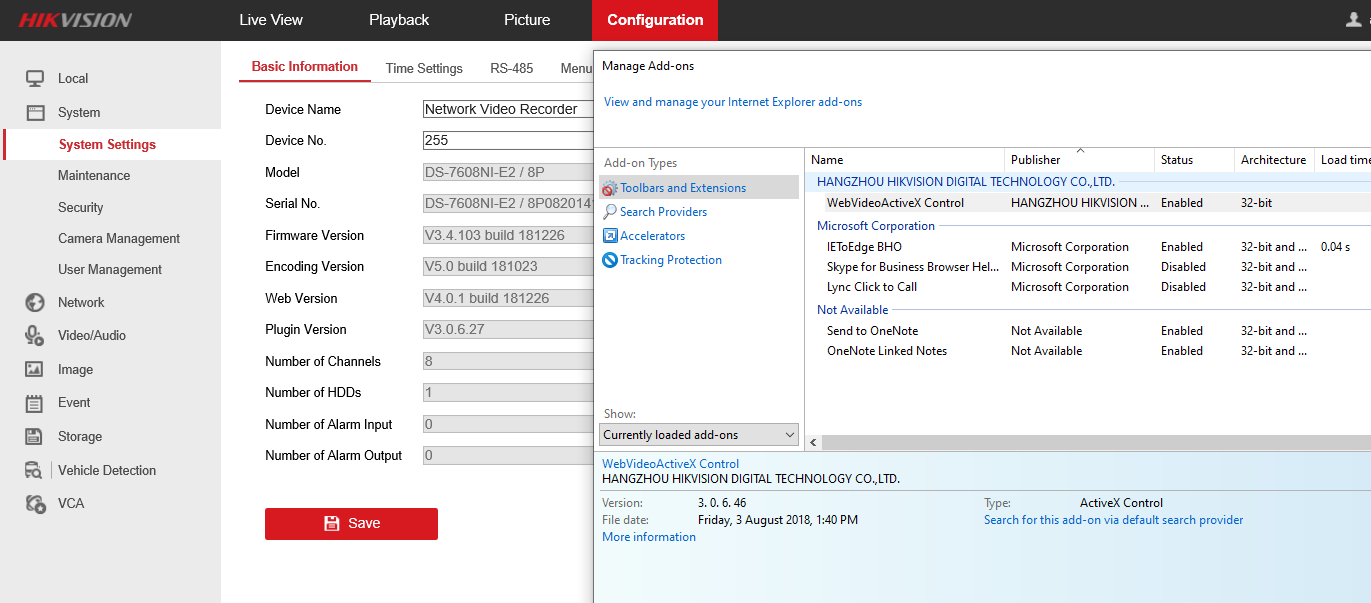

iVMS 4200 - v3.4.0.10 build 20201214
NVR DS-7608NI-E2 / 8P - V3.4.103 build 181226
5x DS-2CD2332-I - V5.4.5 build 170123
2x DS-2CD2342WD-I - V5.5.82 build 190220
