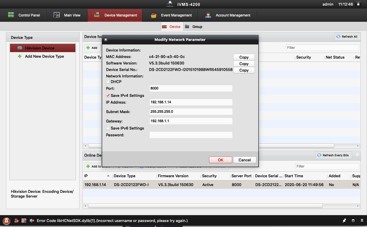

Well I did a clean format on my MacBook Air last night and I have the following issues with my iVMS 4200
First I download the new version of Catalina
I created the superuser and the password. It recognized the camera the error that I get is error code lib hcnetsdk.dylib incorrect username or password. I tried to use the SADPTool but without any luck. I don't even remember the last password before the format.
While I am trying to modify the IP I get the following error - Error Code libHCNetSDK.dylib[7](Connecting to device failed. The device is offline or the network timed out).
Well, any help on this?

Hi @DinosMa
Are you seeing the camera in the SADP tool? Could you share a screenshot of this, please?
Where did you create the superuser and password?
You won't be able to change the IP address in iVMS-4200 without the password field being filled in.
If you can't remember the password, you'll need to reset the password using the below guide, or perform a hard reset on the camera to its inactive state so that you can set the password again:
How to Reset the Password of your Hikvision Camera/NVR in 5 steps using the SADP Tool
How do I Reset a HikVision IP camera using the pushbutton?
Once you have access to the camera in an internet browser, you should update the firmware to the latest version too:
HikVision UK Portal: Firmware for R0 platform(2xx2) - V5.4.41 170312
Our guide to updating firmware: How do I update HikVision Firmware in just nine simple steps?

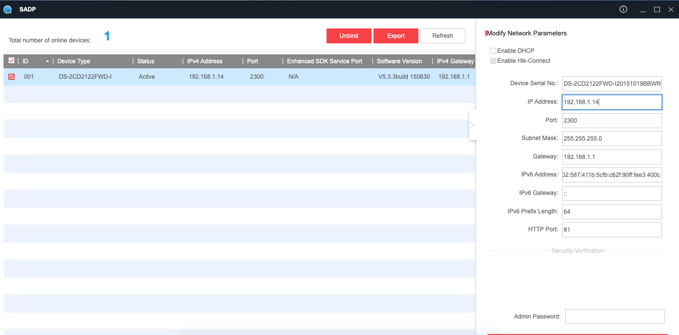

Hey again
Now it saw again the camera SADP tool ...

No problem :)
What are you doing or seeing when you're unsuccessfully changing your password?
The superuser password will only be for iVMS-4200, adding to the camera to iVMS-4200 and editing settings SADP requires a different password, which you will have set up when first activating the camera.
Did you see the password reset guide linked in my last post?
