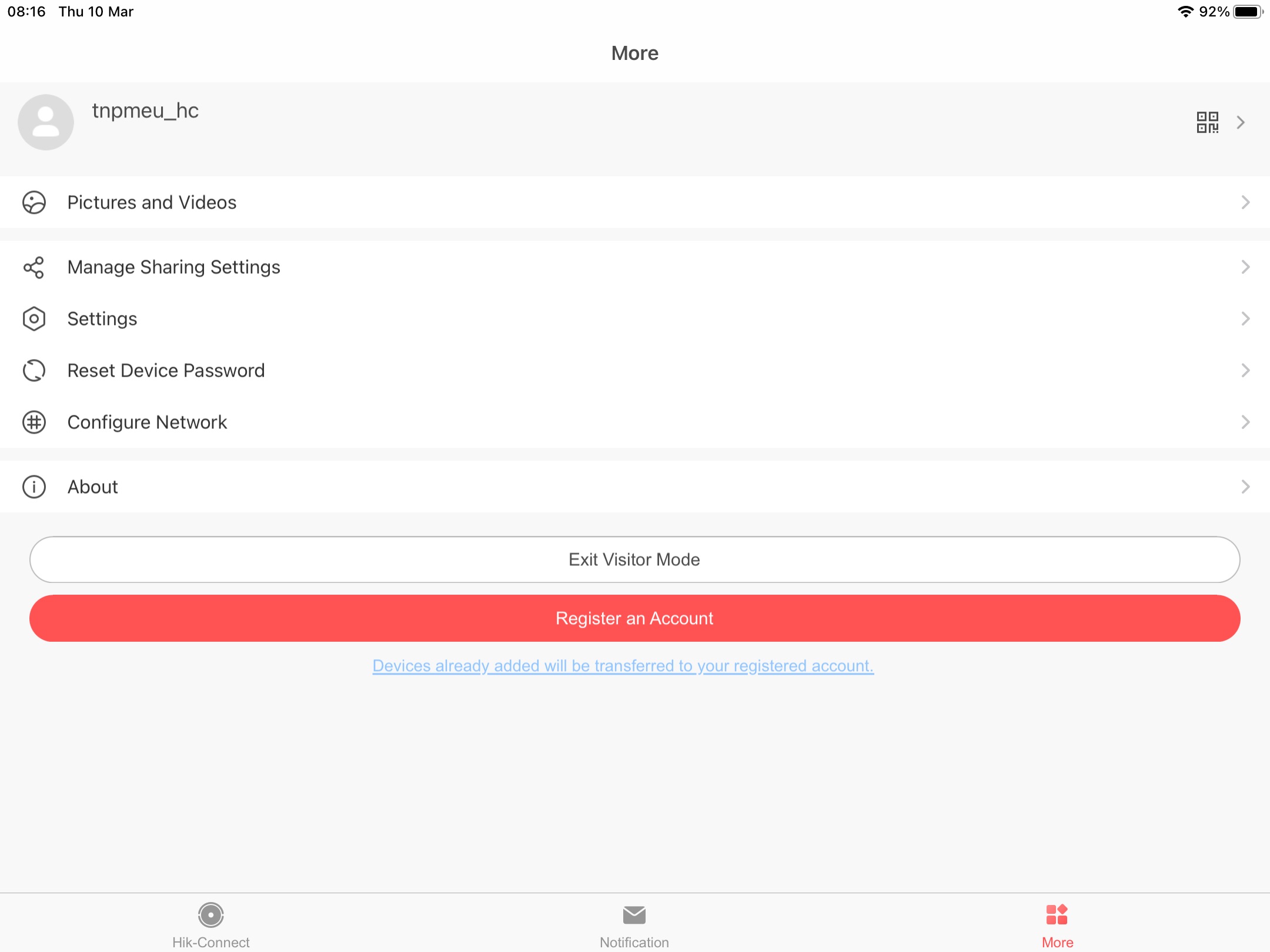

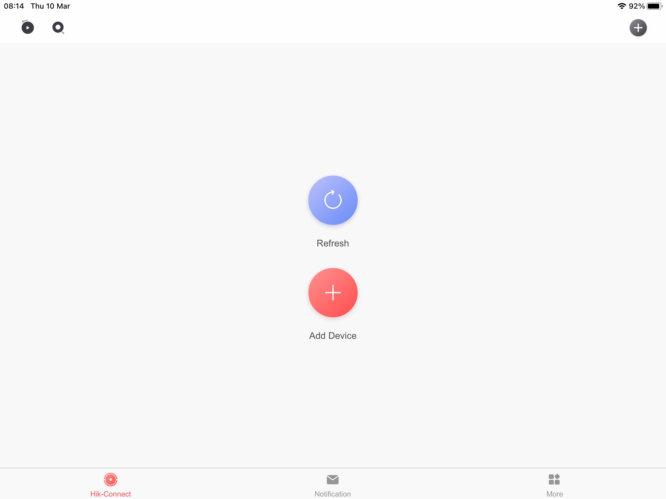

But I just can't see how to connect the other half's new iPad onto our Hikvision CCTV system. To repeat, the iPad is connected to our router and in that regard all works well. And I have downloaded the Hikvision iVMS-4500 app. But when I click the icon I get the following screen (Image1.jpg) I don't want to "Add Device" and so then I click More (bottom right). When I do that I get Image2.jpg I have gone further than this (Settings) but just feel that I am in totally the wrong place. Any help would be much appreciated. Thank you.

Find the "Devices" page on the iPad that is setup and working, and post a screenshot of that. That will show if the working iPad is connecting directly (Direct IP) or using the Hik-Connect service. I suspect it will be using Hik-Connect, if so, follow the guide I already linked which details how to add devices using the Hik-Connect portal and device serial numbers.

Thank you. When you say "select Manual Adding" do you mean that I need to click the "Add Device" option in Image1 as shown in #6 ? I do have a record of the password. I noticed that in Image3A in #9 that it says "Camera No. 3" Do I have to do this for each camera ?

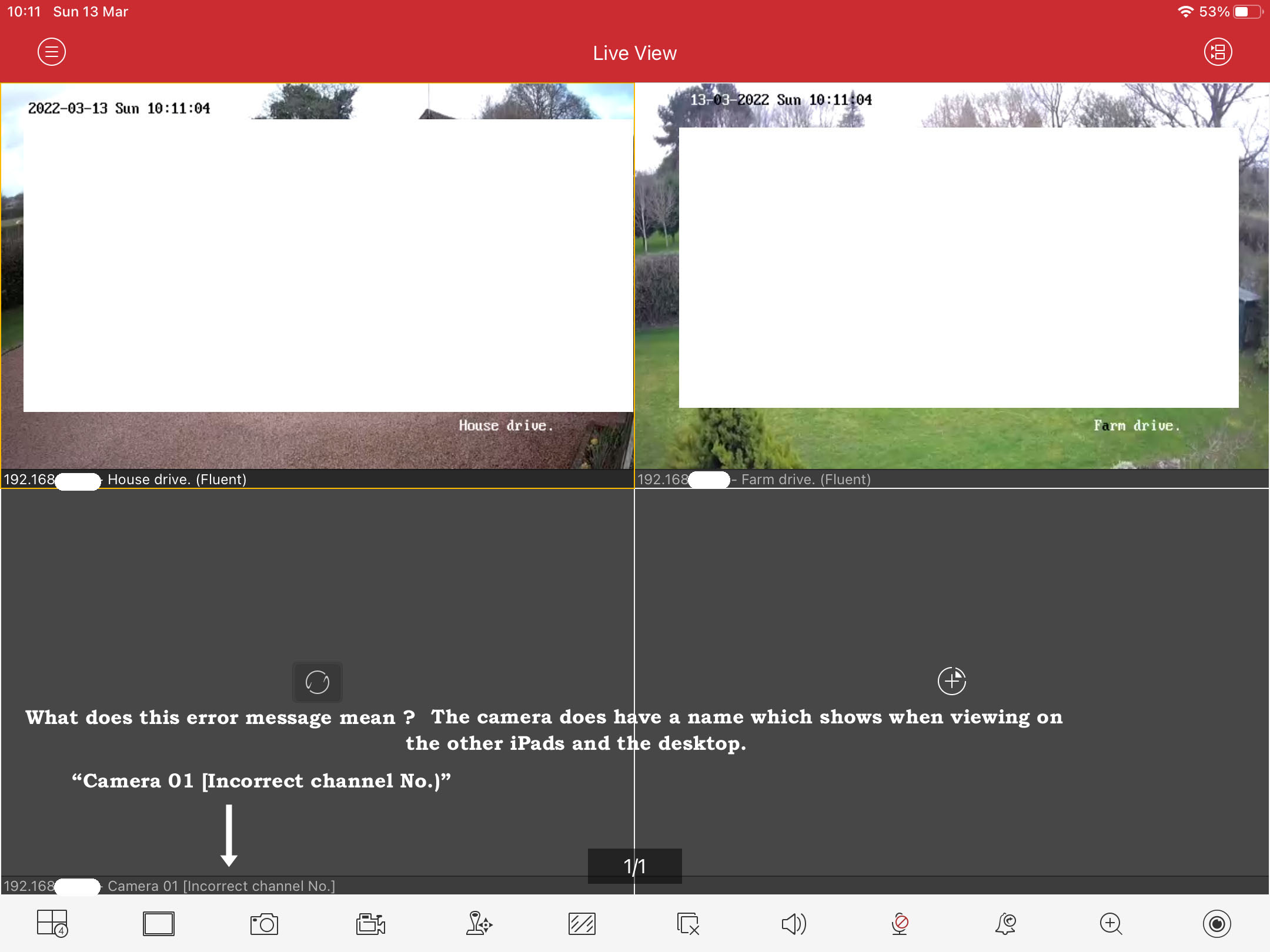

We have made progress ! Everything that was on the old iPad was copied onto the new one and I was told that if I went into the App store and looked at the "Purchased" option I would find iVMS-4500. And sure enough it was there. And so I now have our camera system on the new iPad running on iVMS-4500. So far - so good. BUT. I have only got our 2 dome cameras to work on there, I can't get the PTZ to work (we have only got the 3 cameras altogether) The image below shows what can be seen on the screen. I have partially deleted what I think are the IP addresses for the NVR but they are all the same and are correct.
Can anyone tell me please what I need to do to get the PTZ showing on the screen ? Thank you.
