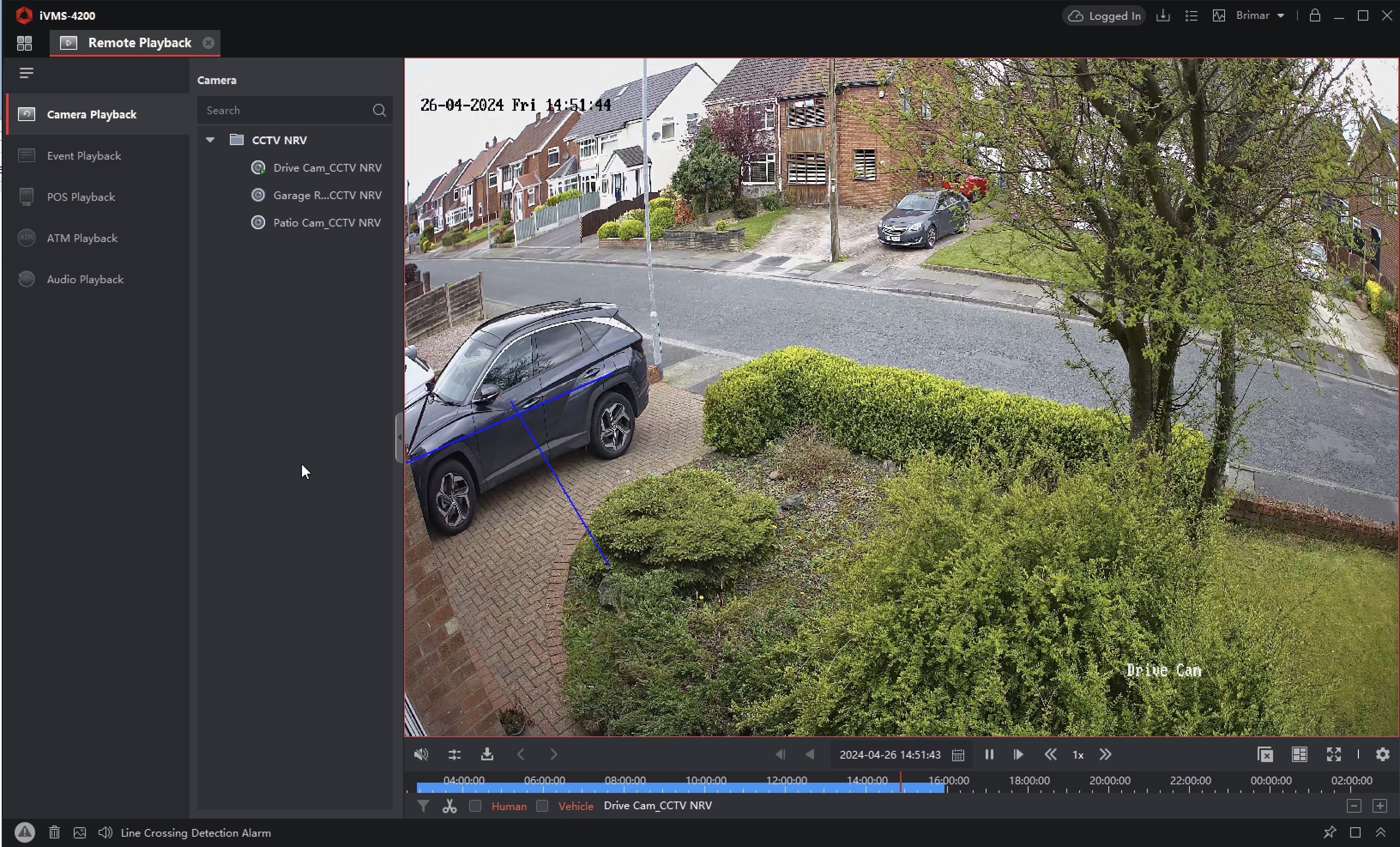

The only problem I have now is searching a camera between times, say for example I wanted to review the video feed on a camera between 13:10 and 13:30 (today) on the older Mac app I could go on remote view, hit the calendar button which brought up a 'twin calendar' dialog box where I could choose the dates / times I wanted to review, then select the camera and hit the search button and I'm away.....
The new version does not seem to have any place to enter the dates / times? The text box at the top of the screen which has search in it seems to do nothing?
Or am I missing something obvious?

Try going firstly on Event Playback, select between dates and times, press OK, then go back to Camera playback and perform your rule search.
There is something wrong with dates in new iVMS 3.11.0.5. Camera playback keeps previous search date and cannot be cleared other way than above or logout and then login
Thanks I just tried that. On Event Playback I can indeed set the range I want but when switching to the Camera playback it starts at midnight again and does not respect the time period set. Weird.
