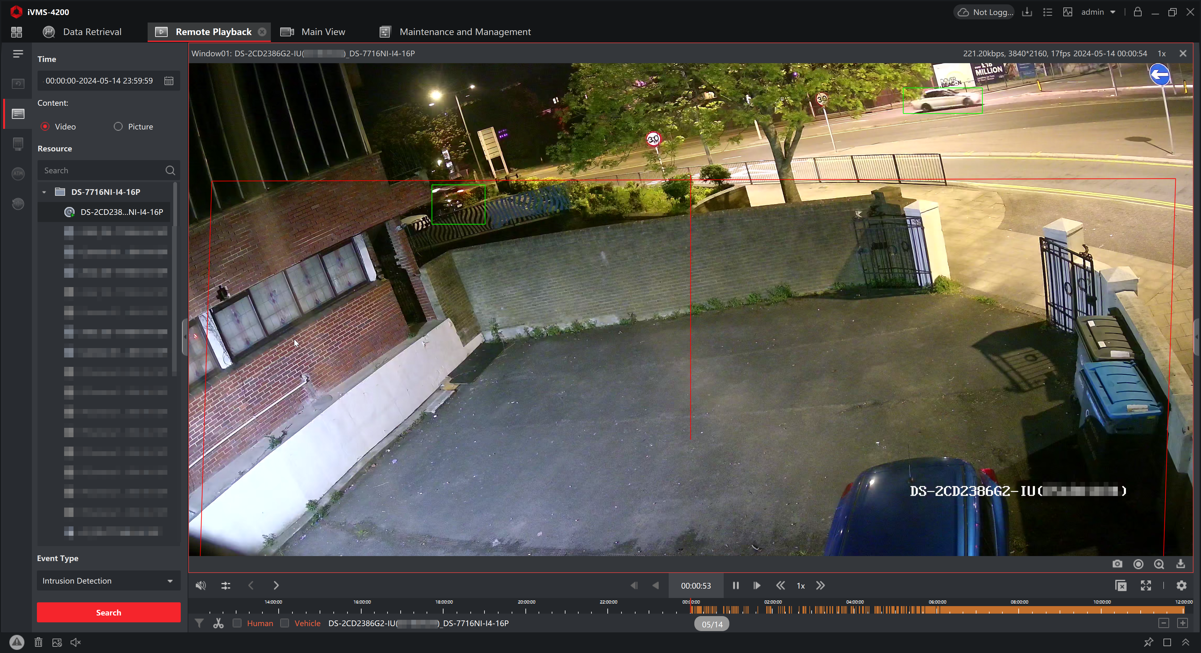

I have installed the latest iVMS version (V3.11.1.5) and VCA Search feature has stopped working properly. It only works if I search for events which have happened today, if I try to search for events, for example, one week ago - nothing happens.
My steps: launch iVMS, go to Remote Playback tab, select one camera, click Play button, pick a date (today - 7 days), click OK button, open context menu, click VCA Search -> Enable Line Crossing Detection, select a region. And nothing happens, video playback continues and no events are found. This feature was working fine on the old iVMS version (don't remember which version I had before).

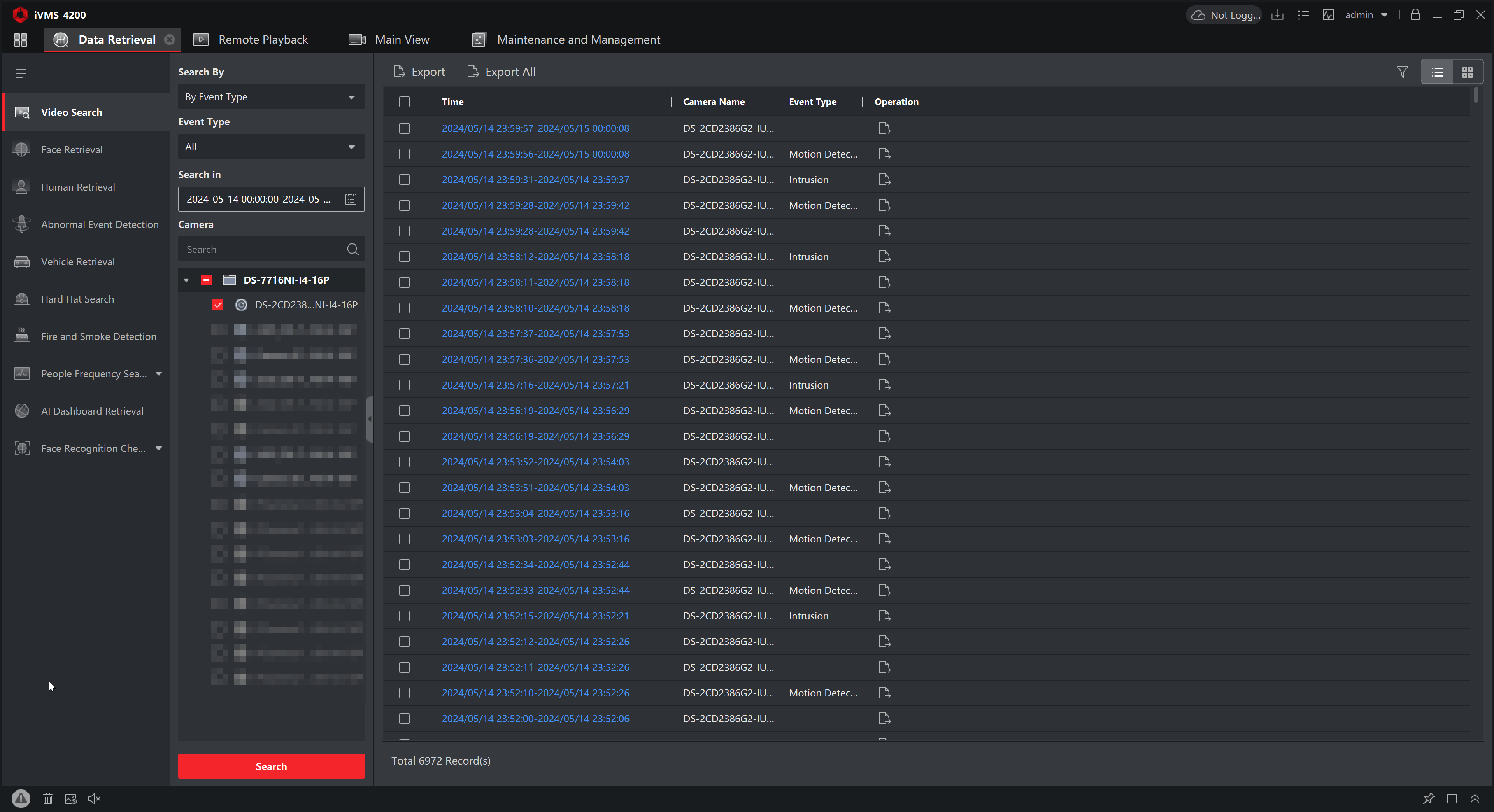

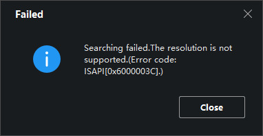

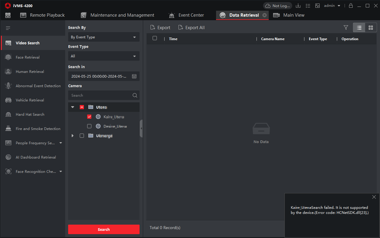

I have also tried Video Search feature and it is not working at all. I always receive "It is not supported by the device" error.
I have not used this feature before, so I don't know if it was working previously. My steps: launch iVMS, go to Data Retrieval tab, pick Search By -> By Event Type, select one camera, click Search button. After that I always receive the same error as you can see below.
I am testing these features on two different NVRs (NI and NXI), which both have the latest firmware.

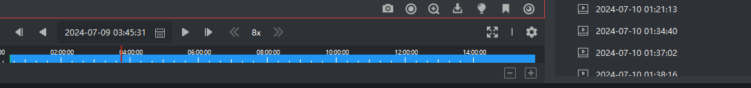

Remote Playback-Camera Playback gives results only for present day and previous day. If going back 2 days ago, search gives results for yesterday. Days before yesterday can be Playback but VCA search returns no results. This is also impossible to select another day if you have not previously closed Playback window.
The only tricky way to force find previous days events, is to go Remote Playback-Event Playback, do a search on your Camera(NVR), find results for Events, then go back to Playback-Camera Playback, perform a VCA search which now magically gives results for whatever previous day.

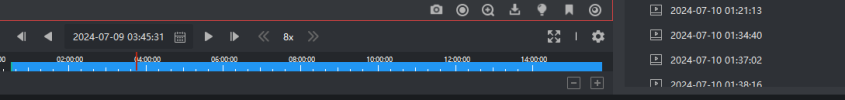

A search by Playback-Camera Playback, now gives no results for yesterday. A search for selected date May 27 gives results for May 28.
Happens only on continuous NVR Camera Playback. Does not happen on same camera event recorded Playback

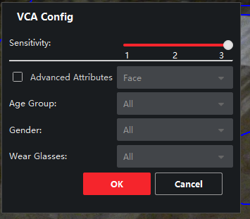

Also closing iVMS or restarting PC, then VCA must be re-adjusted to sensitivity level 3, otherwise there are no results even for present day
