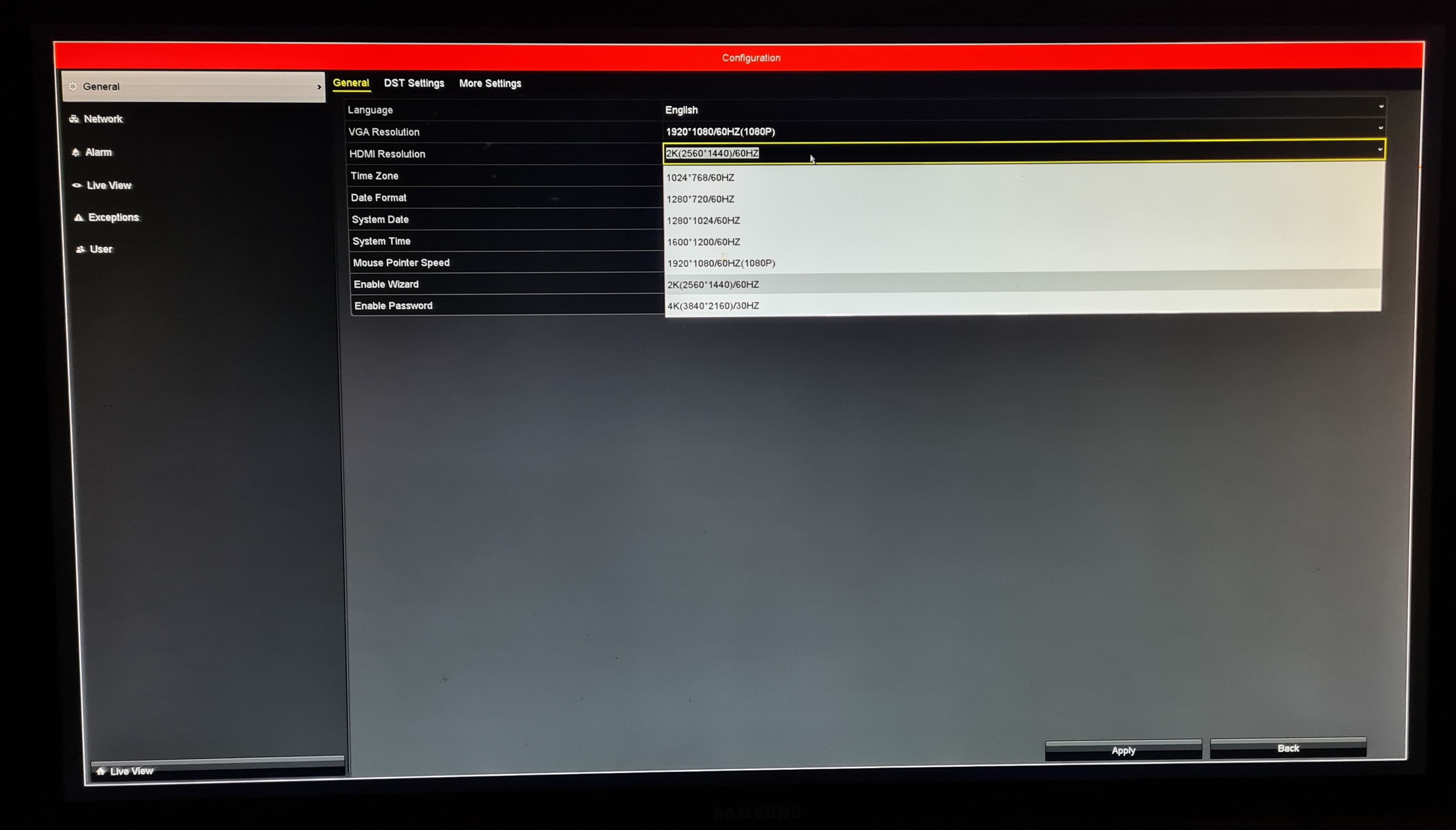

DOH. Find the setting should have looked a bit closer. Sorry for my ignorance
No problem :)
If you could share what you found and changed it might help somebody else in the future, thanks.
Yes no problem Phil.
Remembering this is version 3 software and not version 4.
The setting to change both VGA and HDMI output resolution is found as an option in the General tab of the Configuration menu.
Click on the image below to see.
