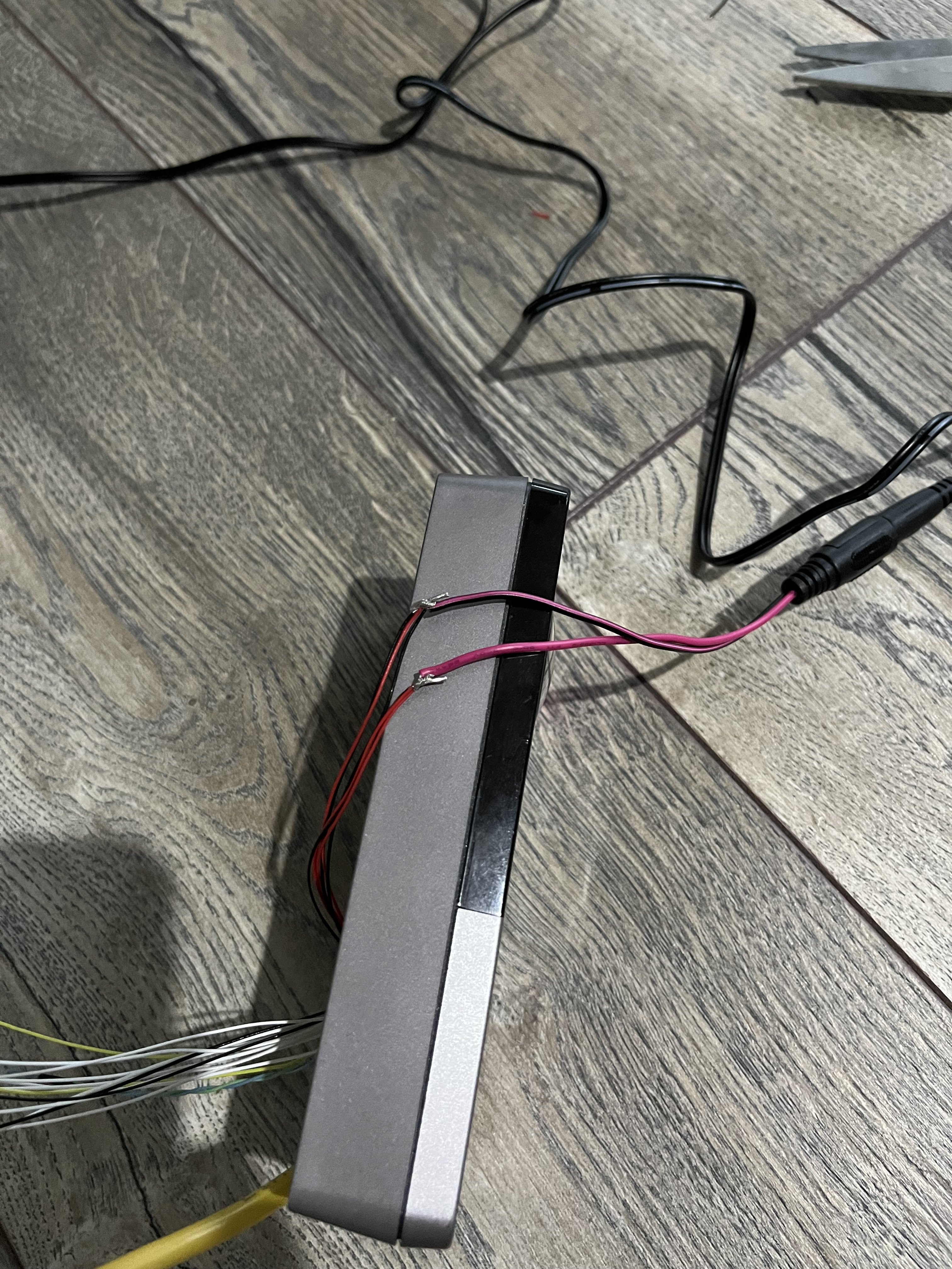

I am needing to reset my doorbell via hikvision due to network changes. Forgot details of course, or cant get admin access.
I have taken doorbell in from gate, plugged in lan to computer (and also tried a switch), and bell is dead and cant be seen in SADP.
What am i doing wrong? I have checked and I understand it is POE. I might vaguely recall having to do some dodgy wire job to a plug to get it going when i set it up?
Solved - but unclear why POE doesnt do it.

Hi @Mark
You will need a POE source to power the doorbell over POE (your PC, router and any standard network switch won't supply POE), was it a POE switch that you tried?
Yes it was a POE switch. So not sure why it didn't fire up.
It was only when I was typing the initial post I remembered something about a fidgety temporary wiring job I had last time (as per photo).
