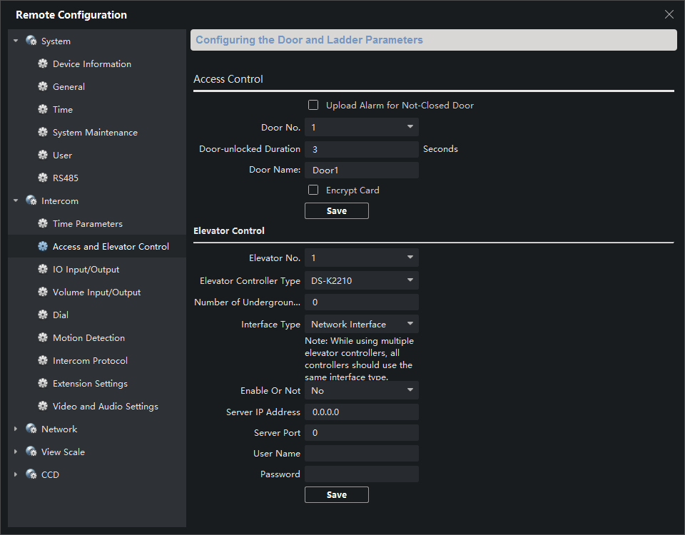

After days of painful and nervous testing, i finally found out what was the problem!
I opened up this beaty completly but haven't found anything usefull.
Assembled it again end went throu about the advanced settings. Under the Intercom/Access and Elevator Control there is the Access Control part and an Encrypt Card box. It was set. I disabled it and after save, the station recognize cards and can program or open the gates.
Happyness!
