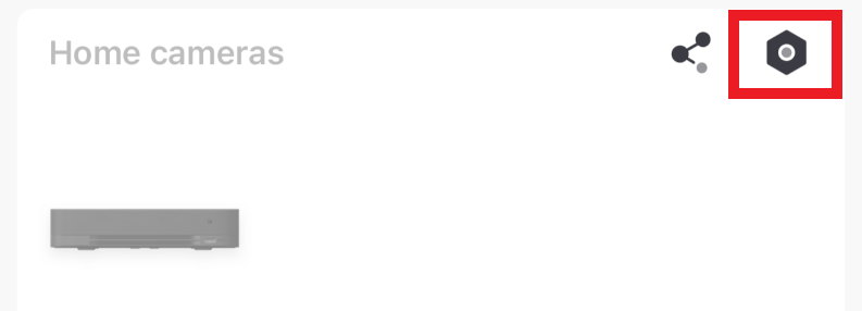

So, you'll need to touch the hexagon to open the settings for that device:
And you can then disable "video and image encryption".
But as @David says, it should just work if you remove the DVR and add it again no that you've disabled encryption on the DVR itself.

If i click the hexagon i only get the option to delete it. see here
