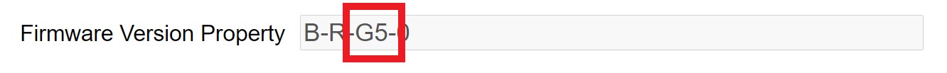

To check if this firmware is applicable to your ColorVu camera, log into your camera in a browser, and go to:
Applicable cameras will have a "G5" in the third part of the "firmware version property" number at the bottom of this page:
They will also have a (C) at the end of the part number on the white label on the camera or box.

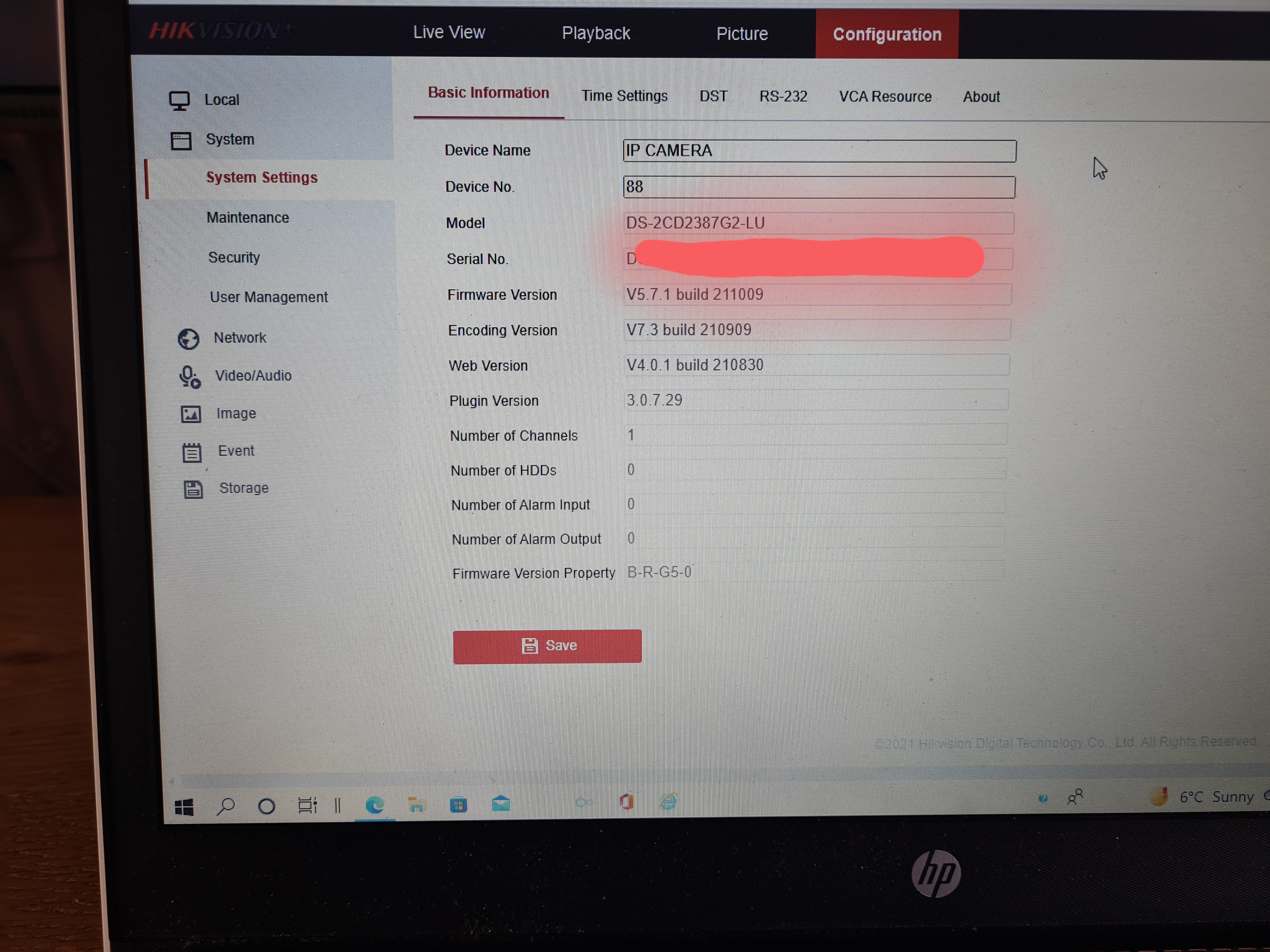

Configuration → System→ System Settings → Basic Information
