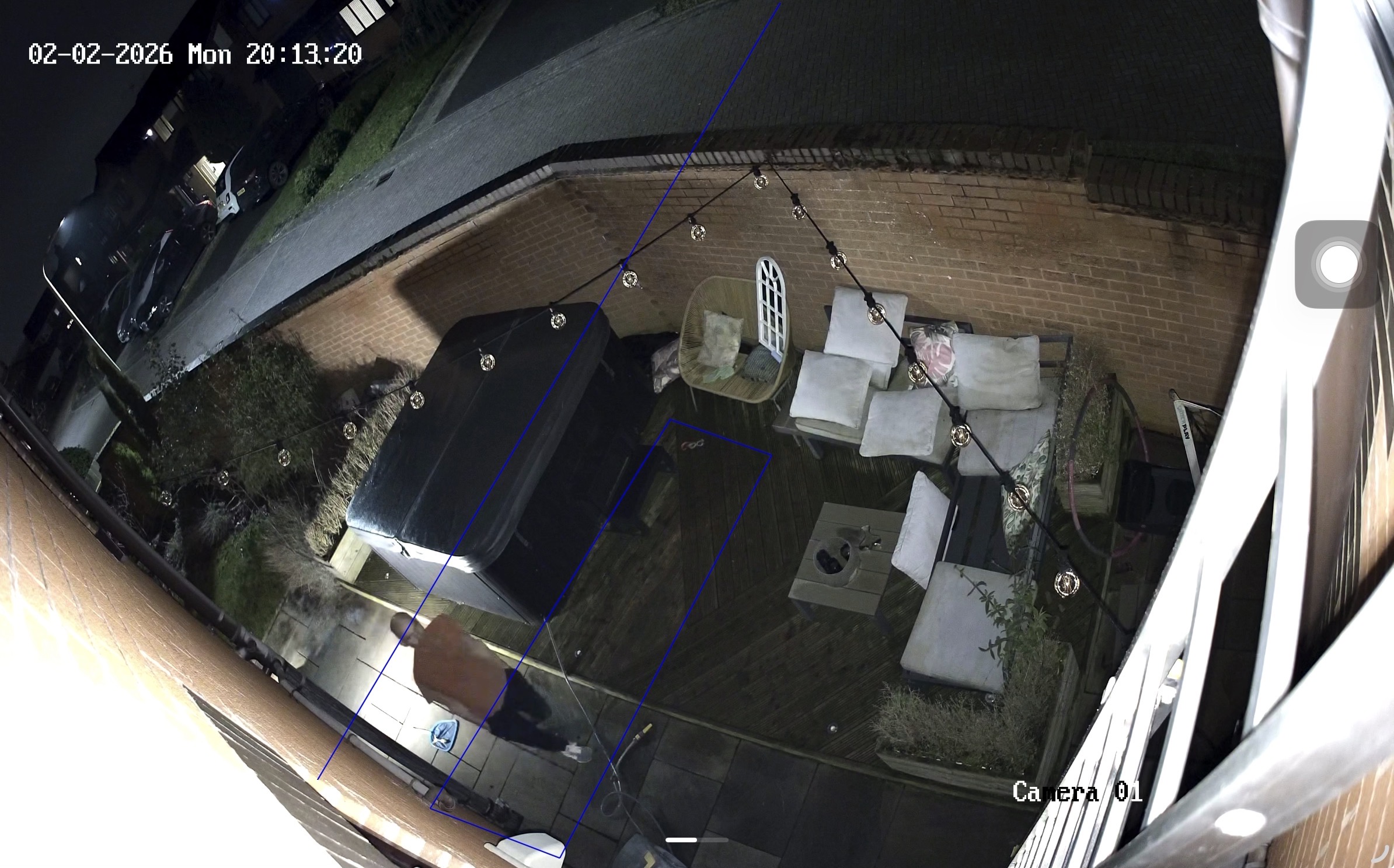

OK update in - I have installed my G3 - 2CD2347G3 to replace my 2CD2387G2.
G3 worked lol!

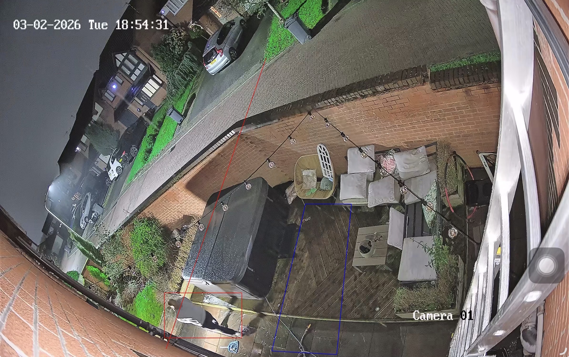

Made a vid so you can see how line crossing and perimeter completely failed at night on my G2 (lines dont go red when crossing). But on the G3 - not only is the picture quality a lot better the line crossing actually works! I did have to update the software of the G3 to the latest though as before that it was inconsistent.
Time to wake the G2 on eBay lol and replace my other G2’s with G3’s lol
Vid - of quality and line crossing improvement :

G2 compared to g3 had hard times working on targets that were not vertial. This angle was hard on model dataset G2 had/have
Yes, I was going to comment that the angle is out. Personally, when installing cameras I always make whatever is in the centre of the field of view, vertical. On the example shown the camera has been installed so that the right hand edge of the view is vertical (the camera should be turned so that the 'bend' in the wall or lamppost on the opposite side of the street is vertical to balance the distortion)
Great feedback and makes sense now why my other G2’s installed with a more traditional / vertical view work just fine with line crossing. I did not give much thought to my positioning of the camera other than trying maximise as much of my garden as possible and not too much brick wall lol. Sounds like i could have got my G2 to work OK if i just repositioned it lol. That said the 4mp G3 night view is way better than my G2 (surprised me as most reviews did not see much difference).
