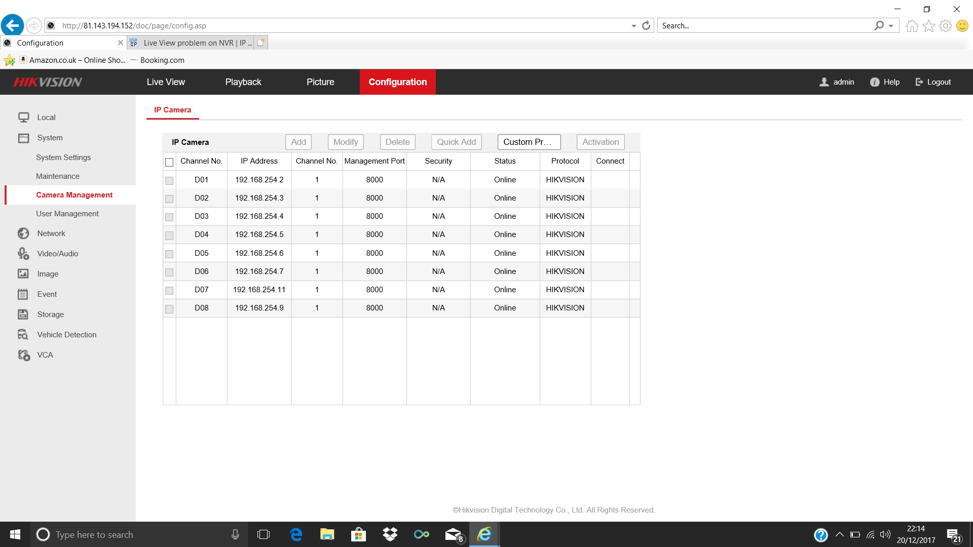

How does this problem camera look when you check 'Camera Management' by accessing the NVR's Configuration section from Internet Explorer on a PC on the same network?
hi Phil
Thanks for getting back to me. he has a DS-7608NI-E2 / 8P/A. Yeah both are up to date. Is this the screen youre referring too?
