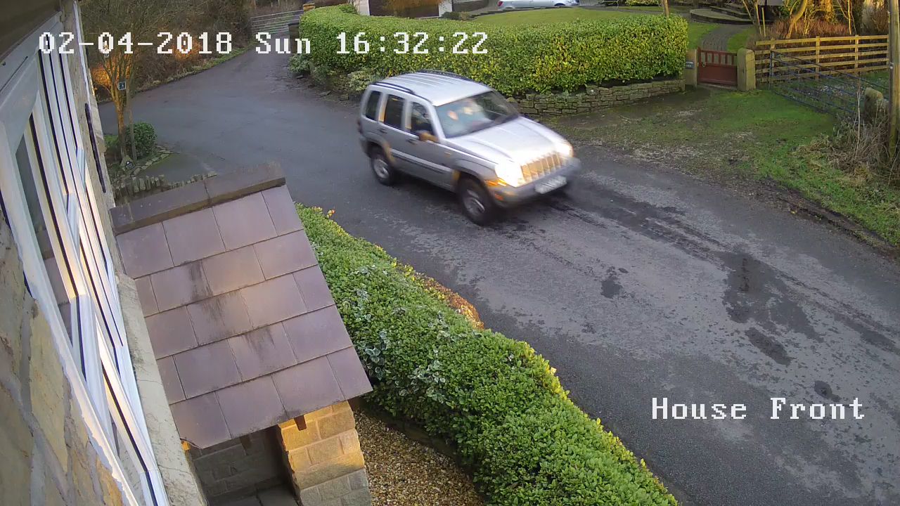

Reading the 'hints' blog post last week a turret (5mp or 8mp) is definitely something I want to do for house-front (see attached) as well as lower its height from soffits (as in photo) to half way down house. This to improve visibility and night-vision with the EXIR.
You can see from the two attached pics that the 2532 (main gate) is giving good image and largely i guess cos of its height.
The other photo (from yday) isn't getting the number plates and i think too high.

Both your sample images look pretty good.

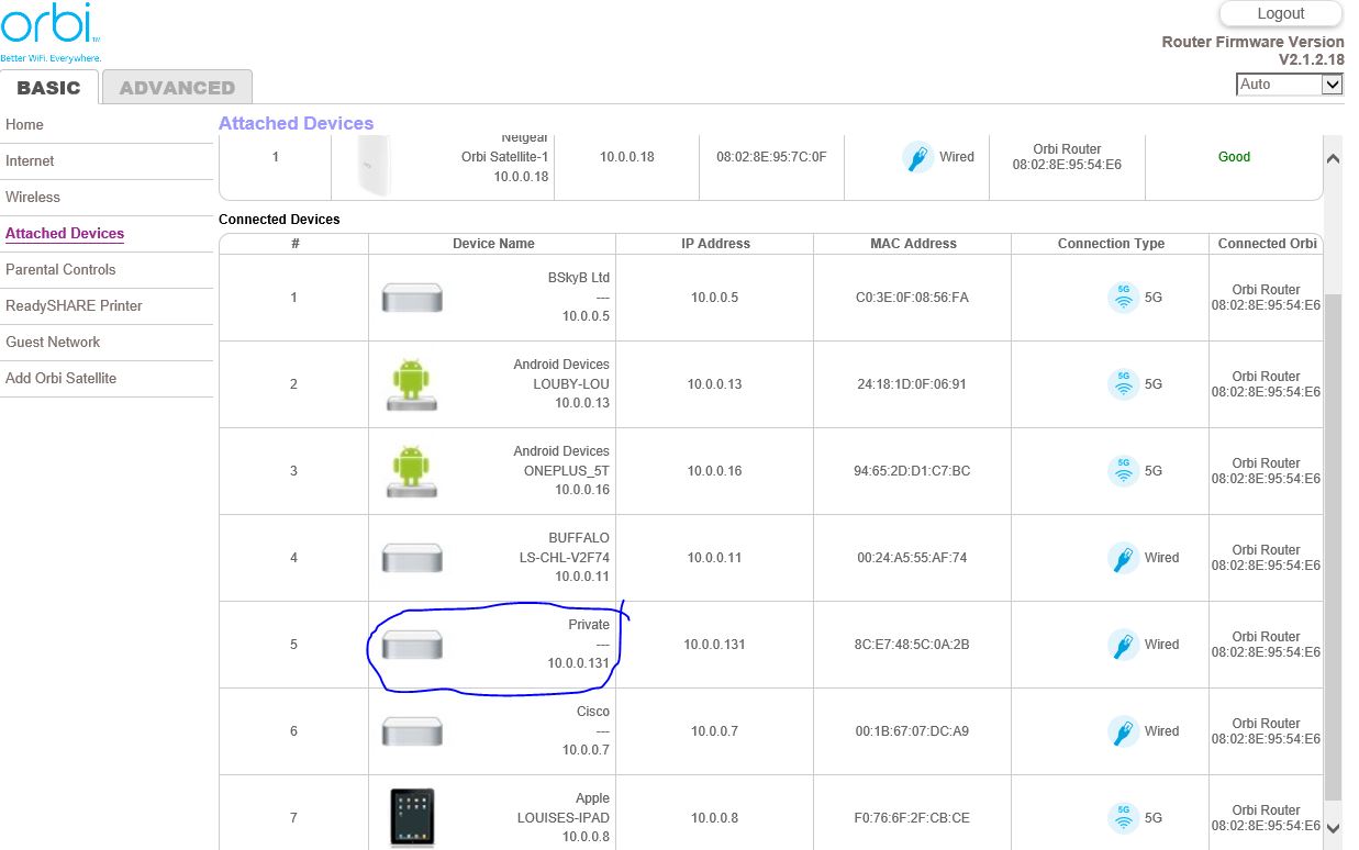

As fyi, the NVR is on a subnet of 10.0.0.131 - which most other devices are on which is ORBI network.

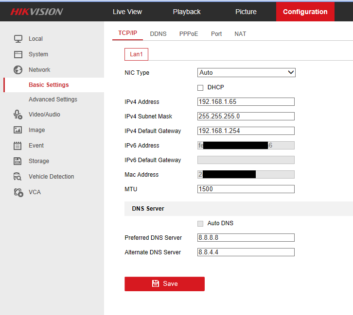

Have you fully set up your NVR's network settings?
I guess ORBI is wireless/mesh?
Can you remove that from the equation as a possible cause of the NVR dropping off the network?
Not really as it is the network. Router connects to it, then it has landed and WiFi from it. NVR been ok with it last 5months until doing updates.

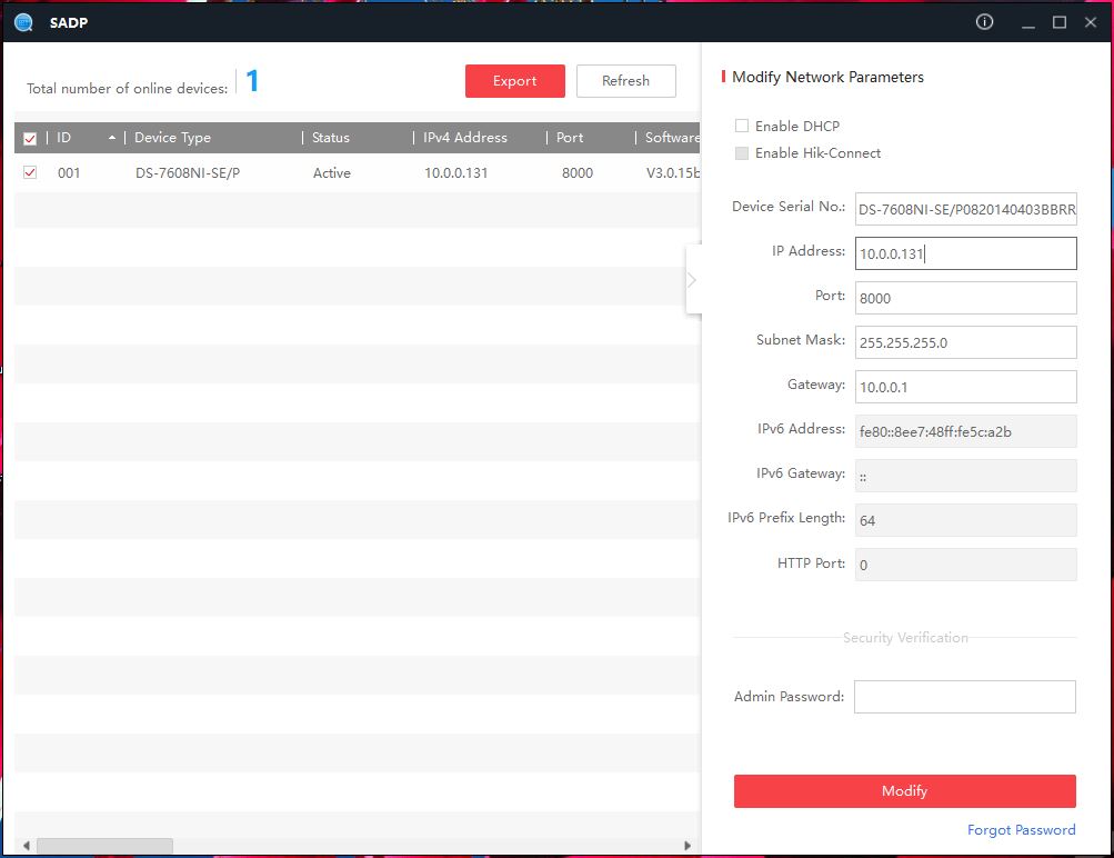

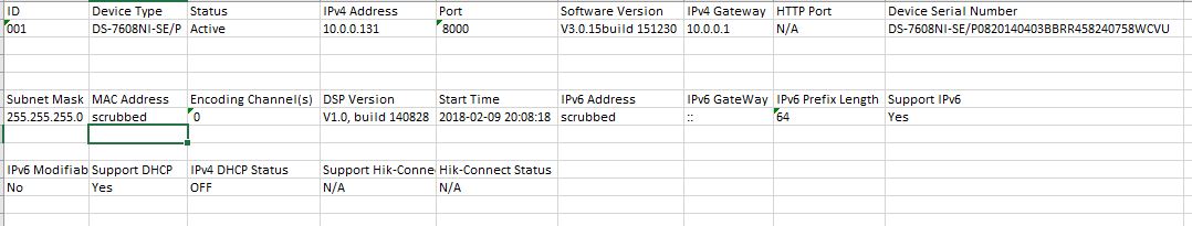

Hi Dave, Can you please run SADP when the NVR is online and send me a screenshot of the results?
(full-screen, with the right-hand side fly-out closed please, so I can see as much info as possible)

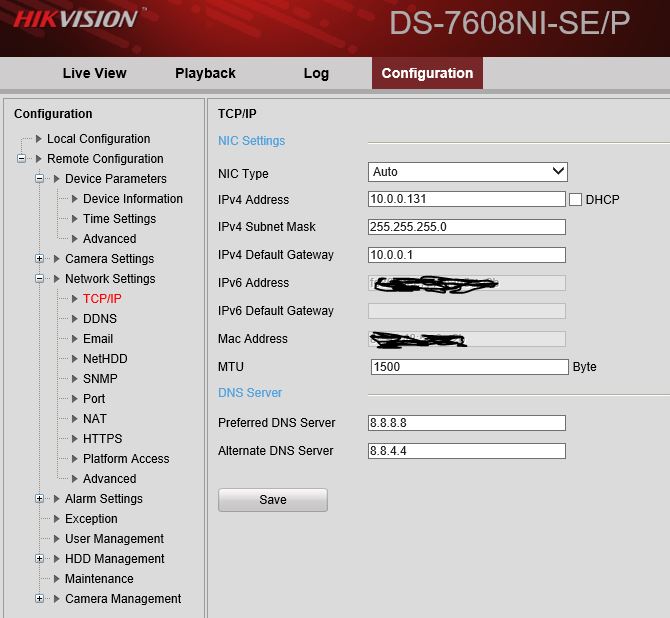

Hi Phil, see attached. Just back from working away. NVR been off 3days. Just went turned it on / off and straight back visible on SADP and browser/ivms. When I went to it, whilst power LED was on, I did not notice tx/rx LED flashing .. it did/is once I turned it on/off.

Hmm, I can't see anything wrong with those settings.
Can you reset the NVR and set it up afresh? It might eliminate a bug in there.

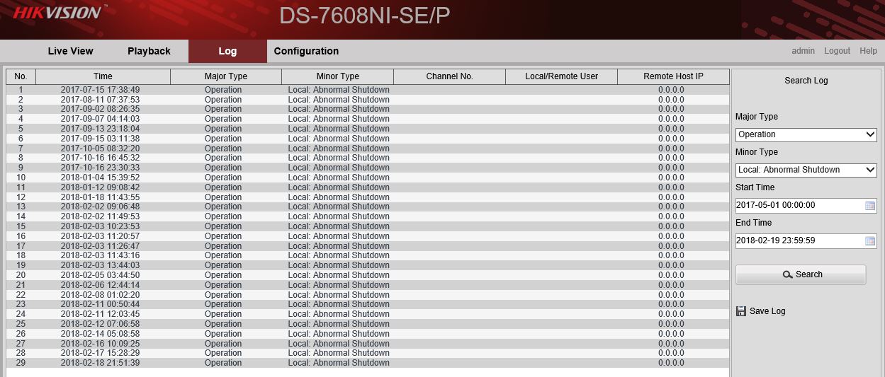

Hi Phil and Magic919. I have rebuilt ORBI and Router. No IP clashes on addresses. 7608 NVR set at static IP address. Interesting when I look at NVR log the 'disappearance' of the NVR certainly in Dec/Jan/Feb links to rough timing of 'abnormal shutdown' appearing in log (see attached). Most recently last night. All recording stops. SADP not able to see NVR. Reboot only obvious way around. A reminder NVR is on V3.0.15 build 151230. I cant see (or remember) when I applied that update but I recall Dec17.
