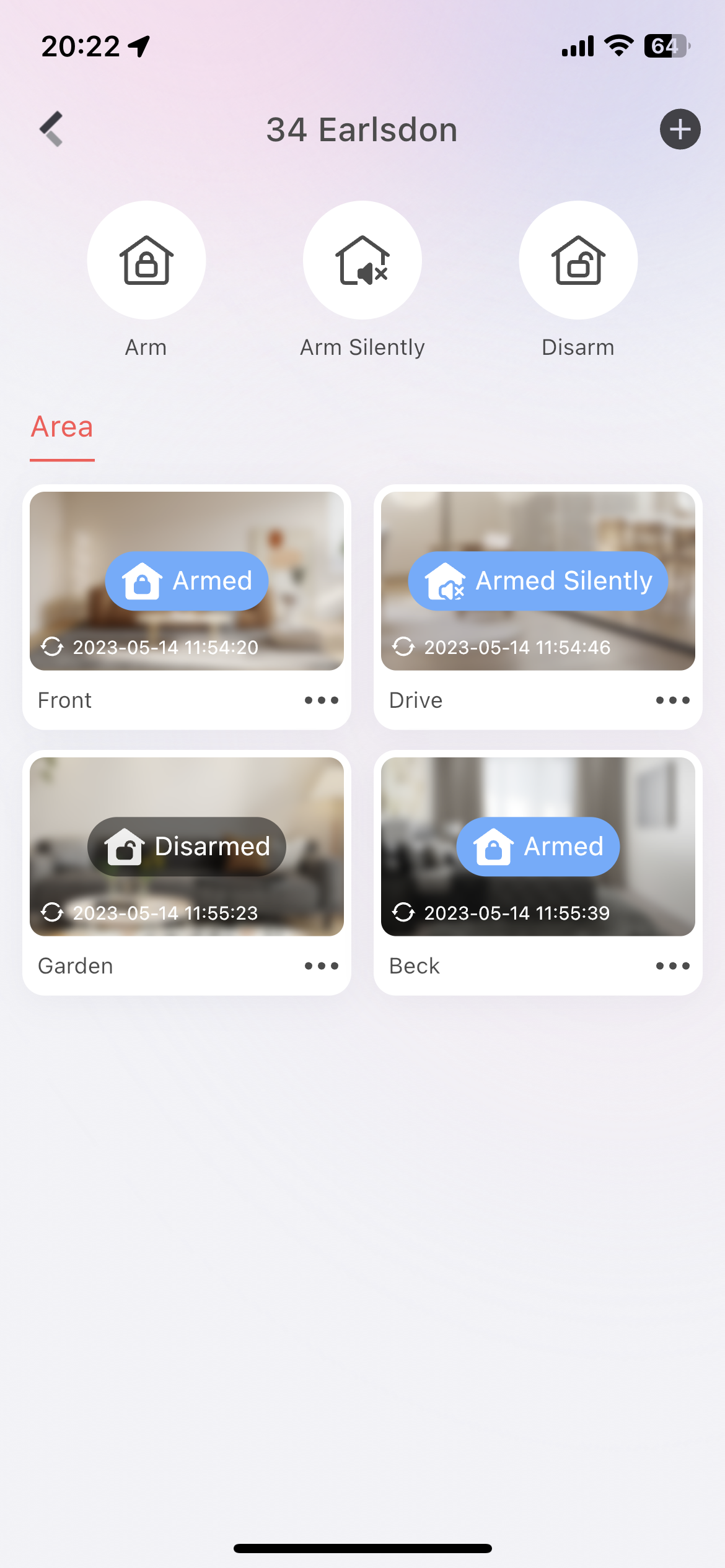

For each area Arm, Armed Silently, Disarmed were correctly labelled on each camera. Arm and Disarm worked correctly, however Arm Silently did not work with push notifications still received regardless.
In yesterdays release 4.63.005. The problem is not resolved:

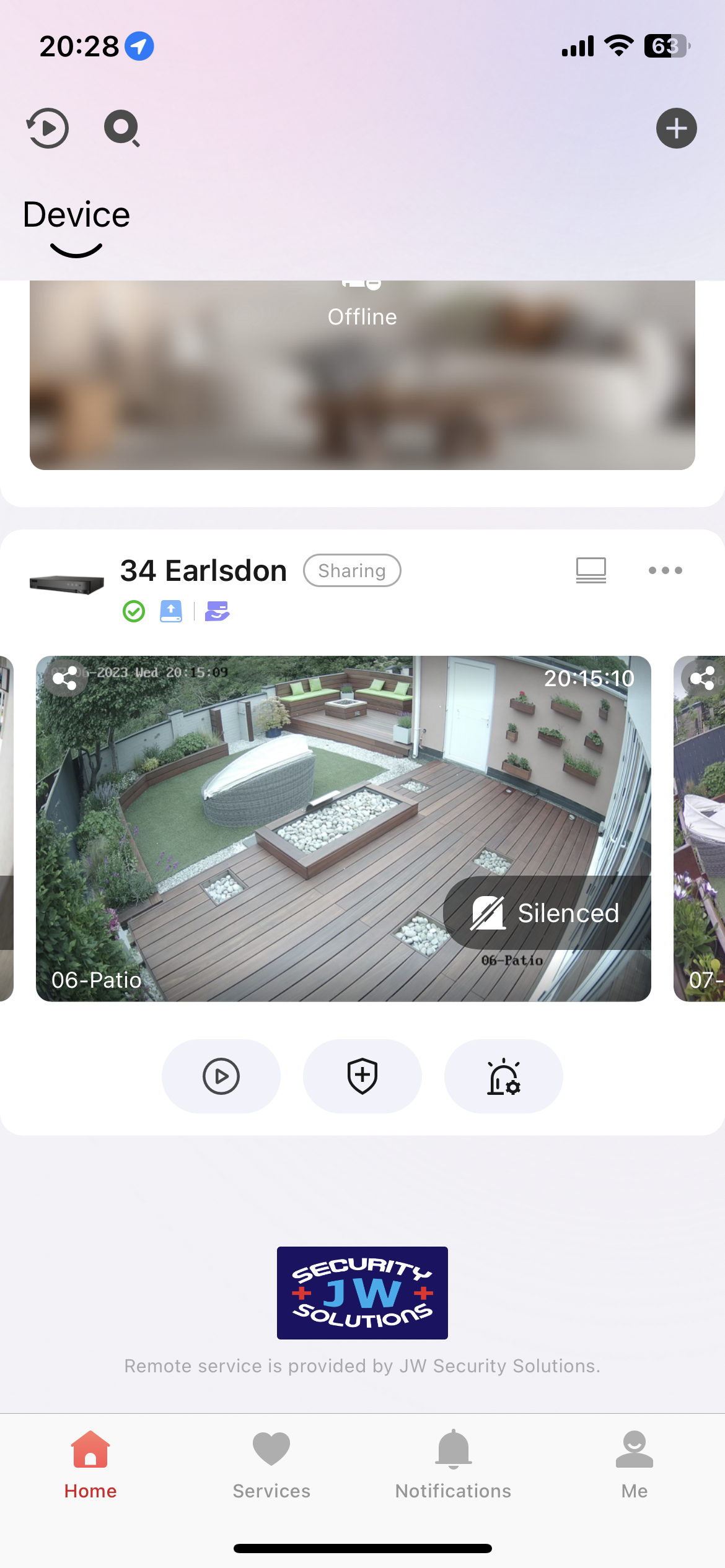

For each area Arm, Armed Silently were correctly labelled on each camera ('Armed', 'Silenced). Disarmed is incorrectly labelled 'Silenced'. Arm and Disarm worked correctly, however Arm Silently did not work with push notifications still received regardless.
So nothing has changed with regard to the incorrect operation except that a Disarmed area is now incorrectly labeled Silenced - it's actually worse
