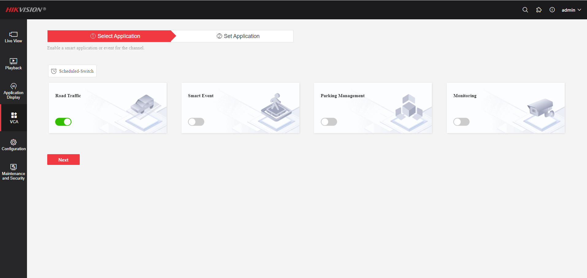

Update to latest firmware
@trempa92 I should of said in my post, it came shipped with the latest firmware currently V5.7.80_230712 (in the UK at least).

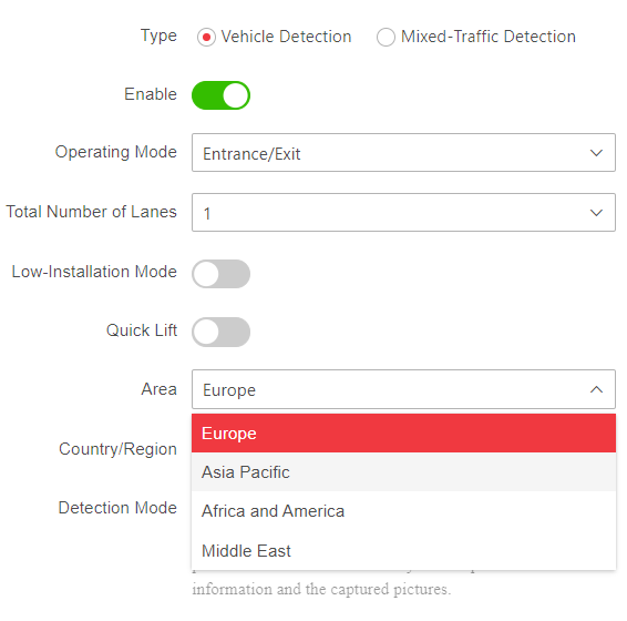

I would without any hesitations. Before you do anything, would you mind checking regions for plates?
If you have the same, i dont see any other reasons why not.

@trempa92 The newest H8 I have (on I have on 5.7.80) has:
"Region" dropdown with only a single entry "Europe Region".
Then it has:
"Country/Region" dropdown with a large list of countries (mostly Europe but a few others like Russia).

@trempa92 I found V5.8.50_240806 on the UK Portal here which my camera DID accept. And that is the completely new web interface. So I will see if that makes any difference to the night capture / exposure at night on this camera. I might risk trying the global website update to V5.8.60_240807 later but I will stick to this for now as I know it works on my UK camera!
