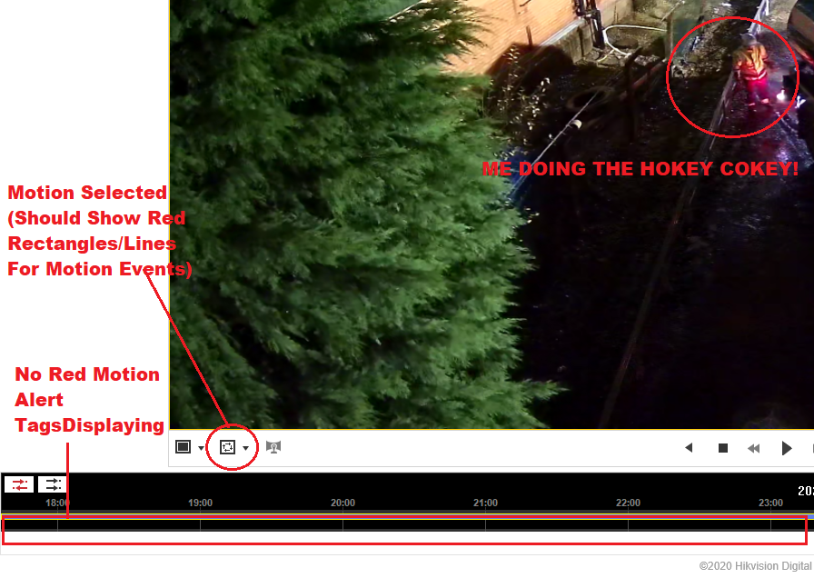

Ok, So in no way am i new to Hikvision kit but this is driving me nuts, since updating our DS-7608NI-K2 / 8P recorders to v4 firmware (200628 & 200803 to try and fix the issue) you no longer get the motion alert tags on the slider at the bottom to show when motion has taken place in the browser GUI meaning that we have to now either rely on the client being correct with their times (HaHa right?!) or scroling through hours of footage.

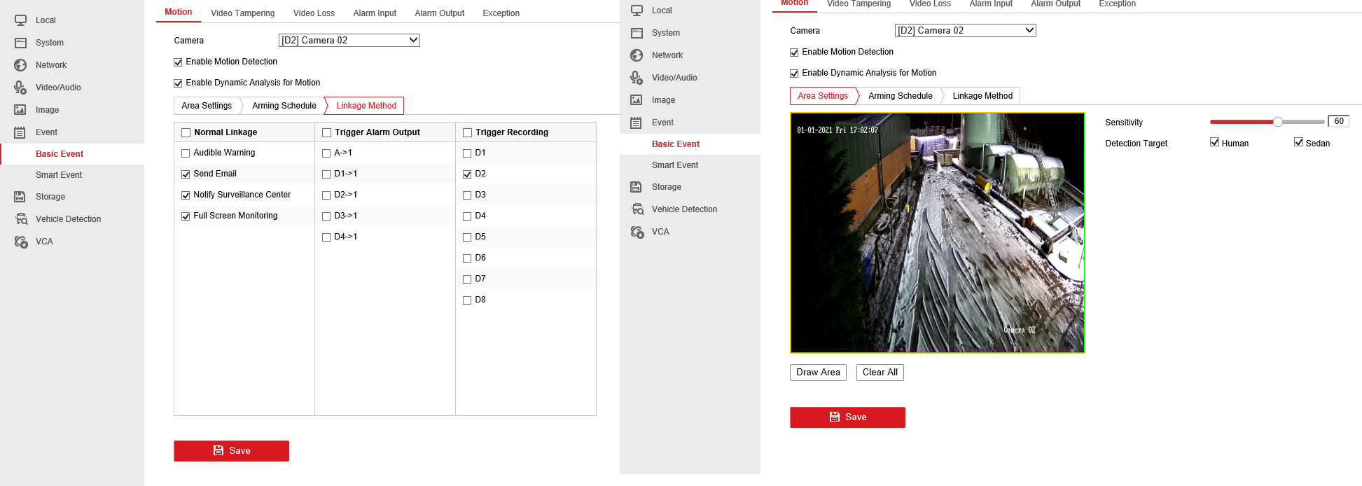

I have included below the settings, we are using the new acusence g2 cameras, as you can see i am in the image and it should be setting off event tags...
Now to clarify... events ARE BEING LOGGED and the monitoring station are getting alerts to their sentinel platform to say i am dancing round like a divy but as you can see on the slider below the footage NO EVENT TAGS! The recorder and cameras are registering them and sending out events but they ARE NOT LOGGING here where i need them to search events quickly.
