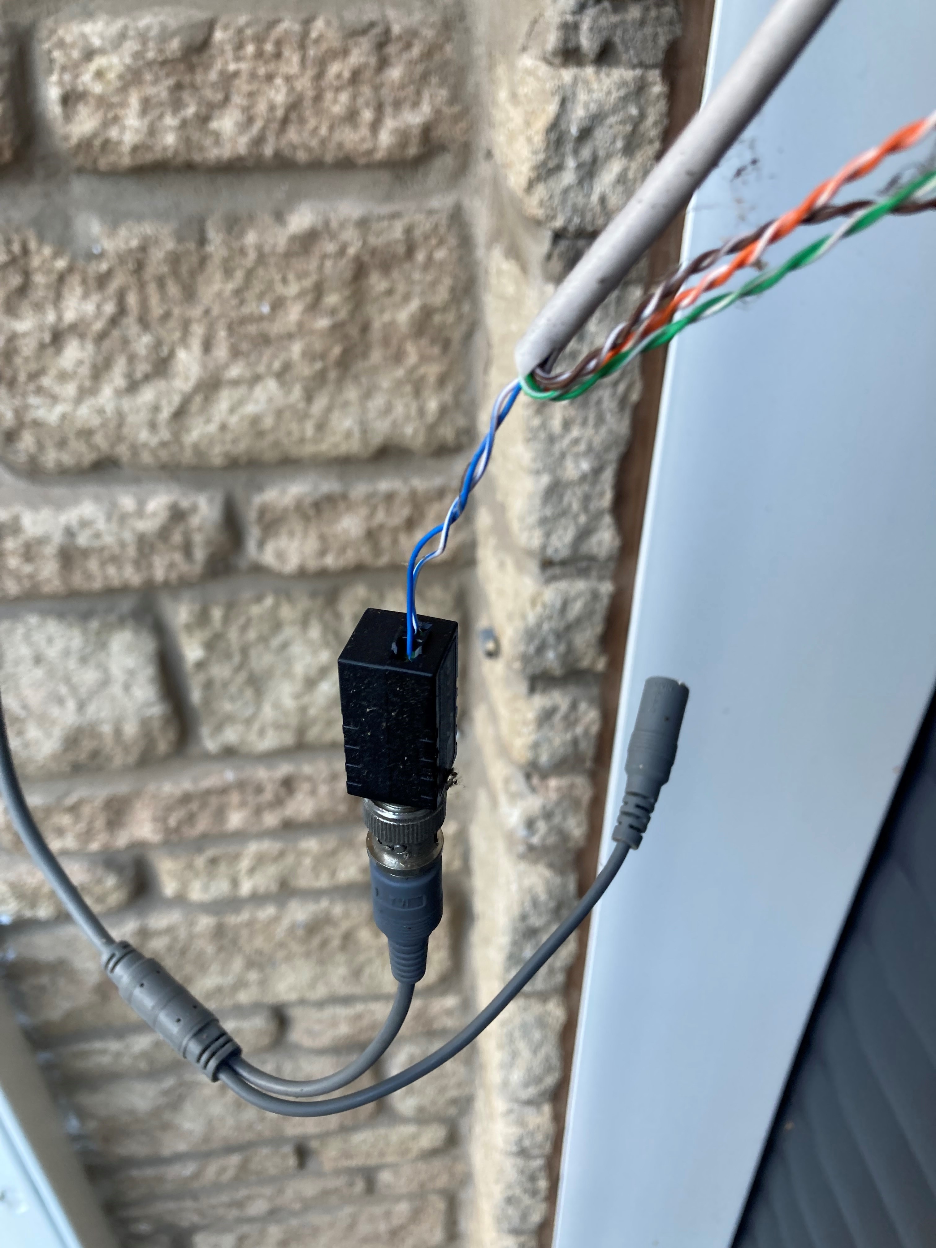

I have investigated what the camera appears to be connected / wired to = Photo's attached
Any help appreciated. If I have to bin them off and start again so be it.
Many thanks in advance.
James.

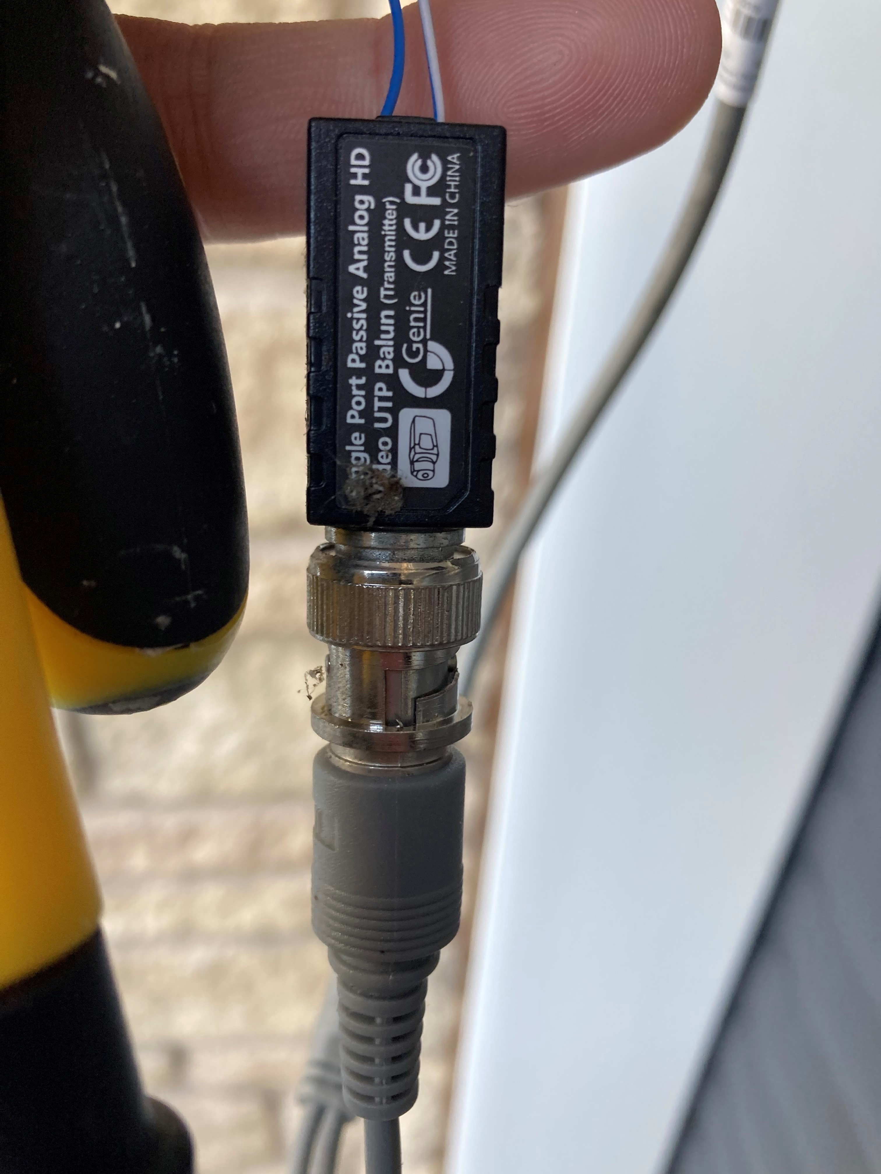

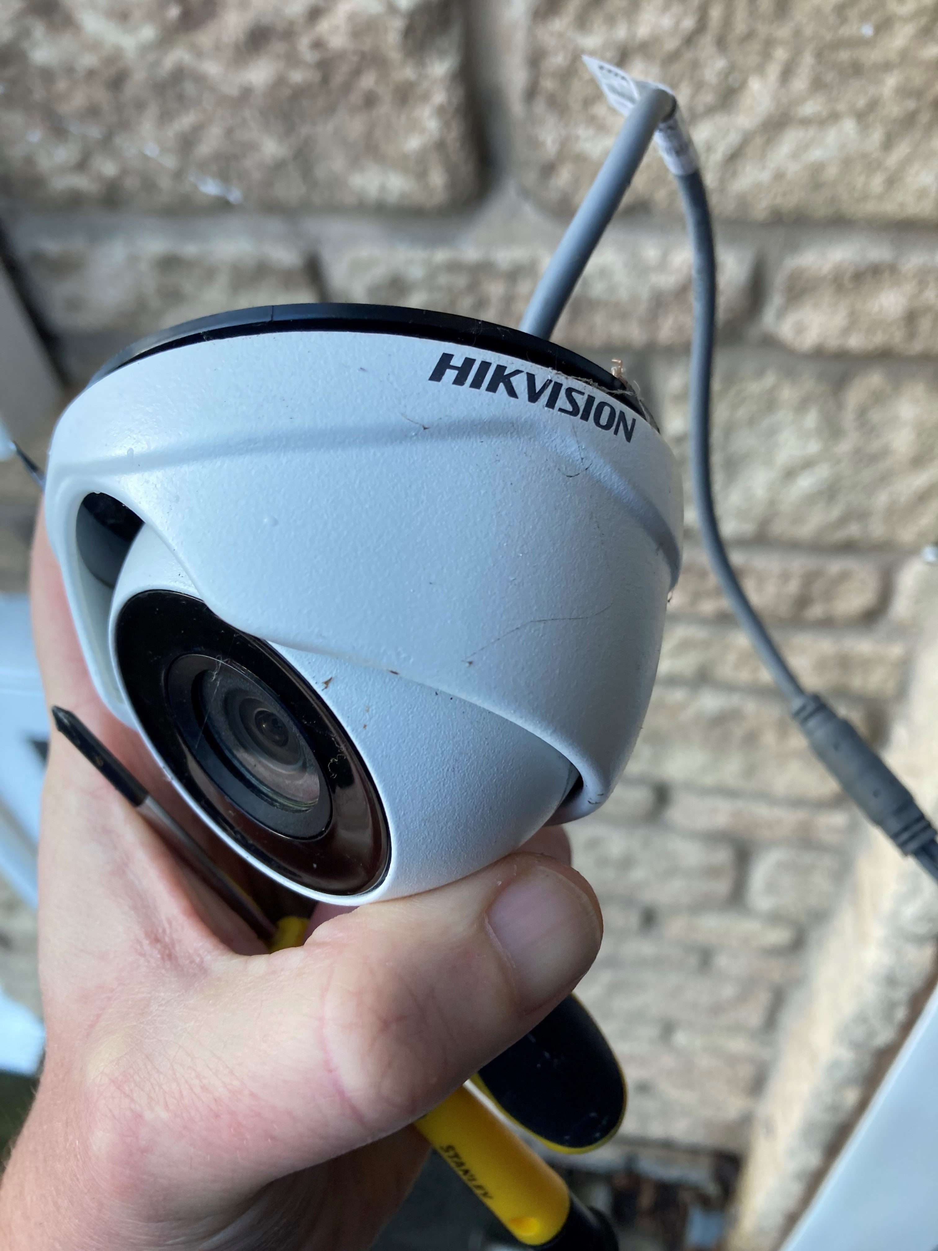

They are analogue cameras (would normally be connected to a DVR via co-ax cables).
They have been installed with the baluns attached to allow the use of twisted-pair cable instead of co-ax.
Can you see any model numbers on the cameras?
The model number will inform us of their age/features etc.
There is a second connector, a DC barrel plug for the power supply, was there anything plugged-in to that connector at each camera?

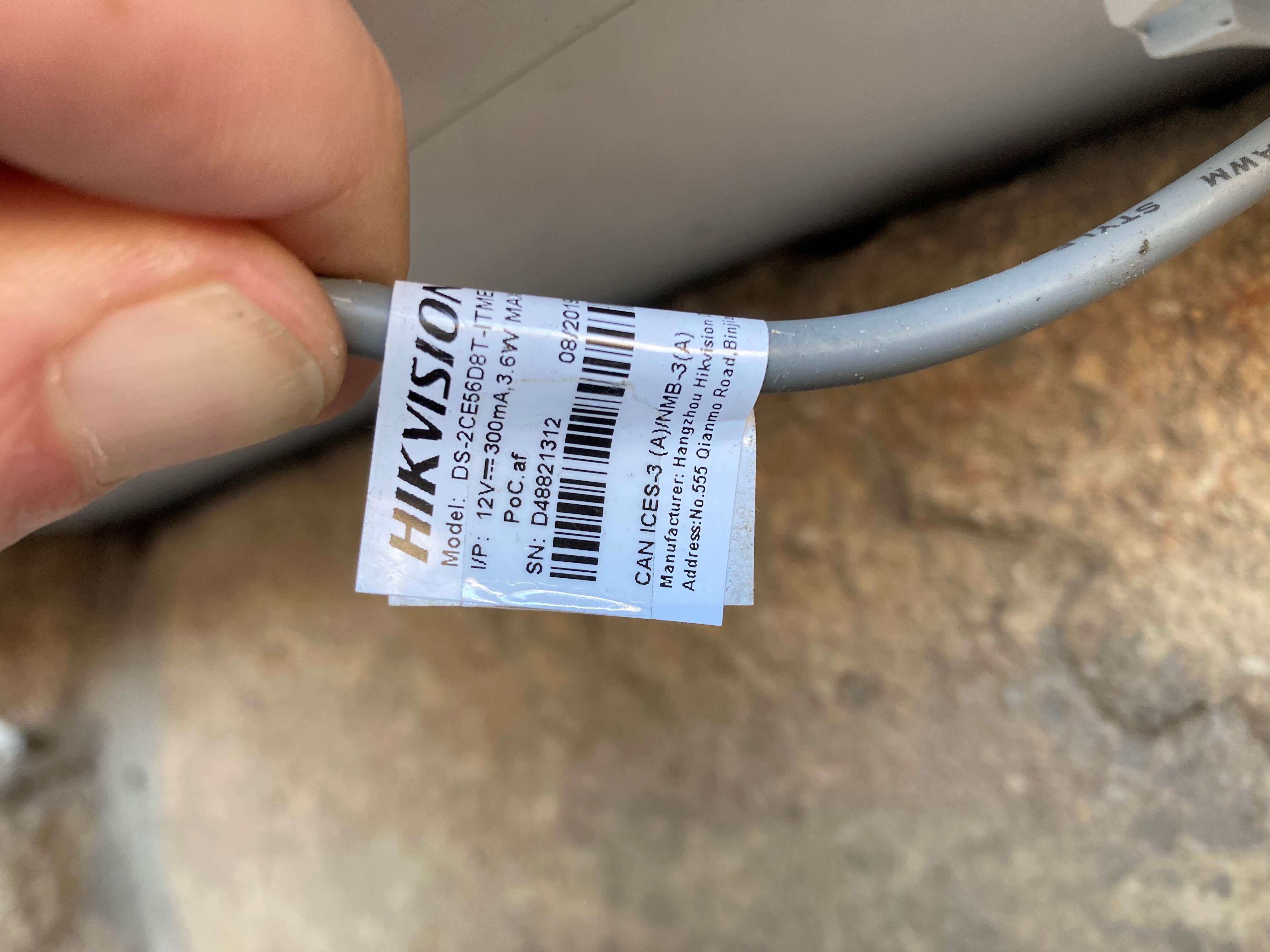

Model number is: DS-2CE56D8T-ITME
SN: D48821312
Photo attached.
Here's the product page for the cameras:
DS-2CE56D8T-ITME
The PoC on the label is for Power over Co-ax, so the power is using the same pair of wires via the balun as the video signal.

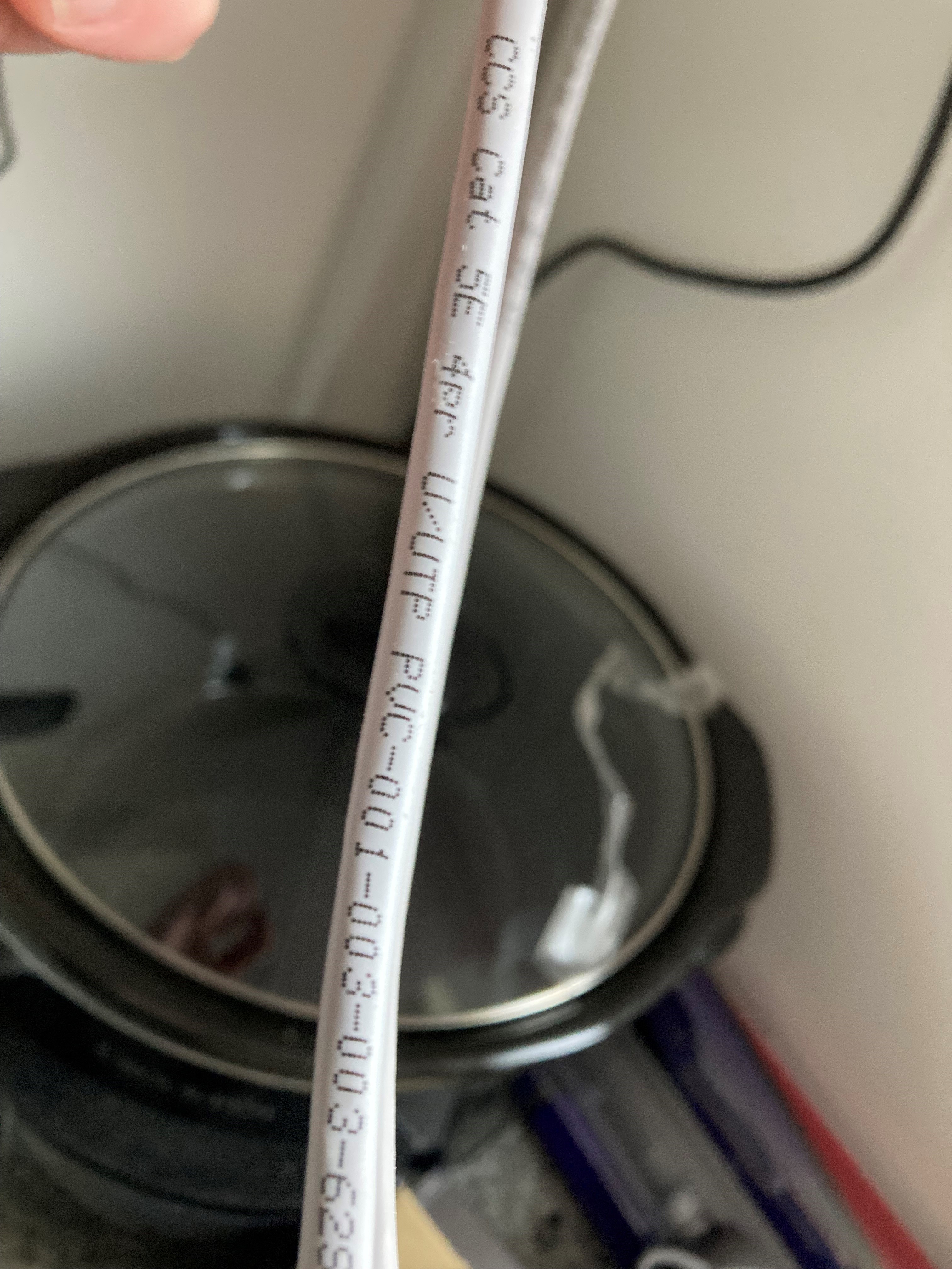

As can be seen in the photo below I found these wires in our utility room. 100% these are the 2 wires that connect to the cameras.
I've been having a look on your website at what might be available in order to get us operational. If I could ask for some more advice though please, would you suggest just buying a DVR box and connecting up the existing cameras? Or are there other, more modern, options available to us (utilising the existing wiring)? Any advice welcomed and given how helpful you've been I would be more than happy to purchase the recommended solution from your web site.

It has always been possible to use baluns to convert from co-ax and use cat5 / twisted-pair cable instead.
This is popular because:
  • It does away with the need / skills / tools required to terminate co-ax cables and plugs well (doing it badly can cause all manner of signal & image problems).
  • But also, one camera signal travels over one twisted pair. So, with a multi-pair cable you can get many analogue camera video signals transmitted via a single cable.
  • With the right gadgets you can send analogue video over great distances via twisted-pairs (and the cable is relatively inexpensive).

Hi, yes it's CAT5 Network cable, photo below...
That's handy, as it means that you have all the options open to you now i.e. you can solve with analogue cameras and buy a new DVR to suit OR install network cameras and an NVR.
