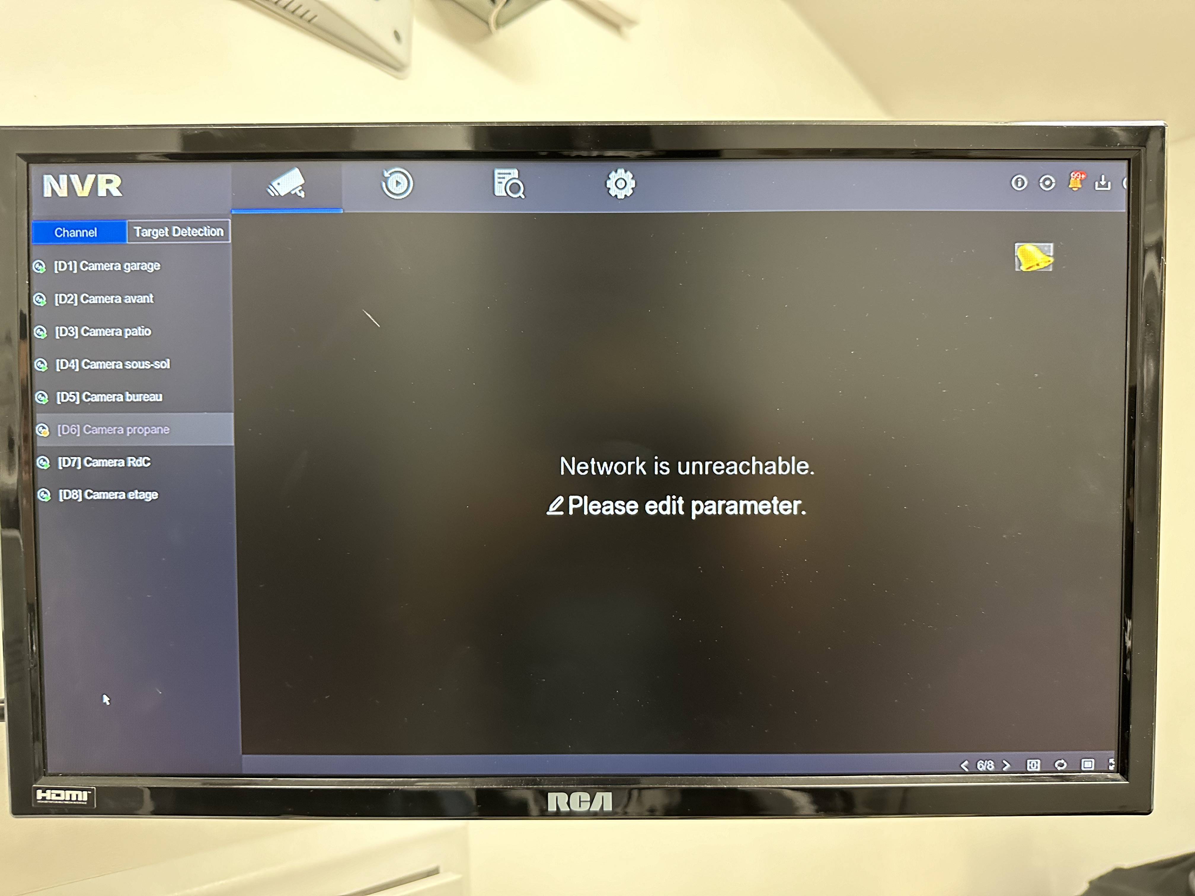

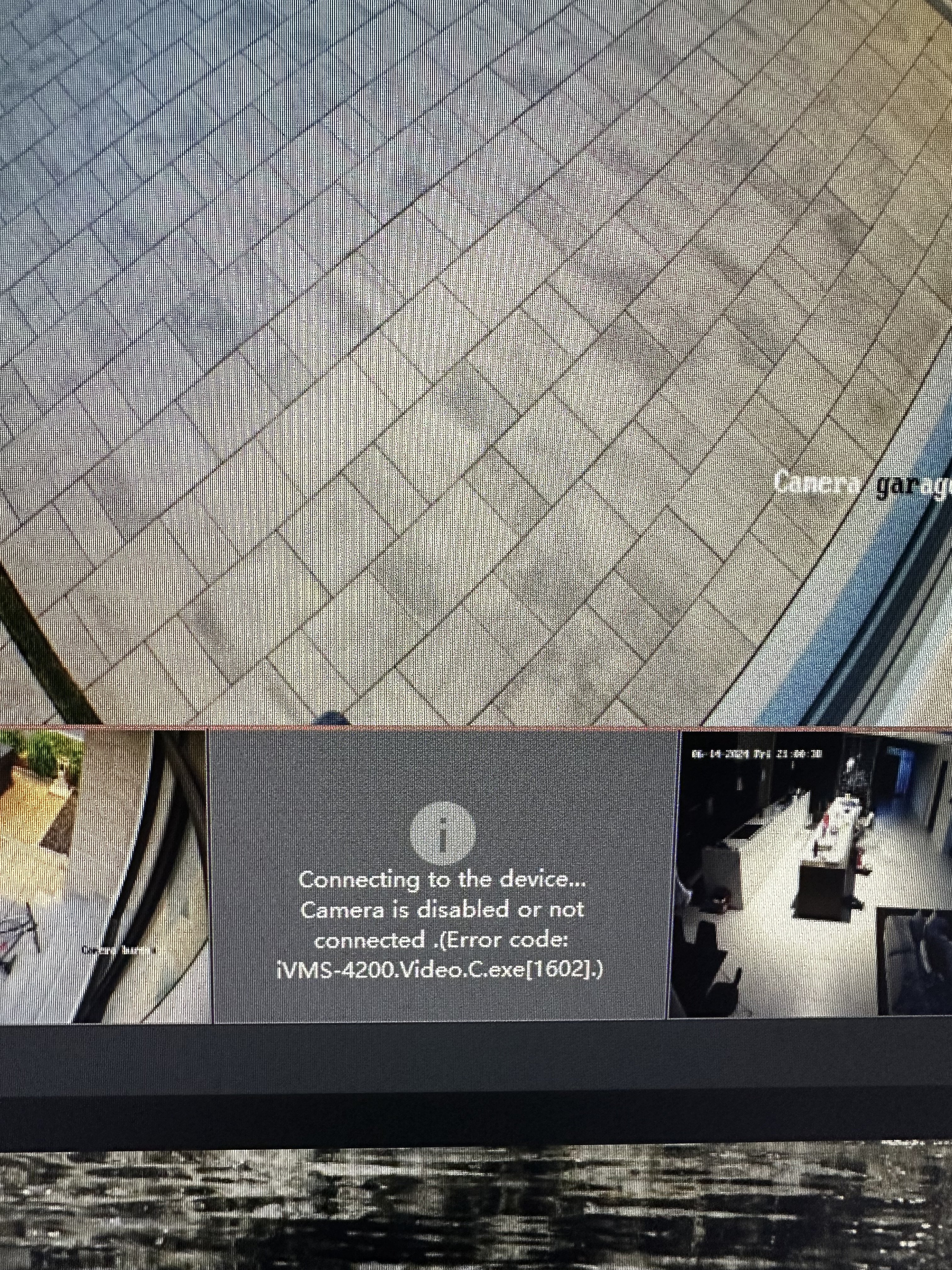

My system is a Hikvision NVR DS-7608NXI-K2 + 3 DS-2CD2543G2-IS + 5 DS-2CD2387G2 cameras.
Everything works well for the last year but today one of the DS-2CD2387G2 lost image & network connection. The rest are working well. The cables to the cameras are untouched and undamaged.
These are the photos of my system with the affected camera.
Can someone help me to resolve this problem?
Thanks!
Ian

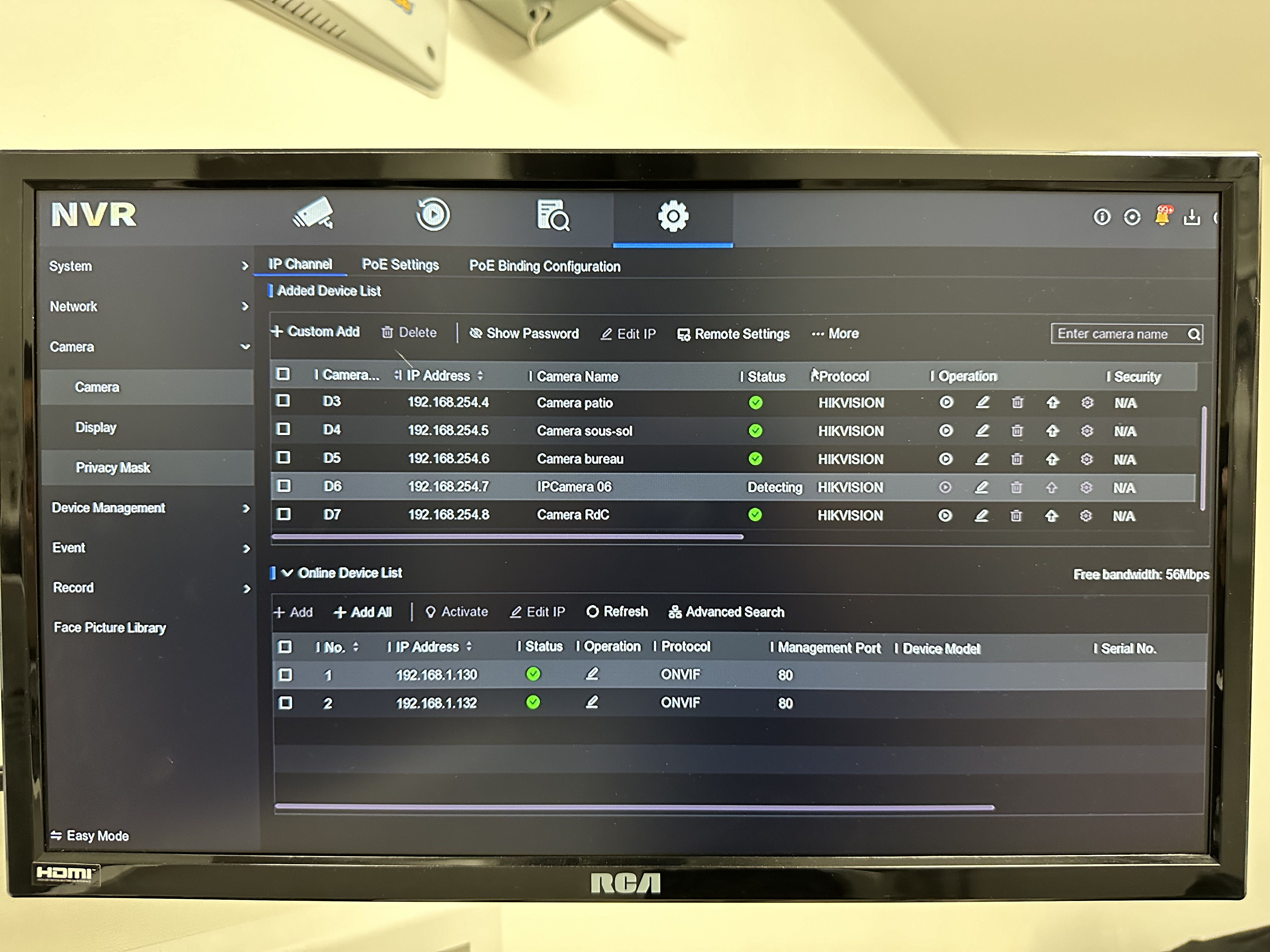

Hi @ian1975 - are you able to connect the camera to a POE switch on your network and see if SADP finds it?
If so, can you log into it directly in a browser?
If you can, make sure the firmware on the camera is up-to-date and try hard-resetting it - check the NVR's firmware as well, and see if that resolves it.
The 'detecting' status shown in your third screenshot is something we've seen on faulty cameras, or cameras with loose / corroded RJ45 connectors, so if you can't access the camera from a separate switch, you will probably need to take it down and inspect the RJ45 connector on the camera.

In your third screenshot in the original post, I can see that you have 2x ONVIF cameras on your network (.131 and .132) - if these are on a POE switch, then your could just plug the Hikvision turret into that.
If not, I'm afraid you will probably have to take the camera down and test it on a short patch lead, as well as inspect the RJ45 connector for signs or corrosion.

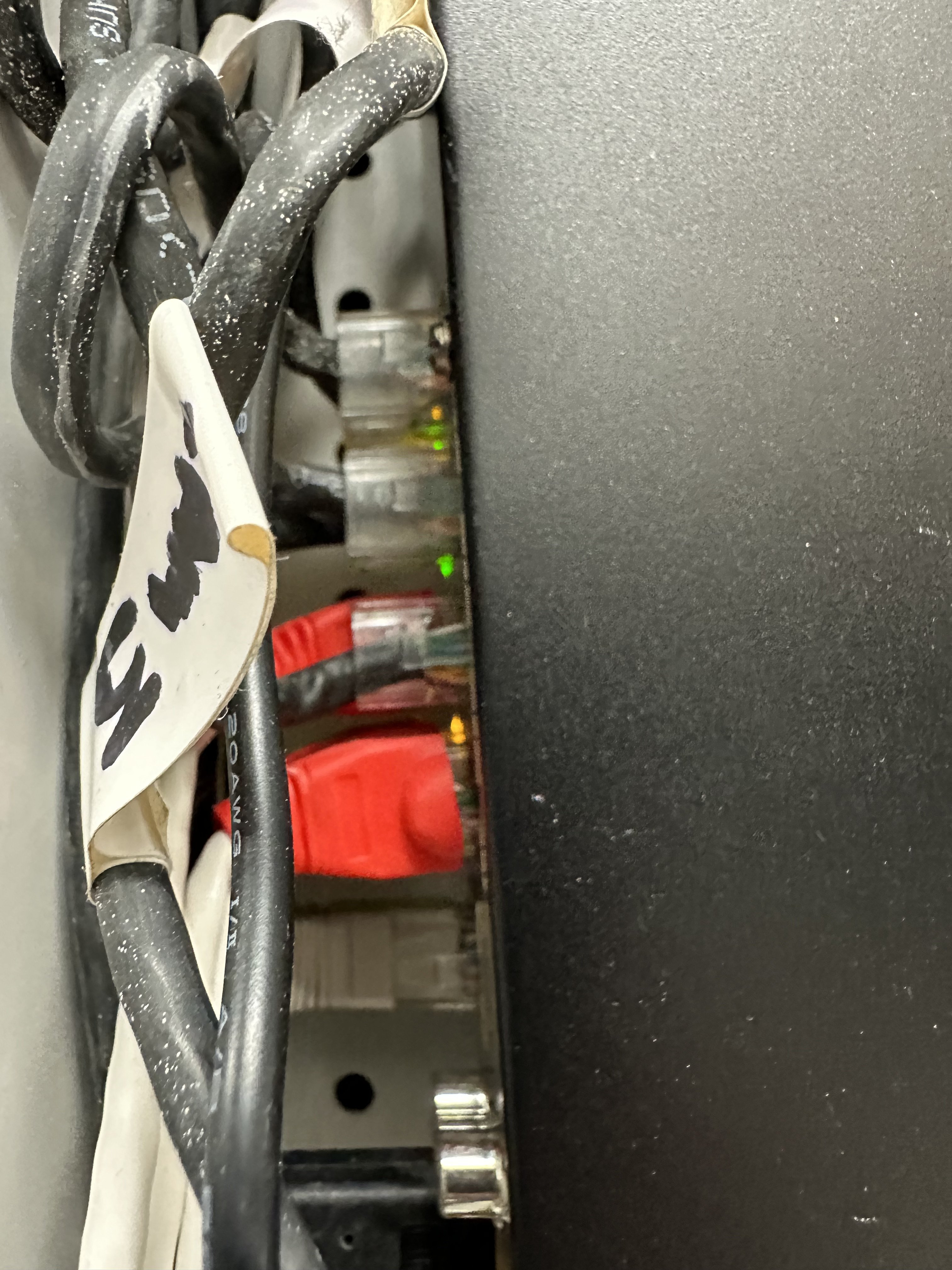

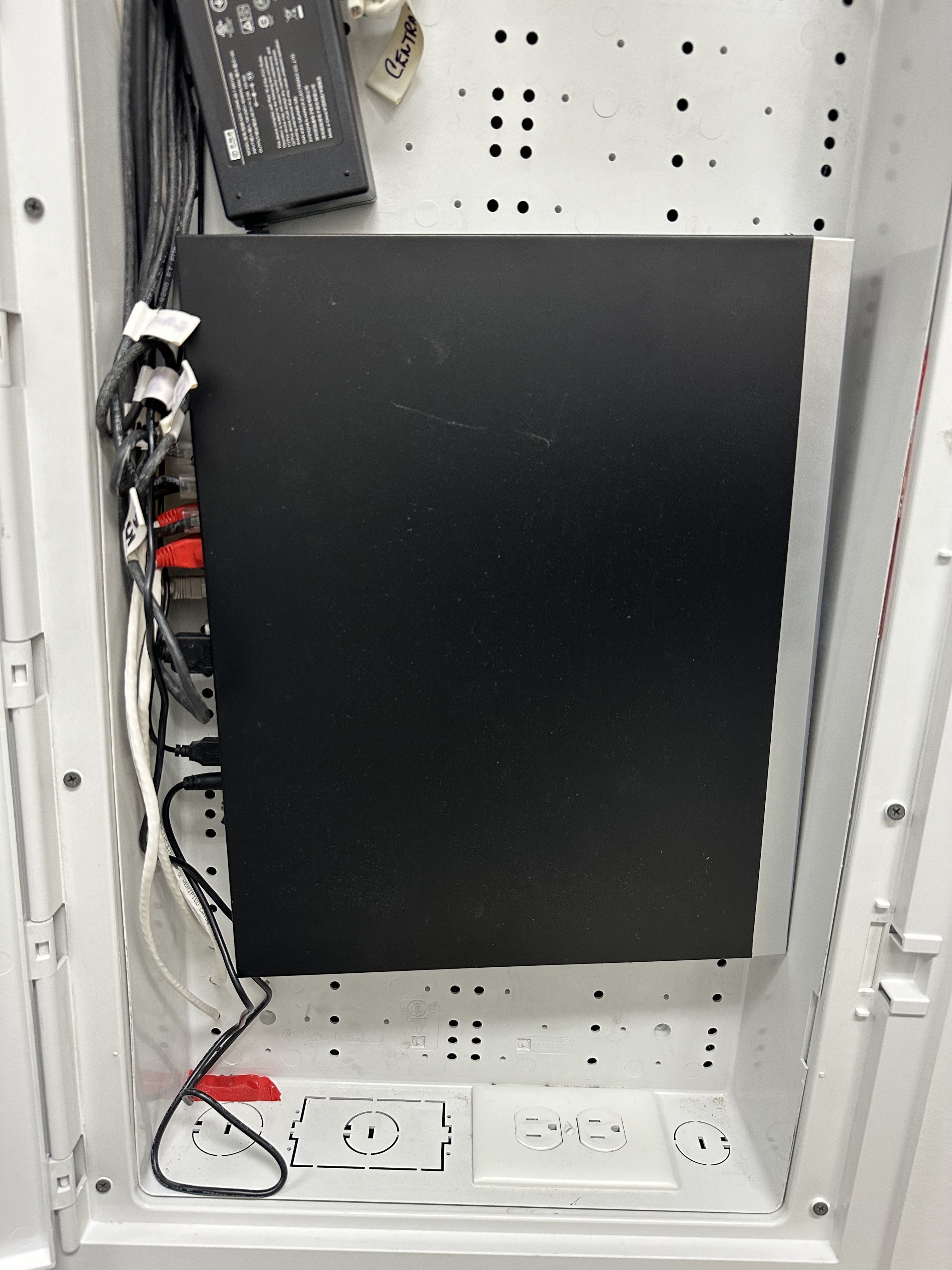

Hi Kyle,
I'm having trouble from both ends. I'm not a technician to disconnect the camera and the installer installed the NVR too narrow space so I don't have access to the back of the NVR.
I don't know what to do...

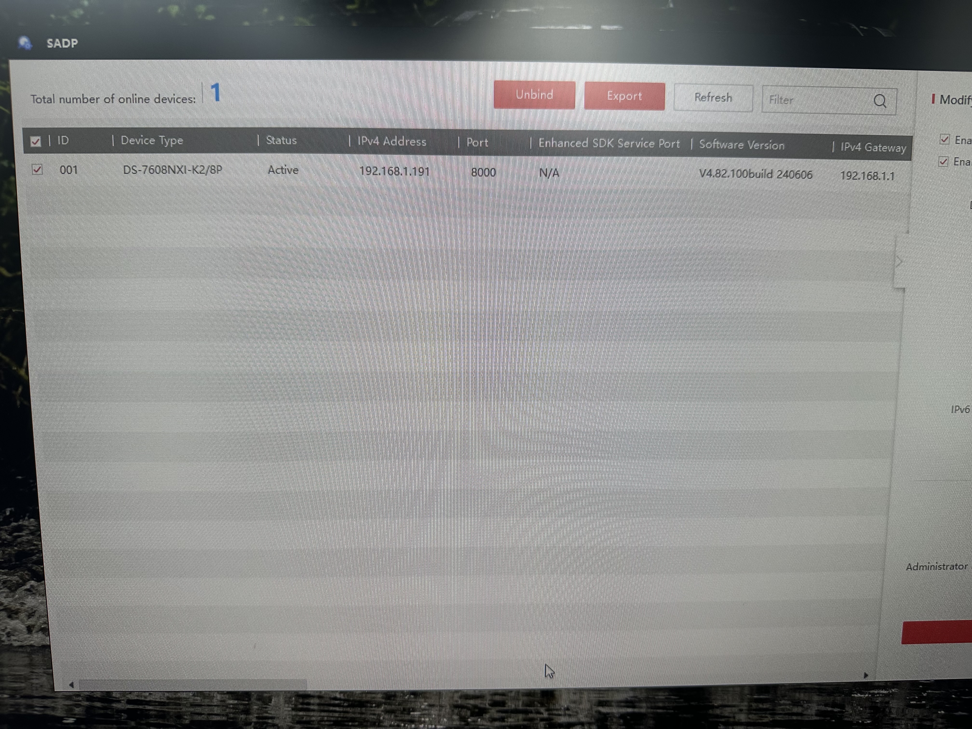

I see only the NVR on SADP. I don't see the cameras with their IP address...
Hi @ian1975
I'll assume based on the above information that your cameras are directly connected to the PoE ports on your NVR, if that is the case they will be using the NVRs subnet IP range for their IP addresses and thus they won't show up on your local network when using SADP.
To access directly connected cameras you need to enable Virtual Host which will create virtual links to log in to each camera.
