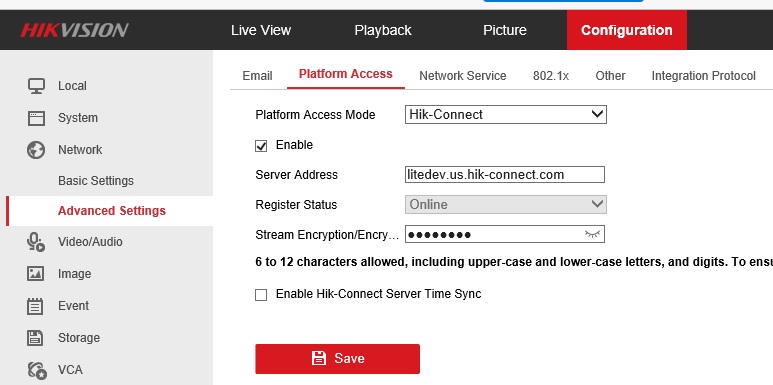

Do I don't seem to have the option to just turn off encryption. If I uncheck the enabled box I can no longer stream through the cloud version.
When I checked through the hikvision app on my phone the option is there but its turned off.
Any other suggestions?
If the 'local' device was added as described in my earlier post you wouldn't be prompted for a verification/encrtyption key as it is not needed unless encryption is turned on. The option to disable encryption isn't available from a browser menu though. You would need to check it directly on the on screen menu of a monitor/TV connected to the NVR in Network Settings > Platform Access.

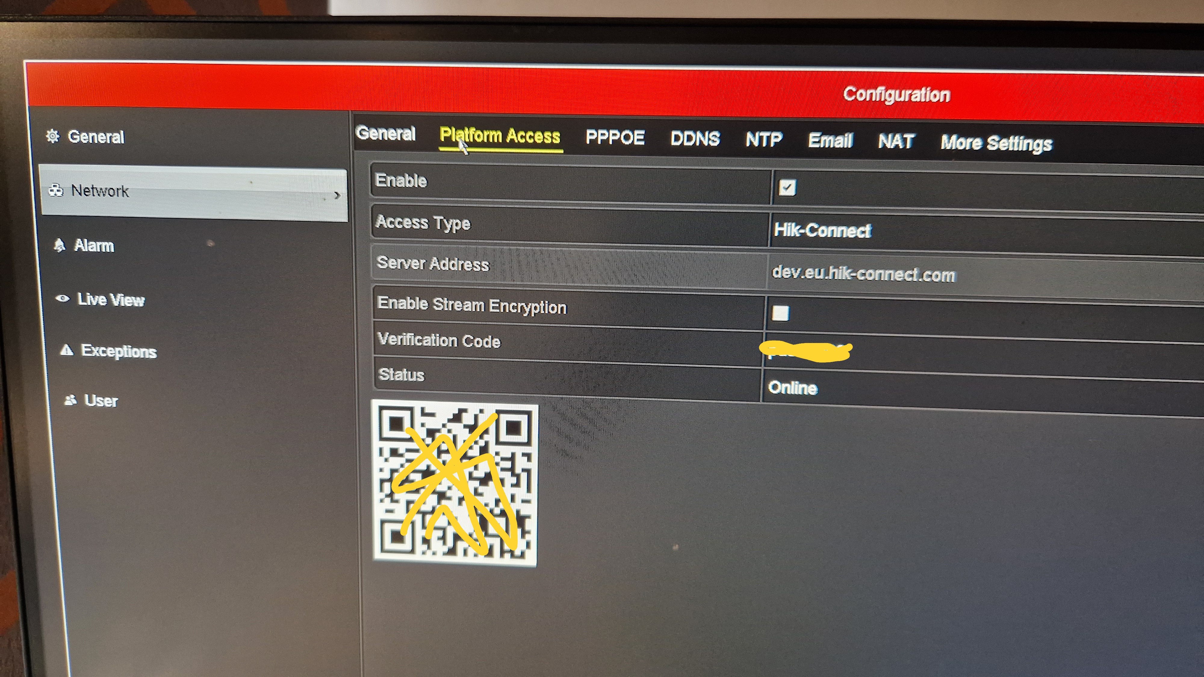

Ah I see, I will need to check on the actual NVR then vs computer.
