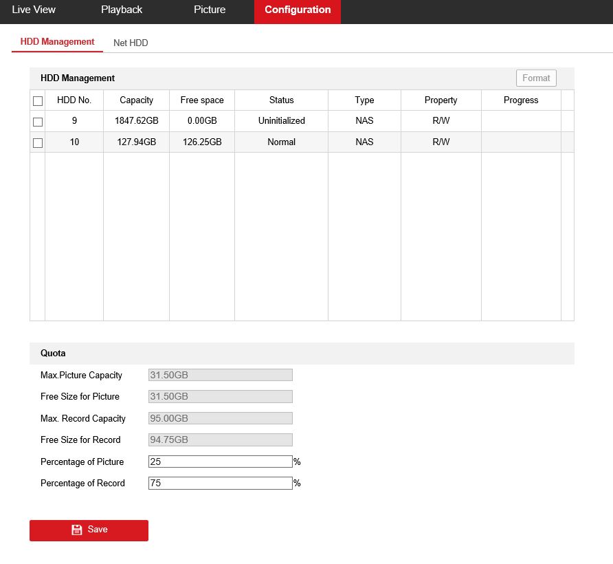

I have tried over and again on two different Cameras and they both act the same..
What I am attempting to achieve is for my Camera to record directly to a NAS ( Buffalo Linkstation 210 ) as I dont want to run a dvr or the IVMS software suite on my PC 7/24
I setup my NAS as SMB but it is open to even anonymous W/R access
I configure the Camera's Storage management NET HDD with my login parameters and test successfully.
I then Format the HDD using the Camera's HDD Management tab.
it seems to succeed and for awhile it is online and in NORMAL state
if I log out and back in again it seems to change back to Uninitialized.

NAS Status wont stay Initialized Video Link
Any help would be appreciated
