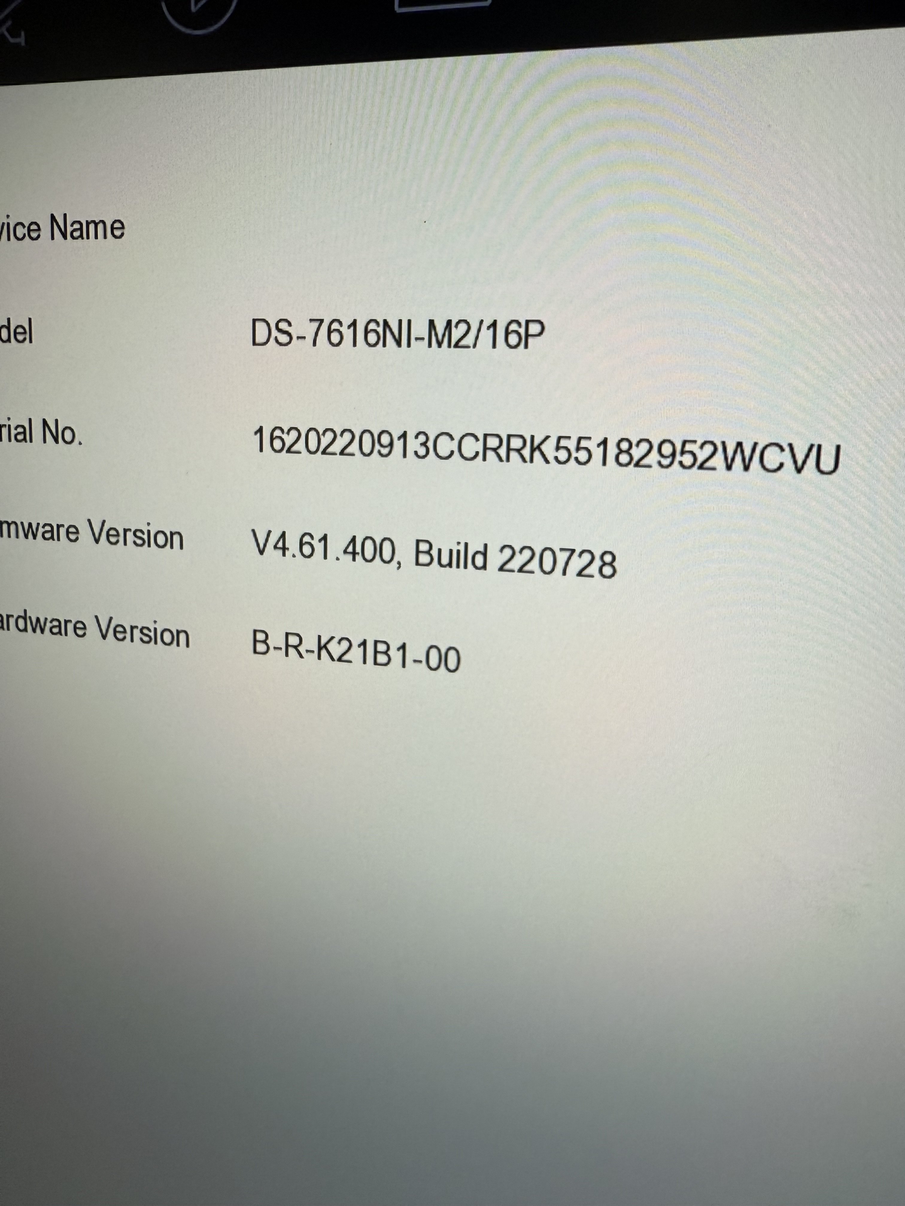

Hi guys. I ordered this system off use ip in November 2022. And haven’t updated anything manually.
It seems very slow at the min at catching movement and my hikconnect app is slow like takes ages to load only as of a few weeks ago.
Pic attached of the models of devices. I did go on the nvr and check for updates but it says it’s up to date. I have automatic updates on….. Assume there maybe other ways to update it via usb?

Hi @Kilojade
Your NVR firmware is several versions behind.
One of those newer versions is the major V5 firmware, which significantly changes the NVR's user interface. Below are firmware versions we would recommend updating to in steps (e.g., one update at a time - do NOT update straight to the latest version).
V4.63.006
V5.03.000
V5.04.020 (find under Resources > Firmware)
For the cameras, the latest firmware is V5.7.19_241207 which you can update straight to.
Unfortunately both of those latest firmwares have fairly major issues.
NVR 5.04.020. No motion detection indicators in playback timeline. No motion detector indicators in Hik-Connect (filter returns no results). There are other issues but those are two that will make it difficult to search and find events.
G5 Camera 5.7.19. Dual VCA doesn't work and so if you need to retrospectively perform a motion, intrusion, or line crossing search to find something that didn't trigger a preconfigured rule, the NVR will return no results.
With the above in mind I wouldn't recommend updating the NVR beyond 5.03.010 and the cameras beyond 5.7.15 to avoid the issues.

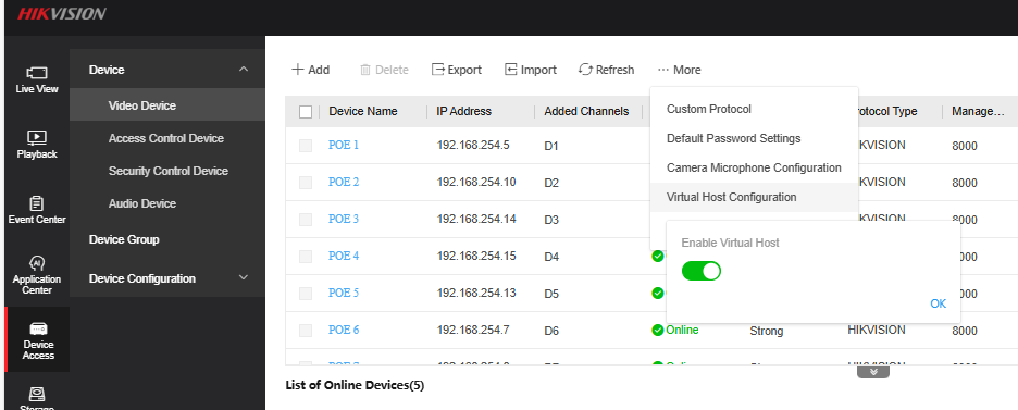

No USB stick needed. You just do the updates using a web browser navigating to the NVR IP address to do the NVR. For the cameras ensure you have 'Virtual Host' enabled in the NVR settings (Network > Advanced Settings) and then you can access the cameras either by the links on the Cameras page while logged into the NVR or by adding :65001 on teh end of the NVR IP for cam 1, :65002 for cam 2 etc. Plenty of guides on this forum.

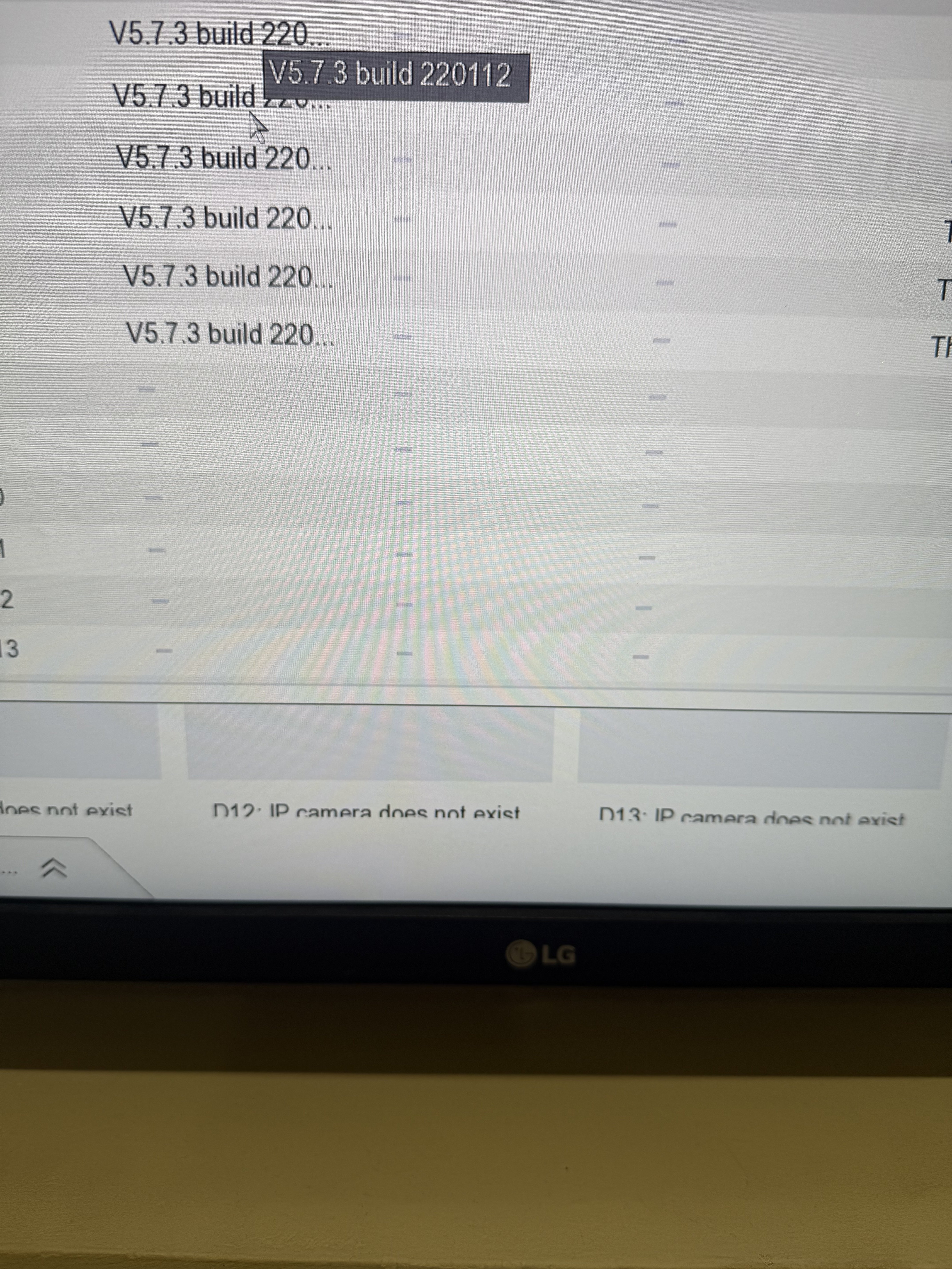

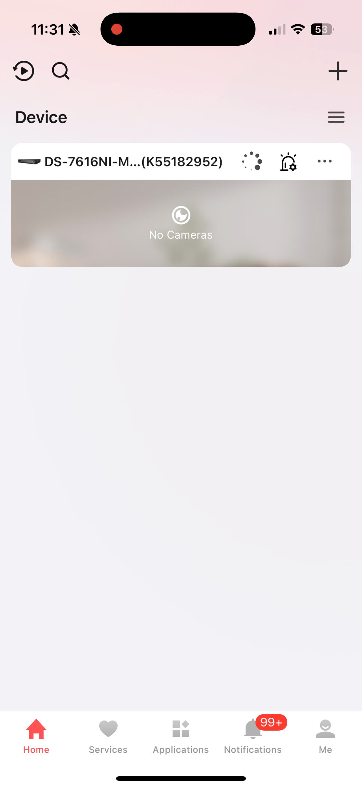

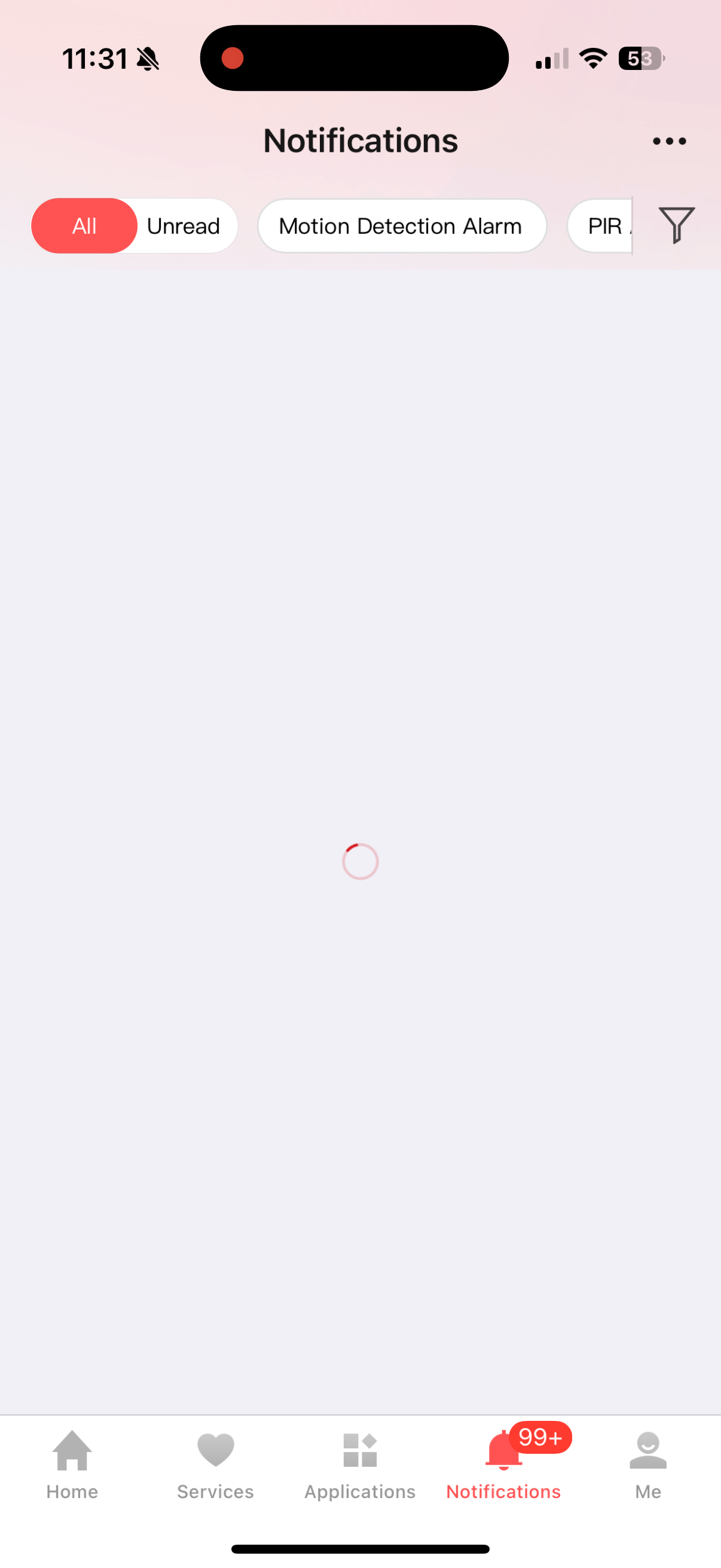

Thanks for all help guys. Massive help! I did it all updates :) Still trying ti figure out what’s wrong with the connect app. These 2 pages attached they just load for about 10 seconds before they come on. But this only started as of a few weeks ago nothing has been unplugged or changed from WiFi area for months. These nvr is plugged direct into the nvr via lan. We have good speed broadband. I replaced the lan cable just incase but no difference. Strange… I may try deleting the app and logging in via qr code on the new system see if that works
Where it says no cameras there is it just takes 10 seconds to load them

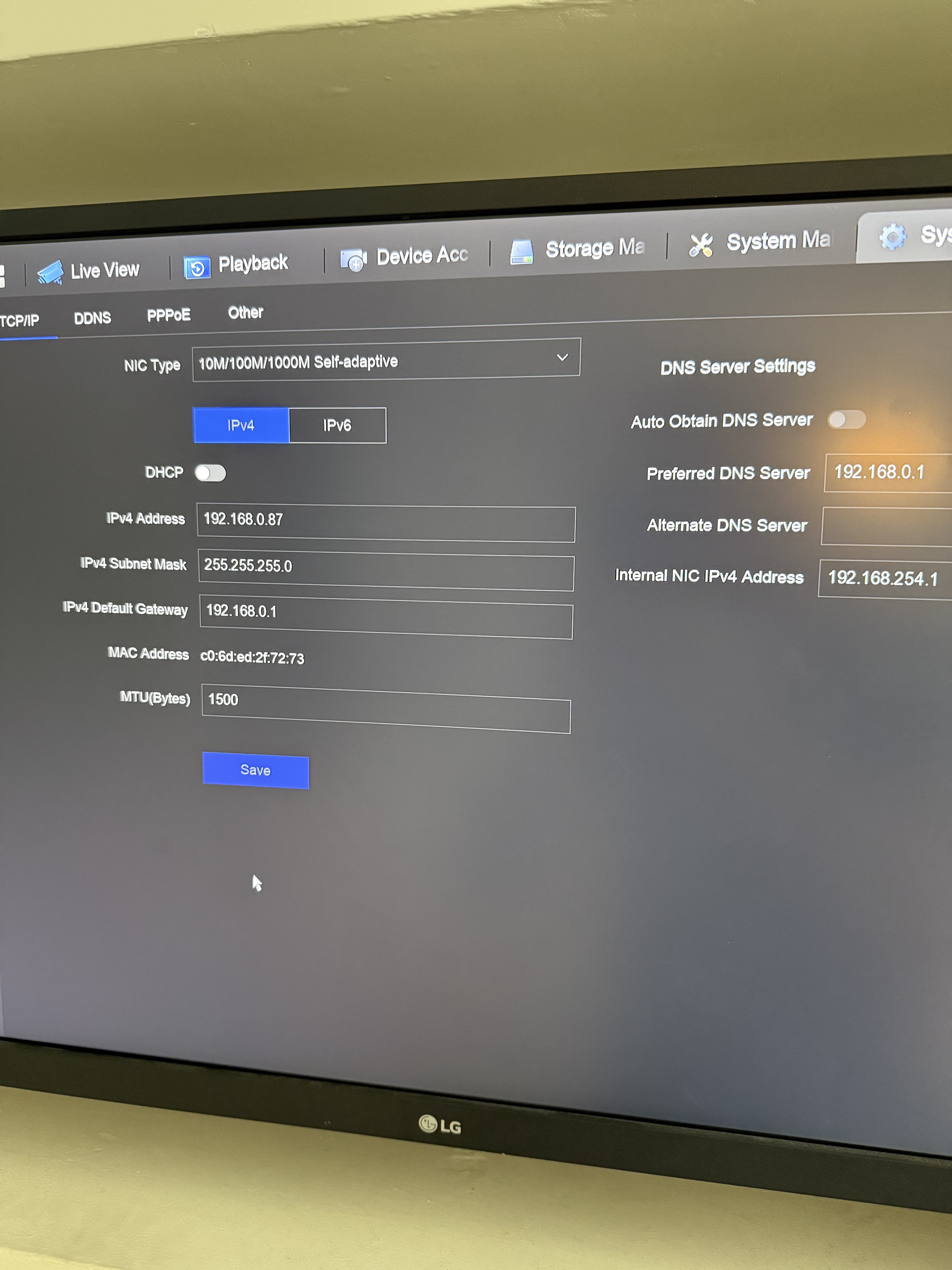

Show the Network Settings page from the NVR
What is the setup of your network? Do you have a single router with the NVR connected to it directly or does it connect via a network switch. Are there any other routers or just what was provided by your ISP?

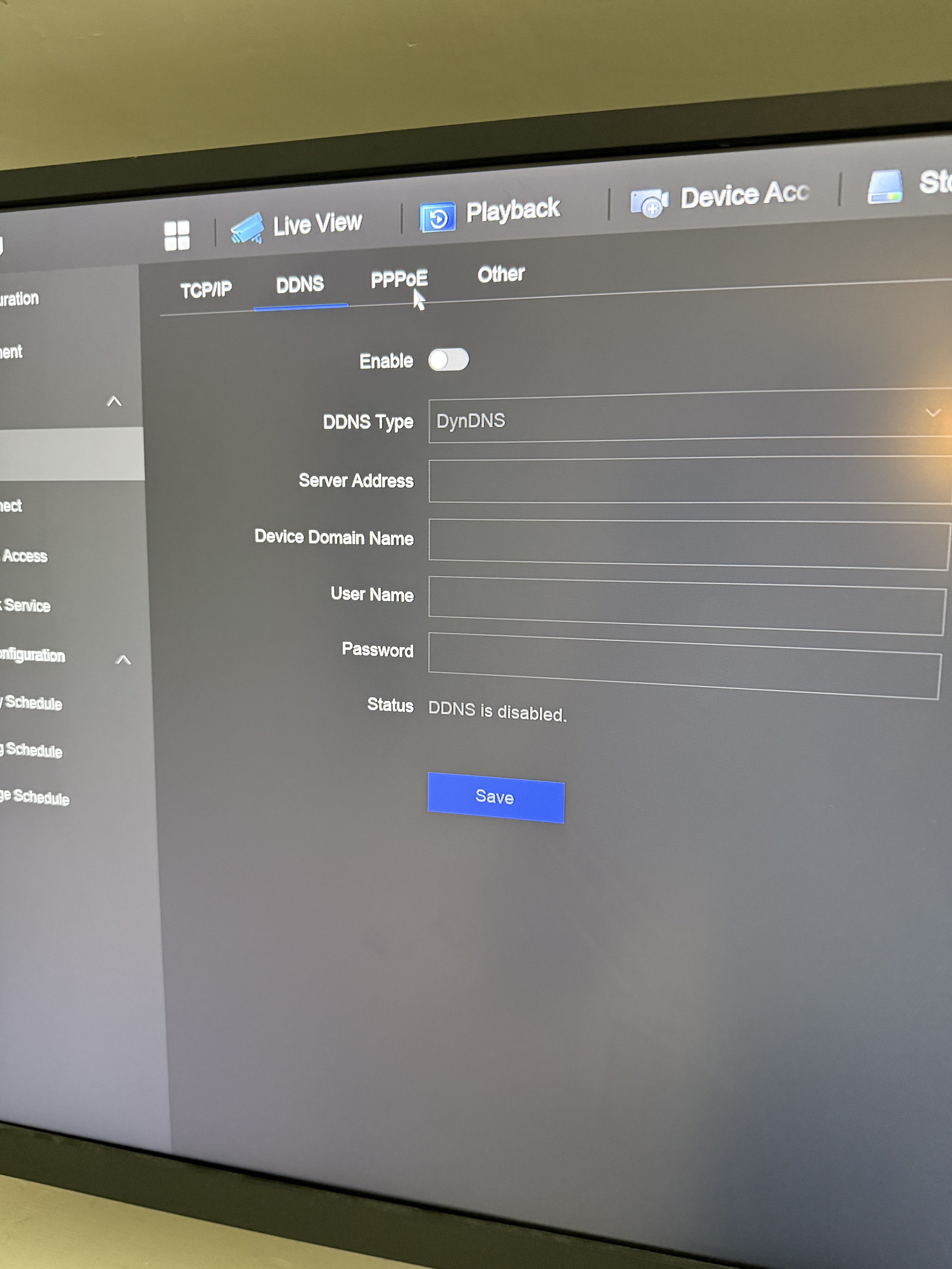

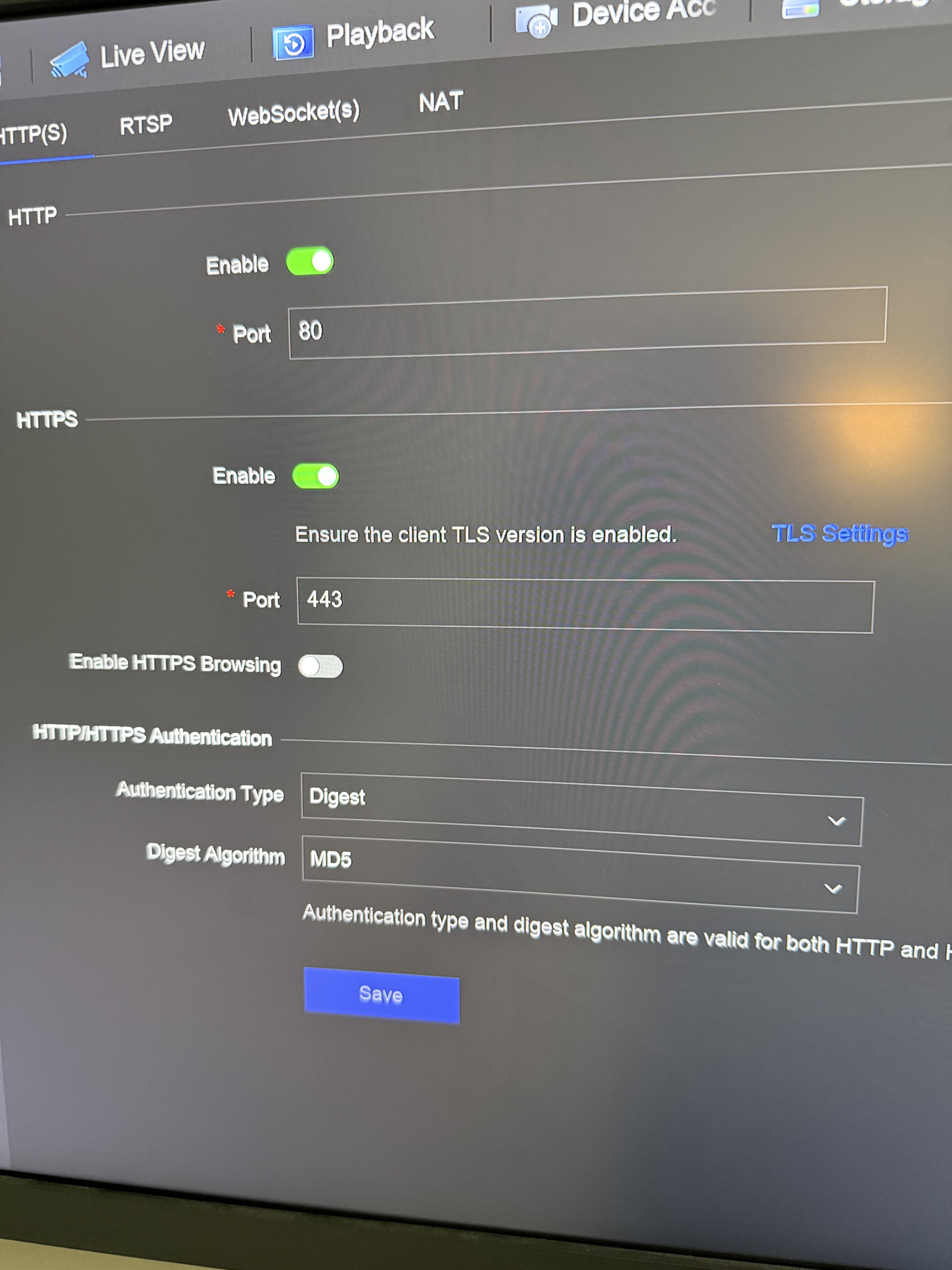

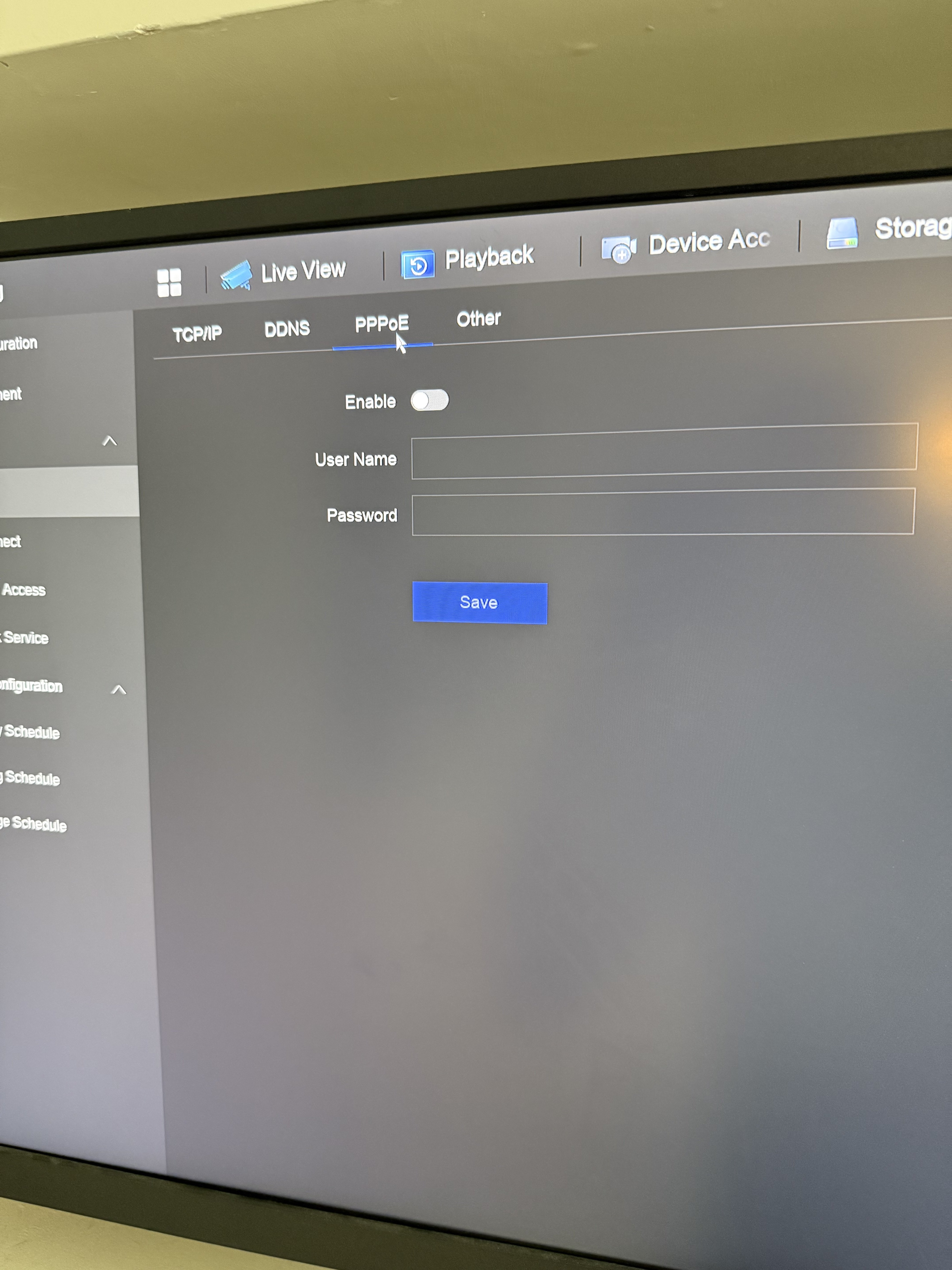

Hi mate…: Single sky hub max router with pod boosters… it’s plugged directly into the router. As the router is on a different shelf just 10” away. No other routers. Haven’t ever changed setting for nothing so can’t see it being a setting. Attached pics?
Pics

Change the DNS server to 8.8.8.8 and the second DNS server to 1.1.1.1
Hik-Connect works best when using a public DNS server (8.8.8.8 is Google's, 1.1.1.1 is Cloudflares's). Setting it to 192.168.0.1 forwards DNS requests via your Sky Hub, which in turn will use whatever DNS server that Sky uses.
