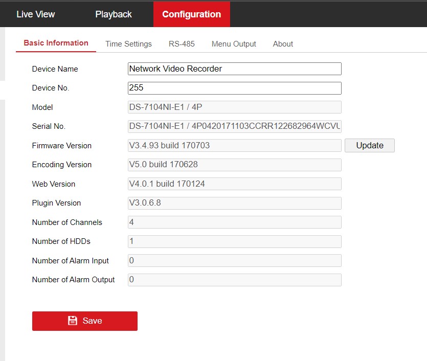

What firmware is on the NVR?
Hello, I will attach file with settings from the Web GUI:
PS: I also tried to change the internal NIC Address IPv4 to be on same subnet as 10.8.150.X but it gives an error message.
This clearly cannot be changed, and cameras can only be accessed through Virtual Host feature.
