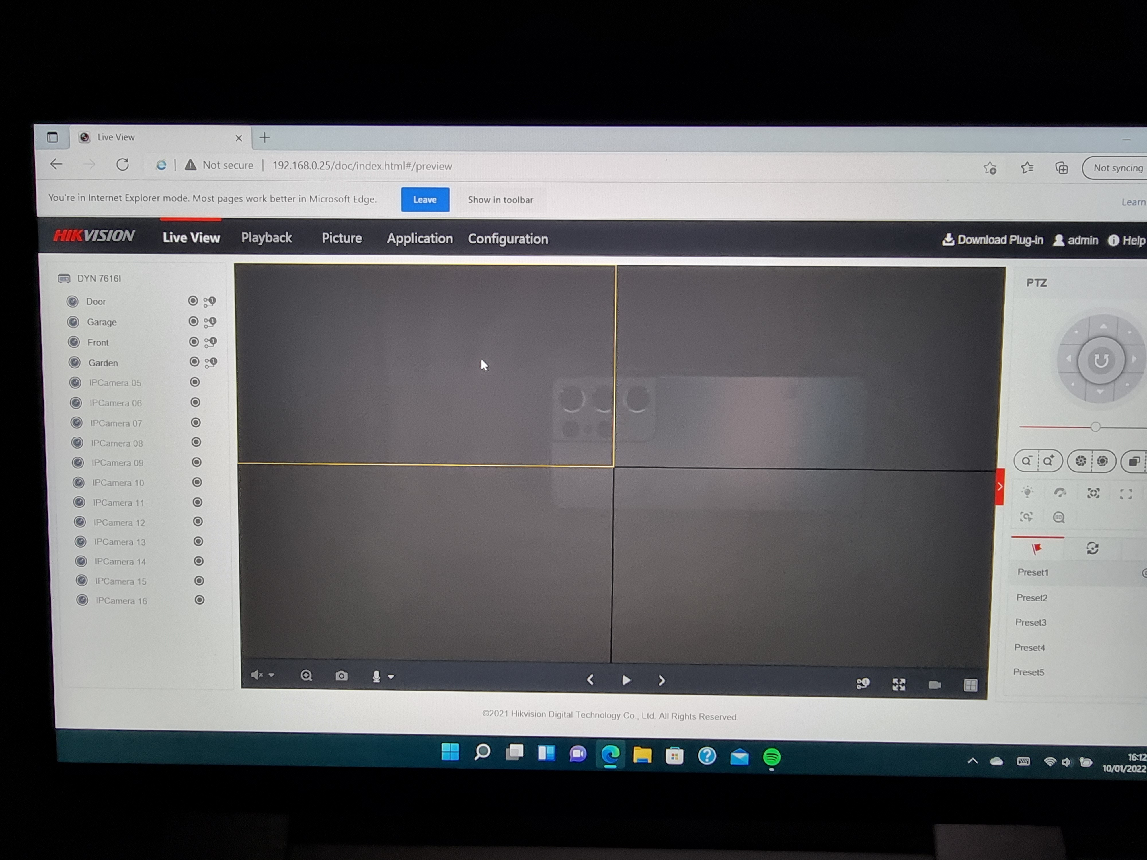

When logging into the NVR from my laptop I can't view the live images, there is just 4 grey boxes, not sure how to get the 4 cameras to show on there.

I'm now on Internet Explorer but still can't see the cameras

Ok, just to check the basics before we go anywhere else, have you tried clicking the play icon in the bottom centre of the screen? If that doesn't work have you tried clicking the little lens icon to the left of each device in the device list on the left of the screen? you should see a green play symbol next to each device when you do this.

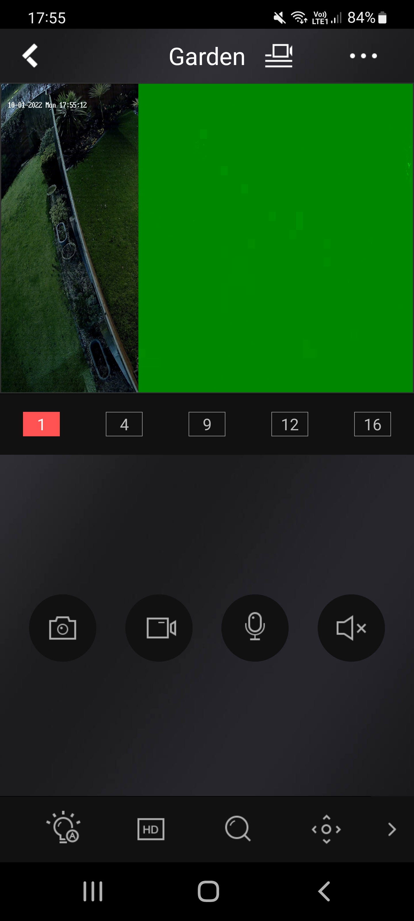

I updated the firmware on the NVR to the latest and now when I try to view one of the cameras in HD on the Hik-Connect app it's half green but it's fine in basic mode, it was working fine earlier

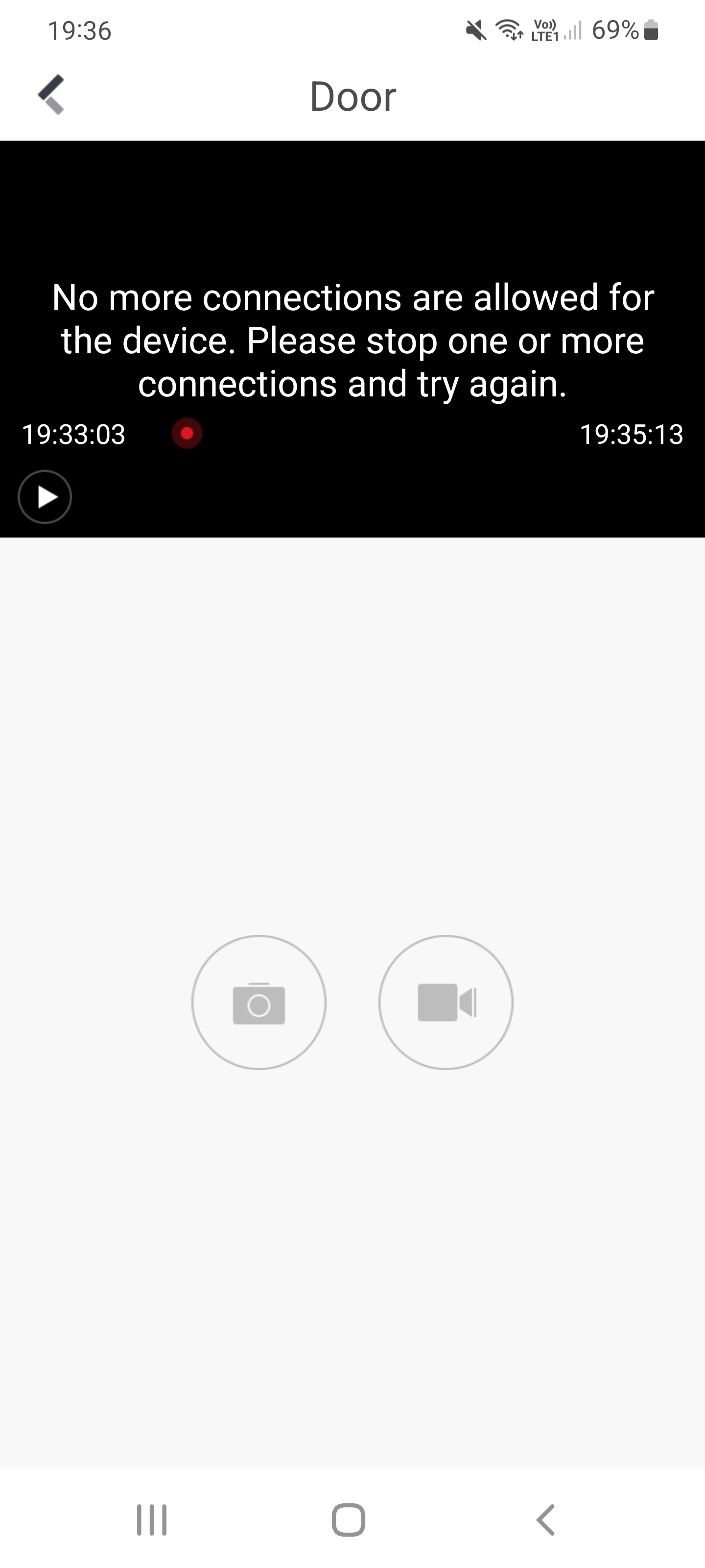

Also now unable to play footage back on all cameras

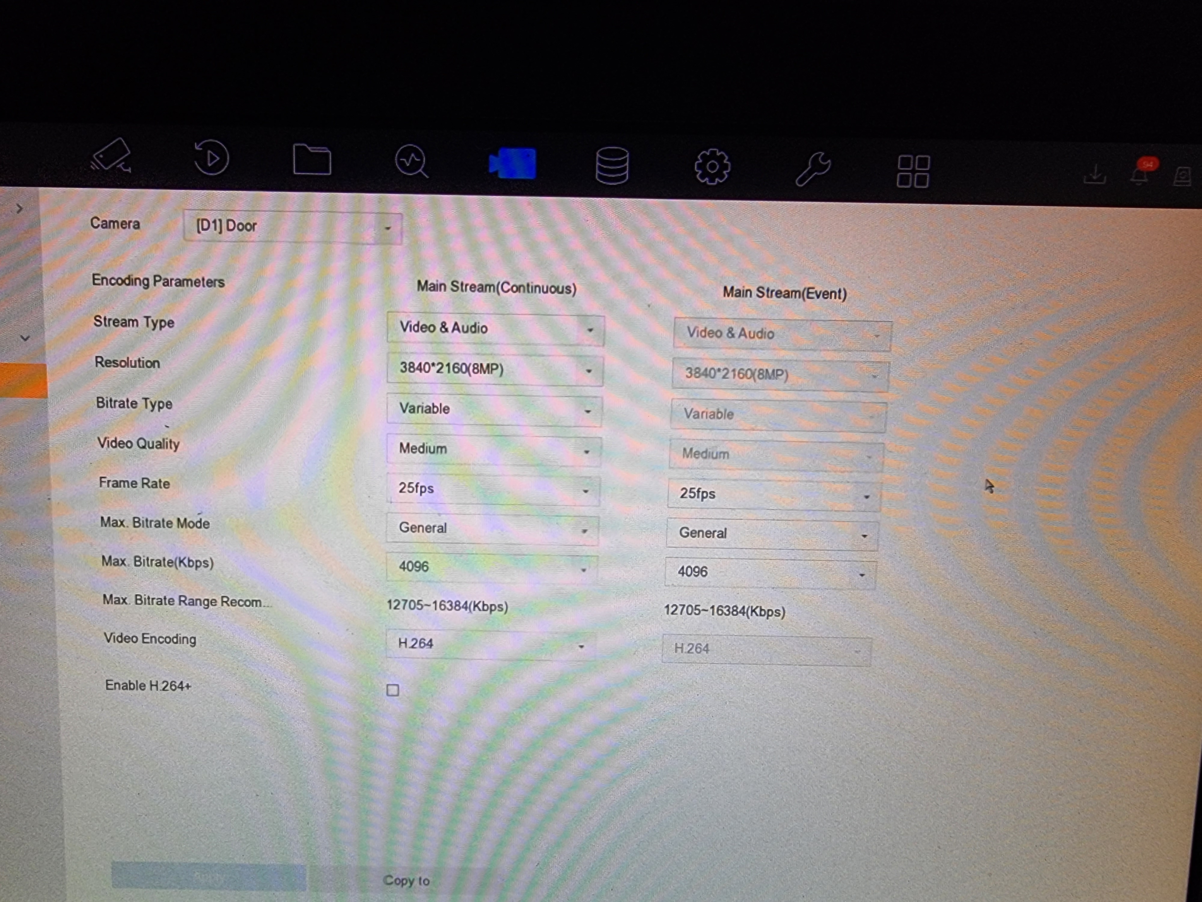

What are the video settings of this camera? Can you share a screenshot/photo of the video settings for this camera from the NVR menus?
Update - all the cameras were set to constant bitrate of 16384 and were all loading very slowly and struggling to play footage back.
I've changed the bitrate to variable with a max of 4096 on each camera and I can now view recordings back and live view is loading quicker.
Was this the right thing to do?
Yes, I was going to suggest that you compress the video settings by either reducing the bitrate, reducing fps, increasing compression, or a mix of those options.
Glad to hear the remote access has improved.
I also changed all the cameras from H265 to H264 that seemed to improve the speed.

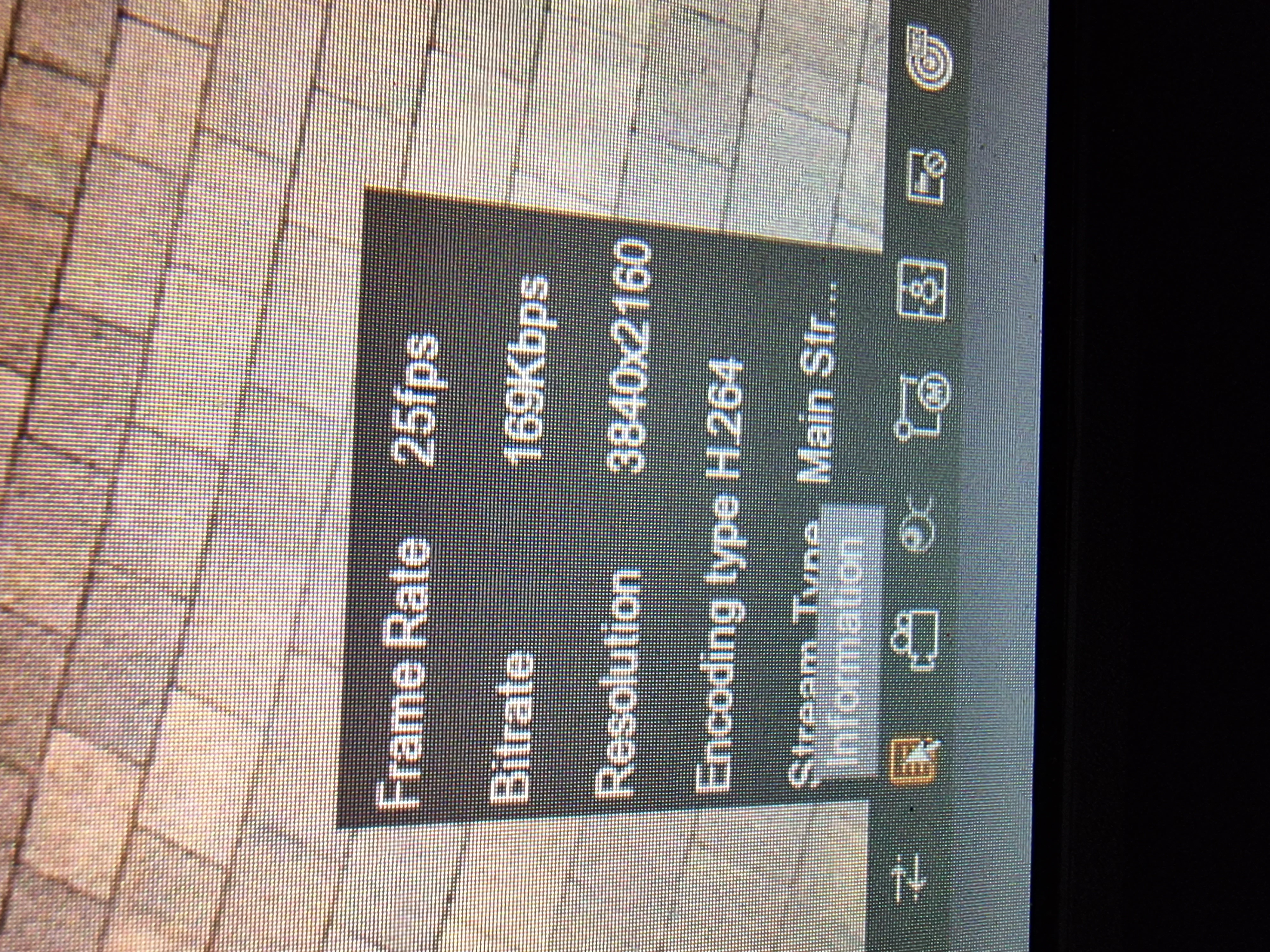

This is the main most used camera settings
As soon as I raise the bitrate to over 3072 or change to H.265 I hit problems
