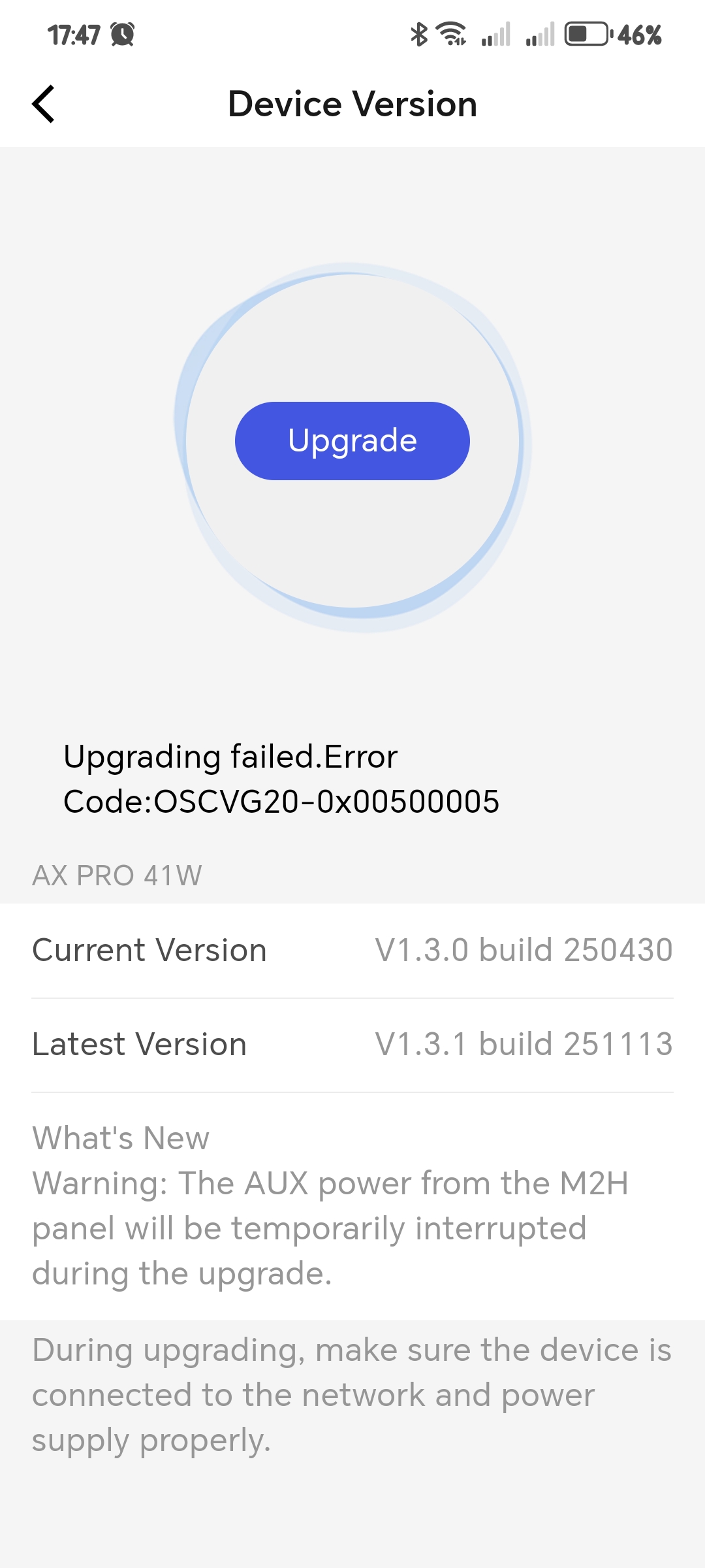

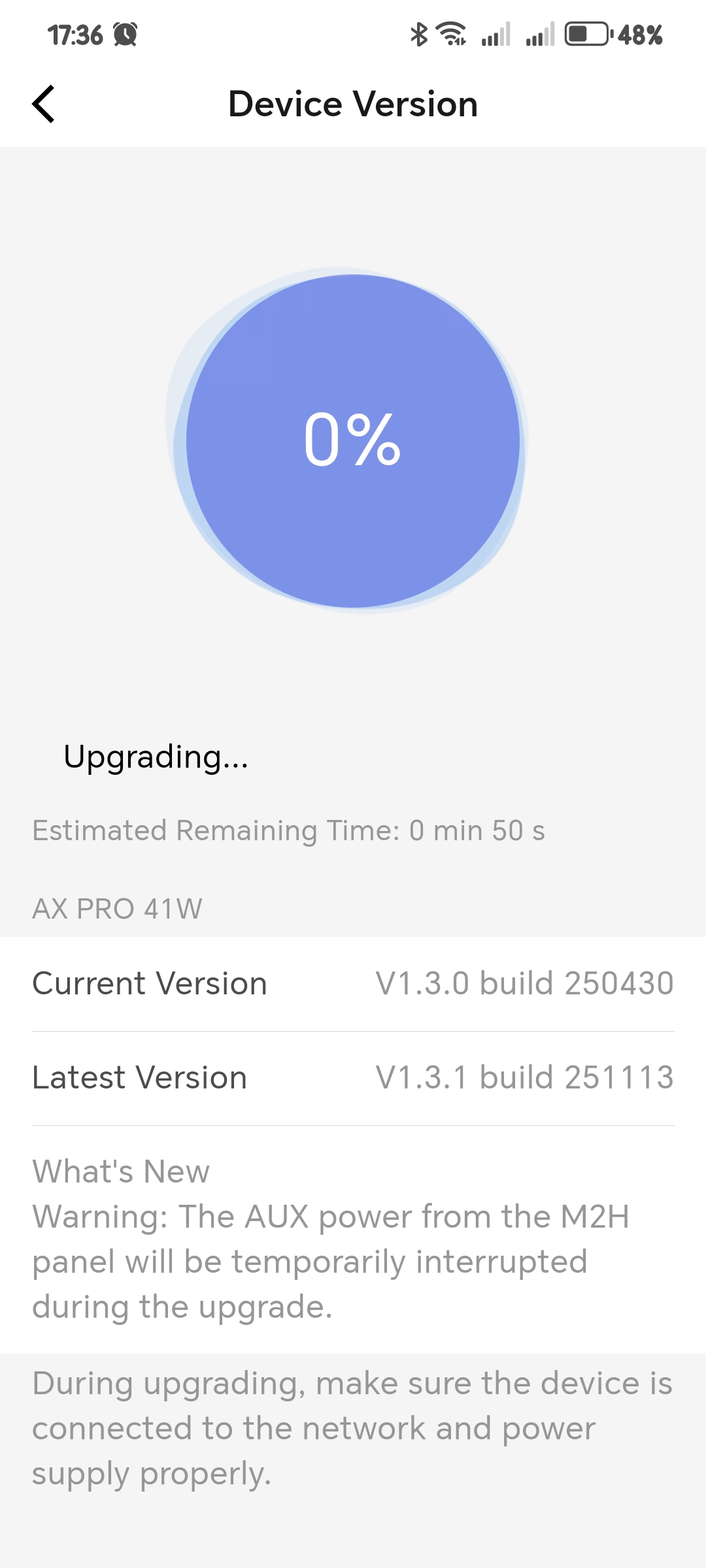

Just had prompt for AX Pro update....
V1.3.1....clicked upgrade.... Estimated 50 seconds, yeah.... 5 mins so far and still 0%....
Besides it not upgrading or even allowing a restartn(its upgrading apparently) any news on what's added.... Fixed....?
