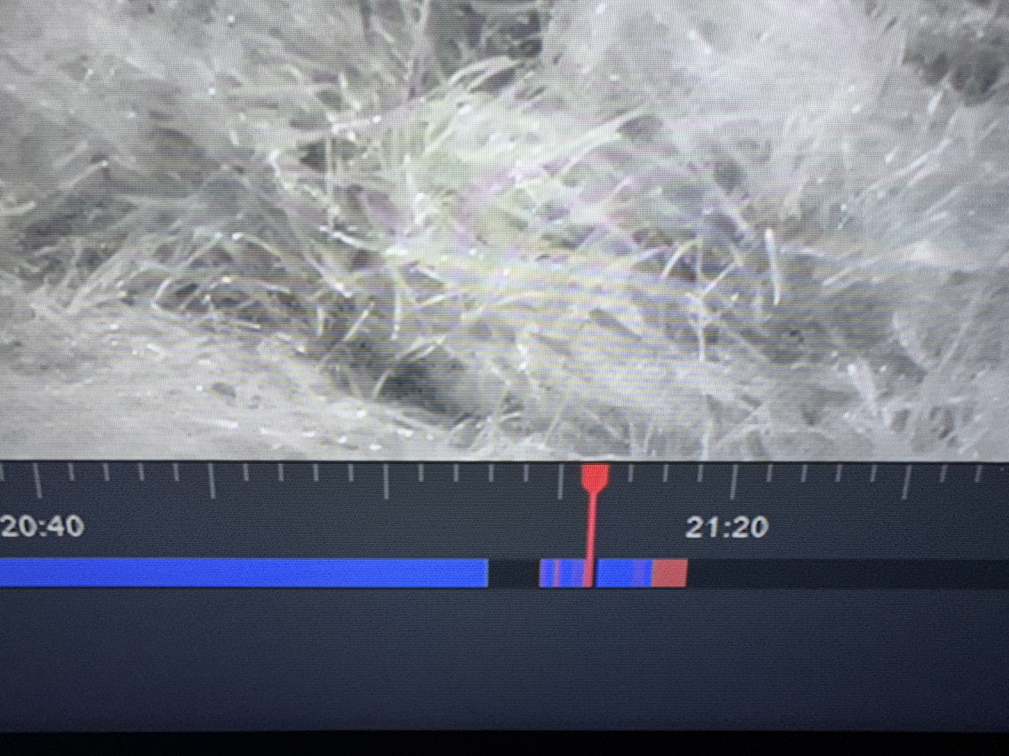

I'd never noticed the issue before but have read your detailed explanations @alfaclvi. So just to test I did the following on one of my DS-2CD2387G2H-LIU cameras connected to the DS-7616NI-M2/16P:
  • Existing firmware - 5.7.18_240826
  • Downgrade to 5.7.15_240411
  • Go to Playback > Normal Playback
  • Three dot menu > Dual VCA > Enable Motion Detection
  • Draw a grid and search.....
The photo below shows the results of that VCA search on the timeline first on 5.7.18, then the black space during reboot, followed by the time after downgrade to 5.7.15:
No results for the time on 5.7.18 and all motion found after downgrade to 5.7.15. So yes it's abundantly clear that on newer firmware the camera does not pass the VCA data to the NVR.

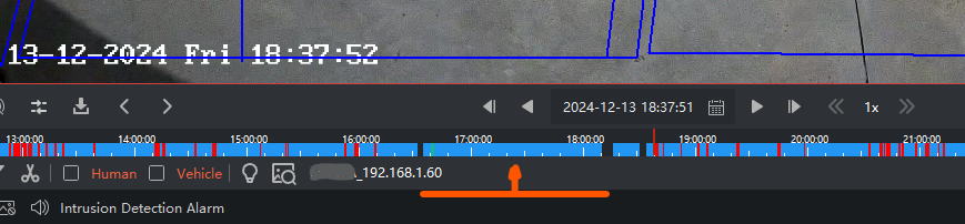

This is yesterday search by rules Motion on iVMS4200. Between 16:30 and 18:10 is the v5.7.18. The rest is v5.7.15

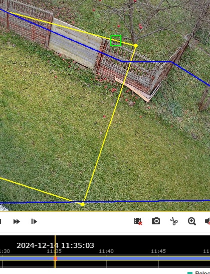

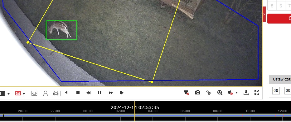

I do not understand. Fallow Deer was not marked, squirrel has been marked hmm

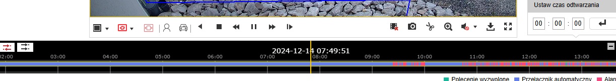

A road where cars are constantly driving, sometimes the traffic is detected, sometimes it isn't.
