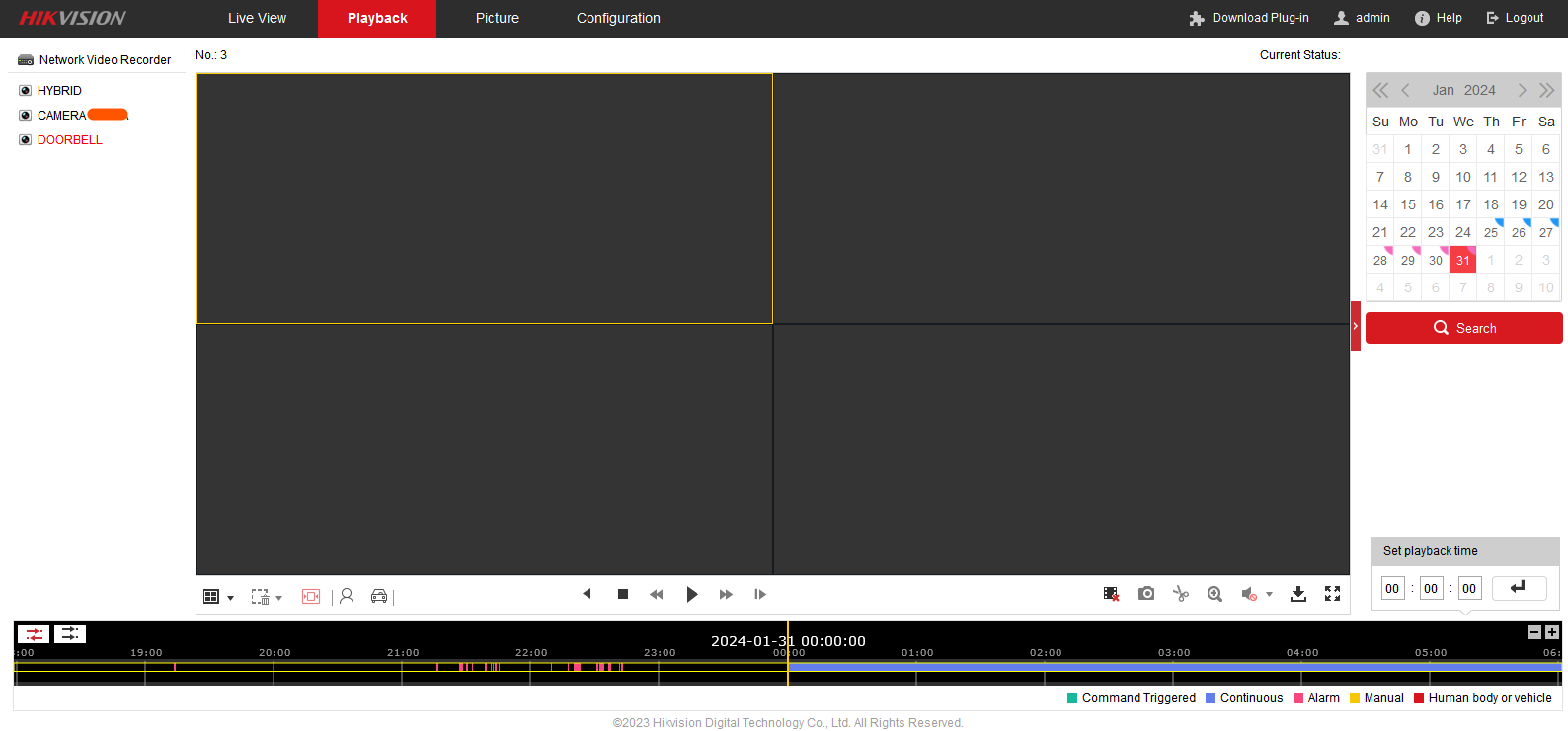

Continuous Recording for two ColorVu (G5 plarform) and one DS-KV6113WPE1 (Event recording at day time, Continuous at night)
NVR Playback - Using Edge, Firefox or Chrome Web UI
a) "Person" and "Vehicle" not selected:
Motion Detection, Intrusion Detection, Line Crossing Detection markers missing after Search
b) "Person" and "Vehicle" selected:
"Person" and "Vehicle" markers appear
c) iVMS, Camera Playback, has exactly the same behaviour
but also has the option to Event Playback, Motion or Smart (VCA?) which is Ok
d) KV6113 doorbell has the same problem when continuous Recorded(night), but does not have this problem when only Event Recording(day). All markers, non H/V Events, Human and Vehicle are visible when only Event recording.

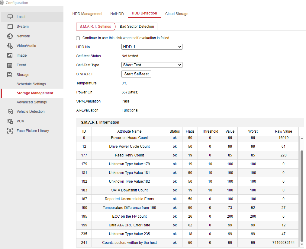

Could this specific problem, that I see, concerns only me and few others since this is not a very popular NVR, be due to installed SSDs instead of compatible HDDs?
I would think it unlikely that using SSDs instead of standard HDDs would cause a problem, but there's only one way to be sure ...
