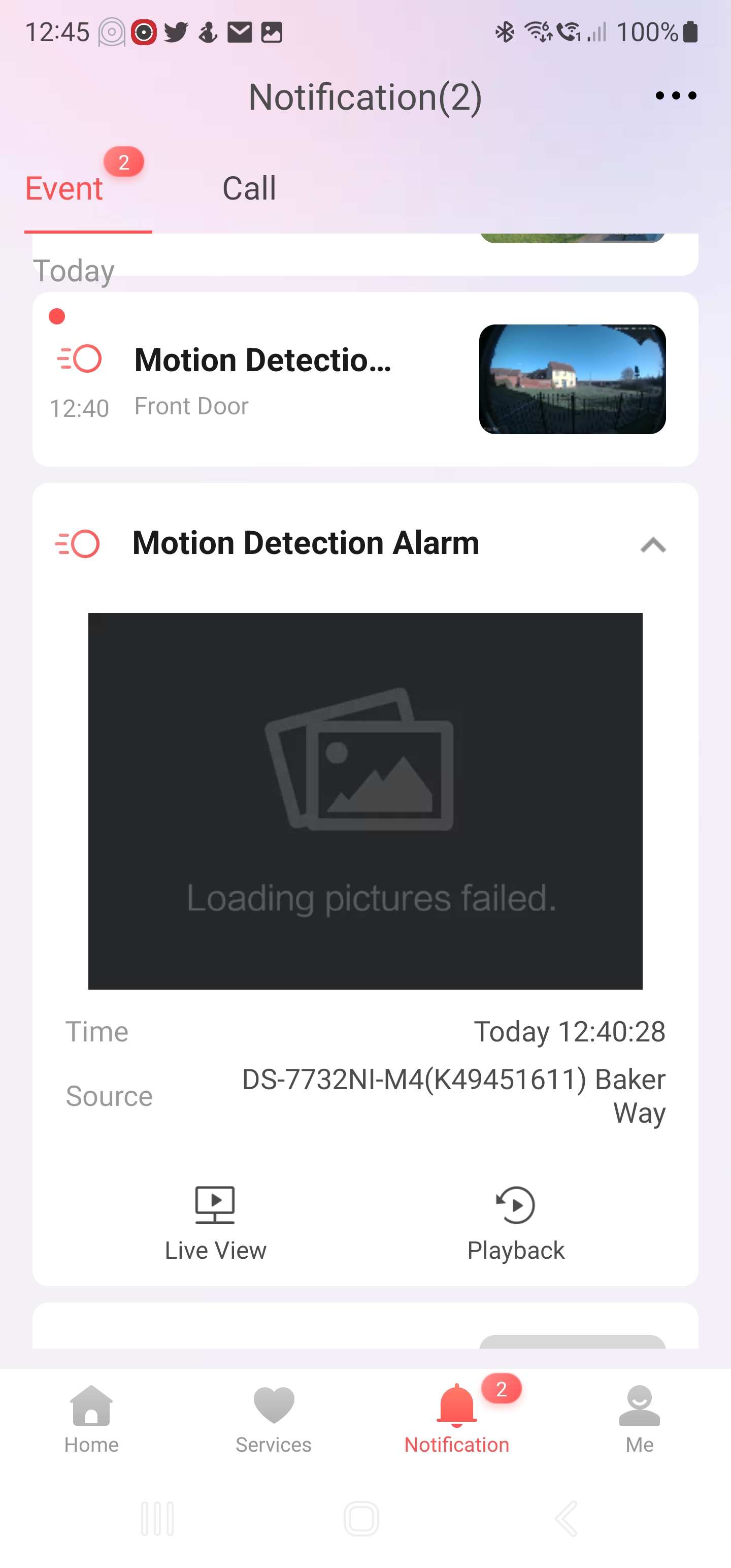

The only issue i seem to have at the moment is that with my 8mp colorvu cameras, I am not getting screen shots sent to my Hikconnect. I just get a message saying loading pictures failed. The intercoms and a Dahua camera I have attached I receive everything as expected. In the past its been a firmware issue, but to have some working and some not, its a little odd. I am only getting the options for Net fault tolerance and Multi address. Nothing for load balance, unless it no longer comes with it.

strange then, not sure what could be causing this issue. I have copied my settings like for like from my old NVR today but it seems its only these 8mp cameras with the issue I mentioned. I will have to dig a bit deeper
Actual video footage is fine. It seems to be the preview pictures within the Hikconnect app

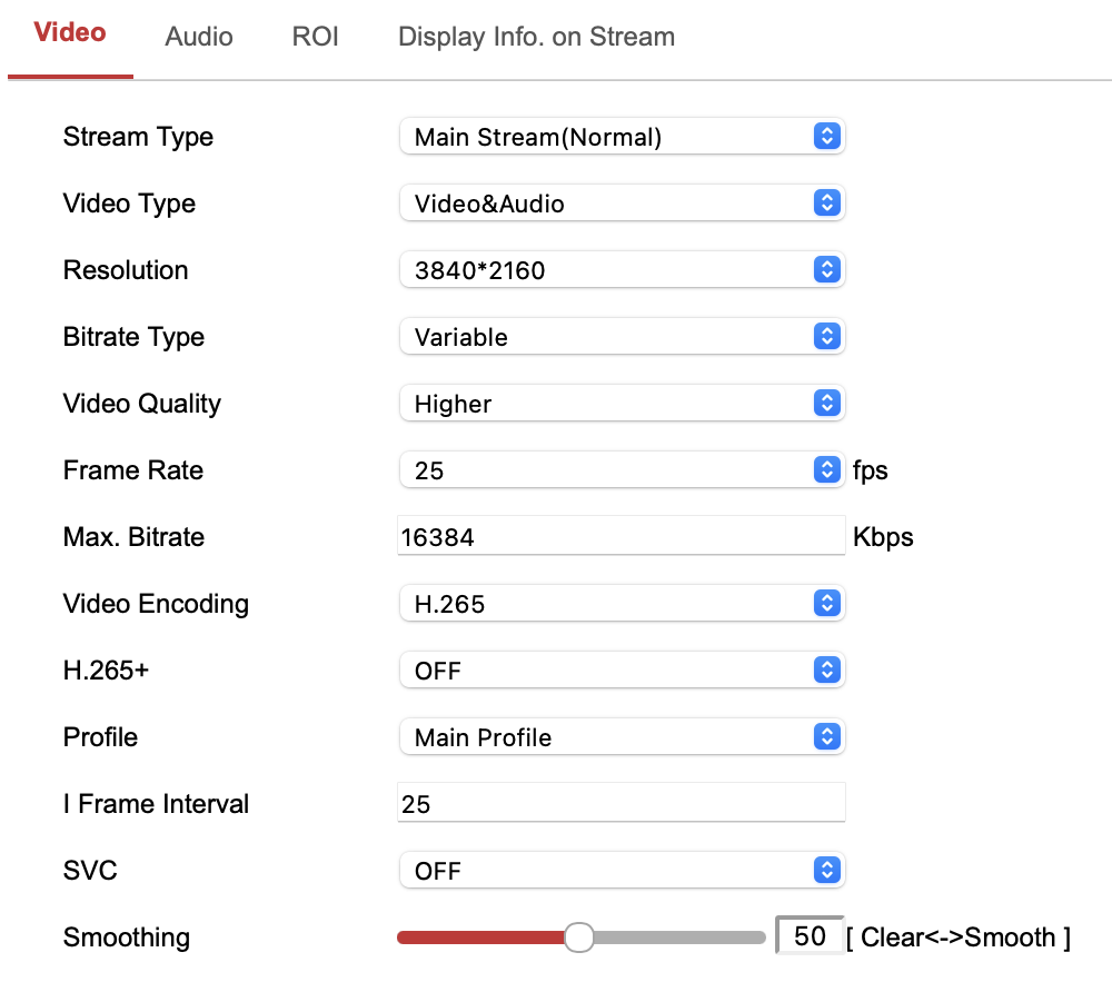

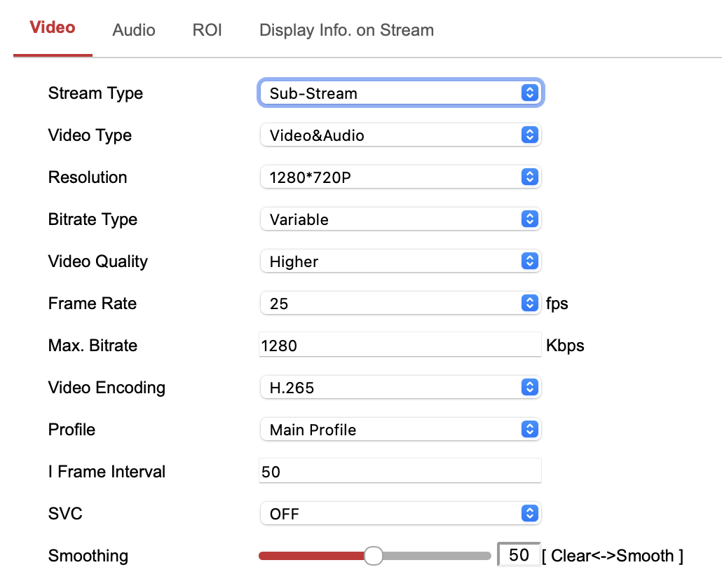

Anyway, I was wondering if you could share the settings for the main and sub streams you are using for your Colorvu cameras at all. I have 4 of the DS-2CD2387G2-LU and I am just trying to get a better idea of what might be the problem here. I am using the Hikvision bitrate sheet as a guide. Thank you in advance
Sure. When I switched across from the I series to the M series I deliberately hiked up the bit rates as I wanted to see whether the recorder could cope. For my 2387's they're as shown in the pics. 720P probably unnecessary for the sub stream but I use it, as I have that image on my tablet dashboards where I need a clearer image.

Where specifically in the Hik-Connect app are you not seeing the previews? Is this when you click on a thumbnail image in a notification?

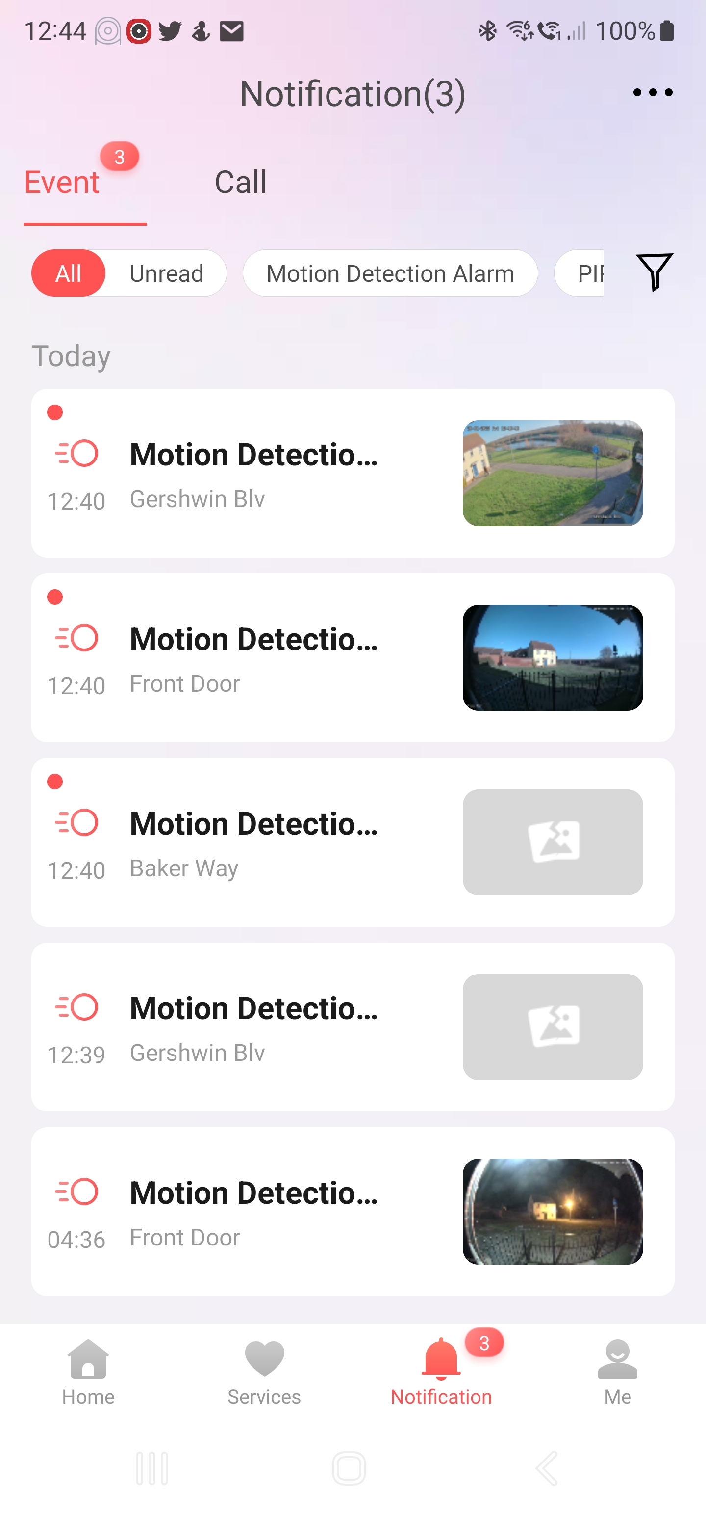

Thank you very much. I have not tried your settings just yet but will give it a try shortly. Currently mine are lower, than yours. But will give it a go. Footage is perfect, just hit and miss on the previews. And as you can see in one screen shot, sometimes they will work and others they dont. One particuar camera was doing that. I have fully reset the system to factory and started a fresh install. I know in the past experience I have seen some bugs which a factory reset has cured. So hopefully I have attached the screen shots correctly.
Thank you very much. I have not tried your settings just yet but will give it a try shortly. Currently mine are lower, than yours. But will give it a go. Footage is perfect, just hit and miss on the previews. And as you can see in one screen shot, sometimes they will work and others they dont. One particuar camera was doing that. I have fully reset the system to factory and started a fresh install. I know in the past experience I have seen some bugs which a factory reset has cured. So hopefully I have attached the screen shots correctly.View attachment 8706View attachment 8708
My gut feeling is that your issue is more related to your HikConnect connection in that the app is not pulling the preview from the HikConnect server.
I have a simular feeling. Although when I revert back to the old NVR with the same settings it does seem to work ok. I shall do a bit more digging. Thank you for that info. The actual live view and footage is excellent.
